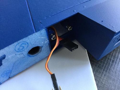

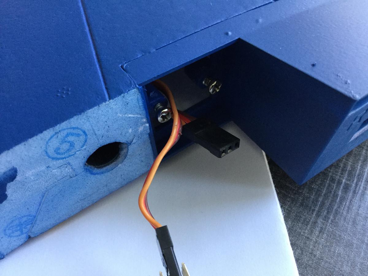

ID:	213940 Hi guys, give you a short summary of my day and am a bit disappointed. Hooked up my FA-18 for the first time to check all the electronic parts and all worked fine so far. Then I simulated an approach to land selected gear down, full flaps and at the same time added inputs on all three axes, when all of a sudden the ail servos started a jitterbug for about 10sec, then stopped working.
        I hooked up the a/c a second time, but no changes. Checked the servos through the MCBE, but didnˋt work at all. Disassembled the wing connector board and checked them directly, and found out, right one is dead, the left one still alive. So MCBE and right ail servo kind of burned through. While doing this I realized, that the servo lead of the right flap servo is also damaged.
        Now I am wondering, if this MCBE is too weak to cope with such a load, which is quite normal for an approach.
        Not too lucky with this result

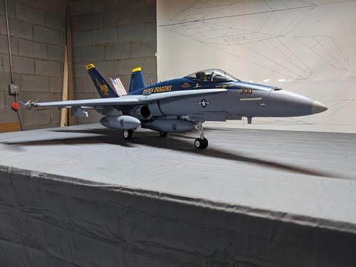

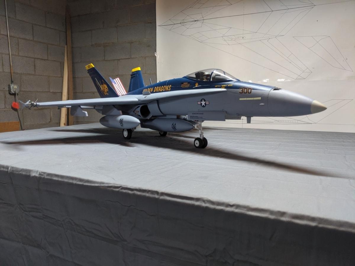

                                I have flown the plane at Jolly Good. Could not try the speed brake because of an issue with the steering servo. Will have it at Nall in the Fall.
