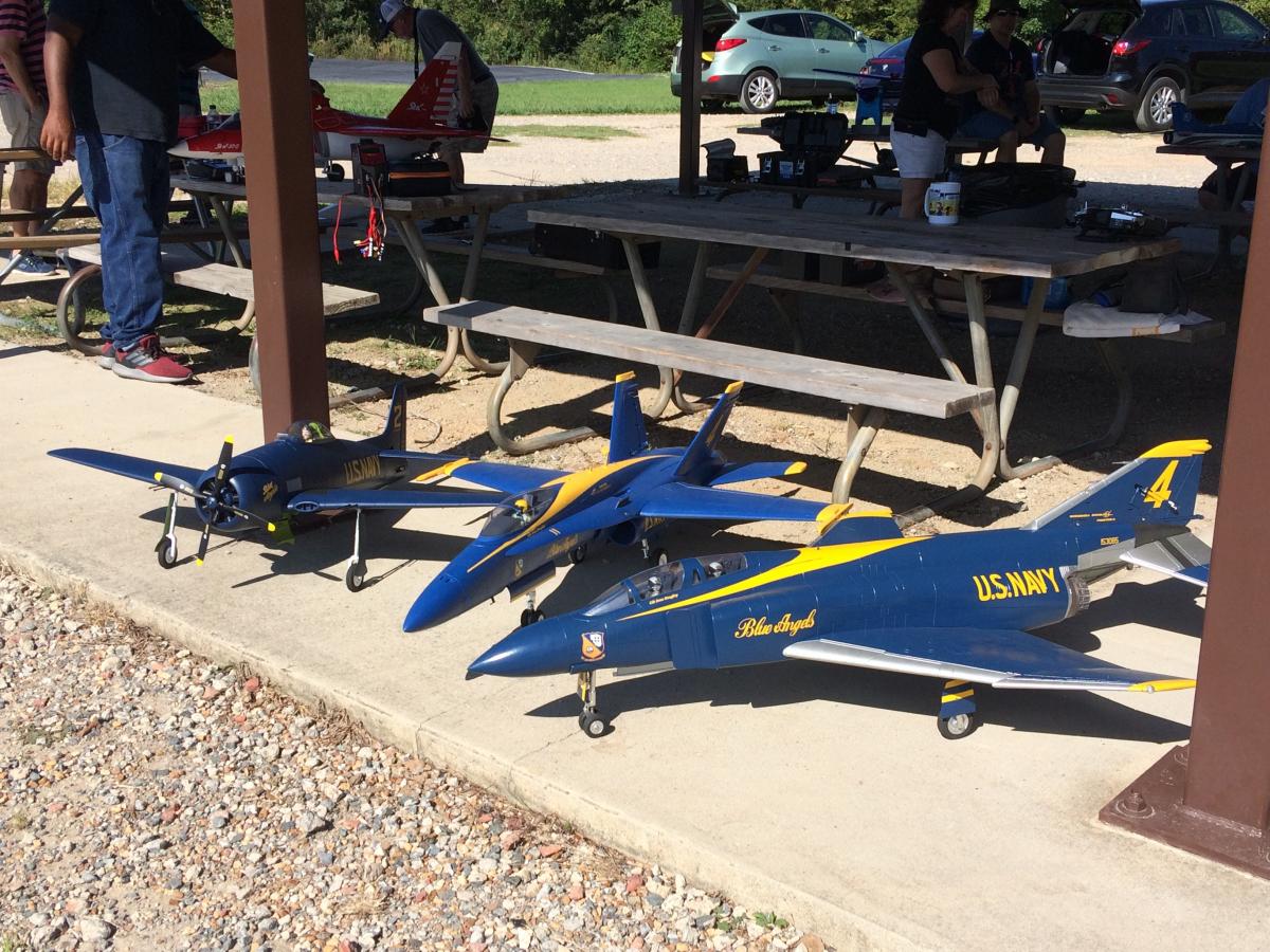

                            #2973
ID:	212301 Blue Angel day today.

                              #2974
                              You need a BA A-4 to round out that fleet!

                                #2975
                                Yes I do!
