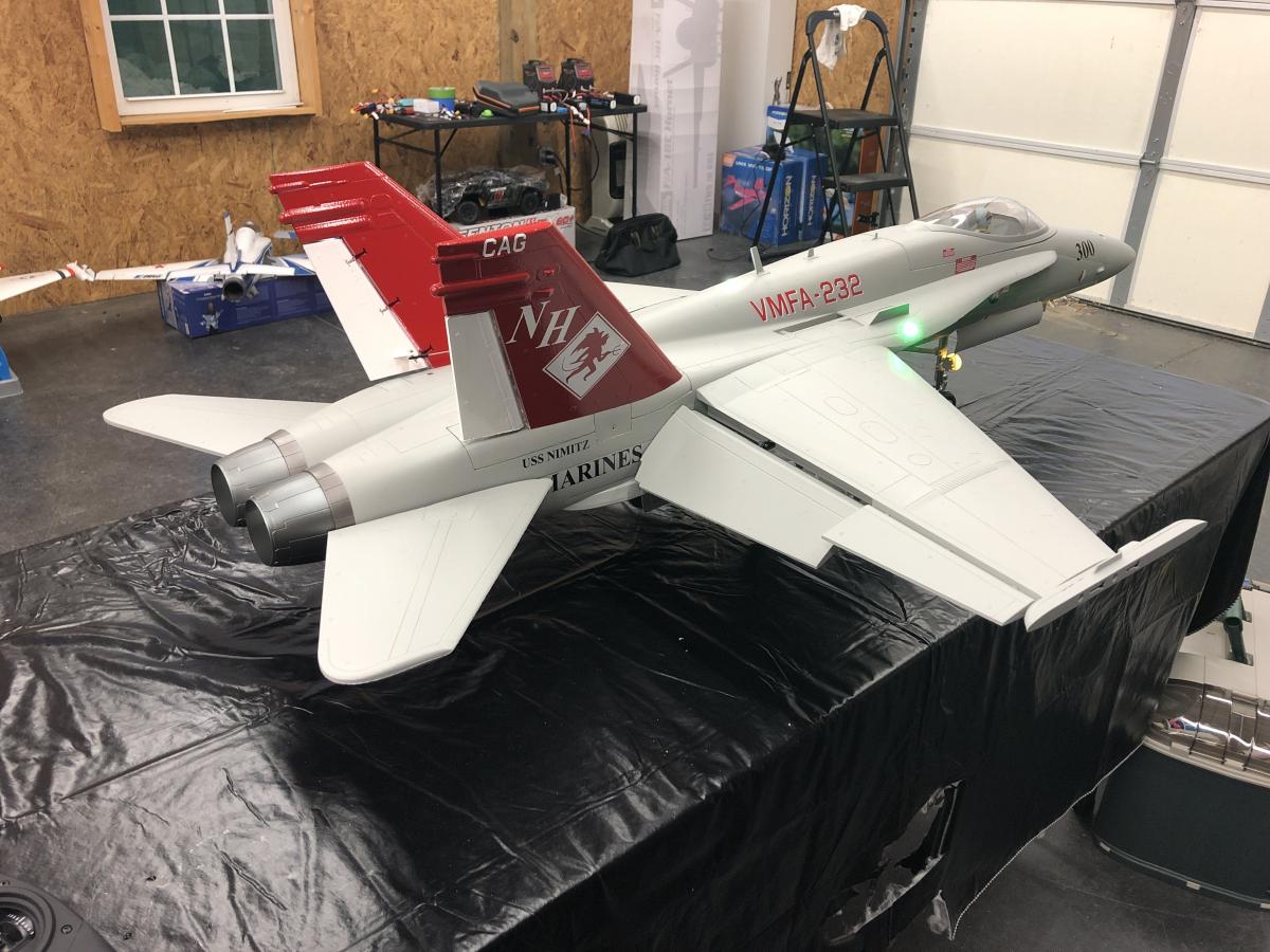

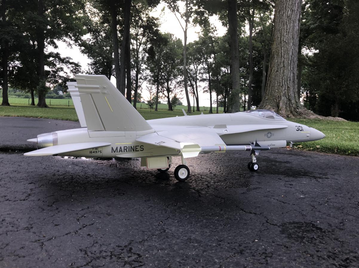

ID:	200785 Finally finished today!

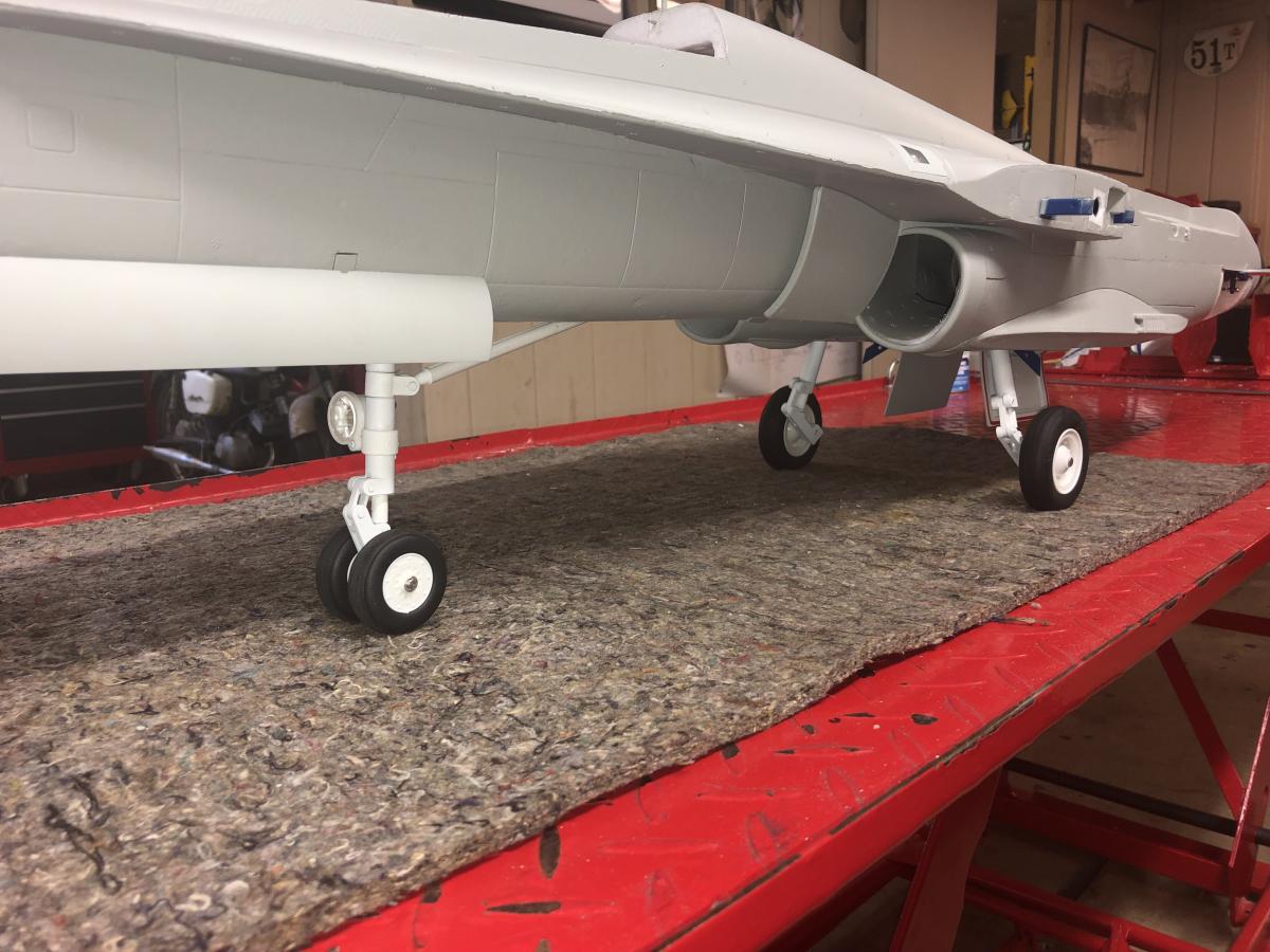

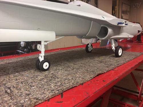

        That looks cool Dustin! Was able to get started on mine this afternoon. Got the landing gear and inner gear doors painted, then couldn't resist throwing a few decals on. Lots still to do.

          Awesome! Thank you for the kind words.
          i assume you just painted the inner door gray and left the mechanism blue?

            Painted the inner doors white, along with the landing gear. I left that blue piece of mechanism alone. Looks like something I could break taking it off and trying to put back on. The doors and the gear came off without much difficulty.

              Beautiful!.
              I really like the the landing gear...may have to do that now...sigh, another project haha.
