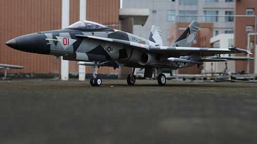

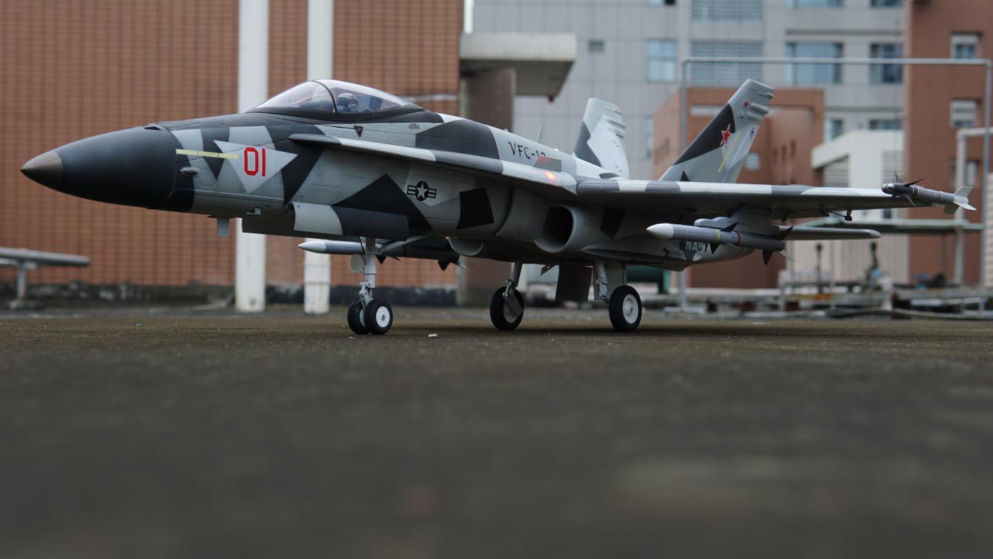

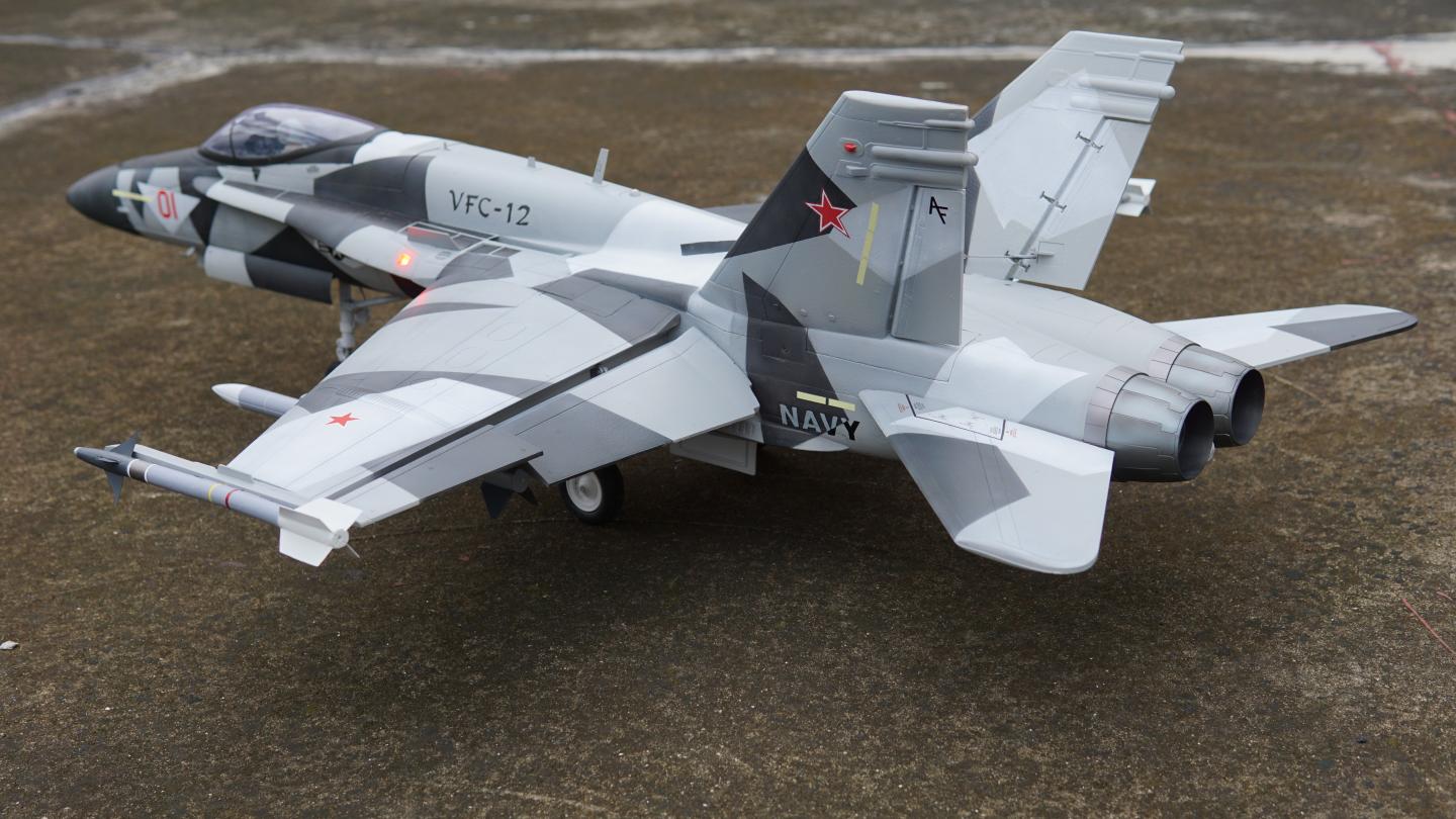

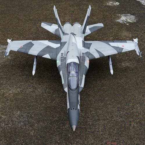

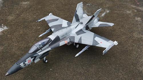

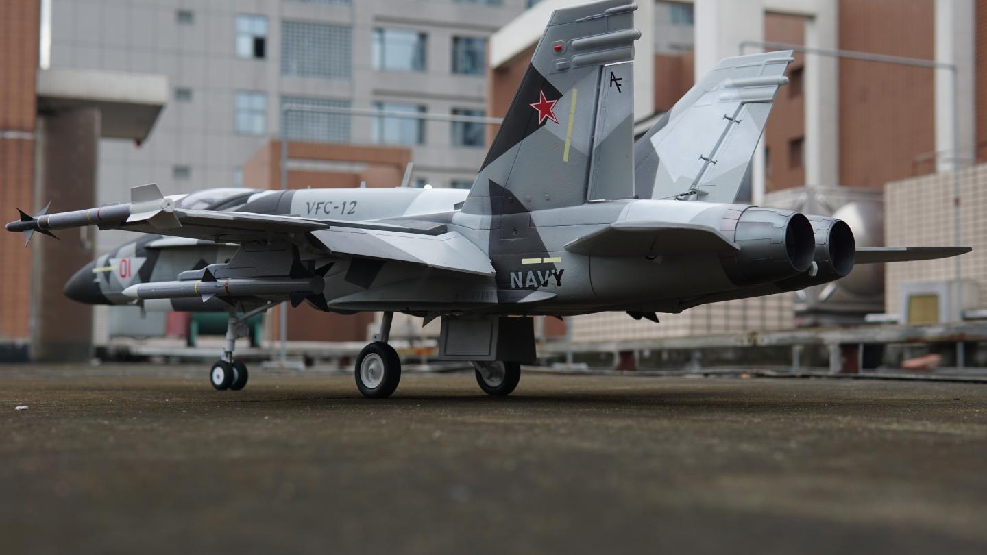

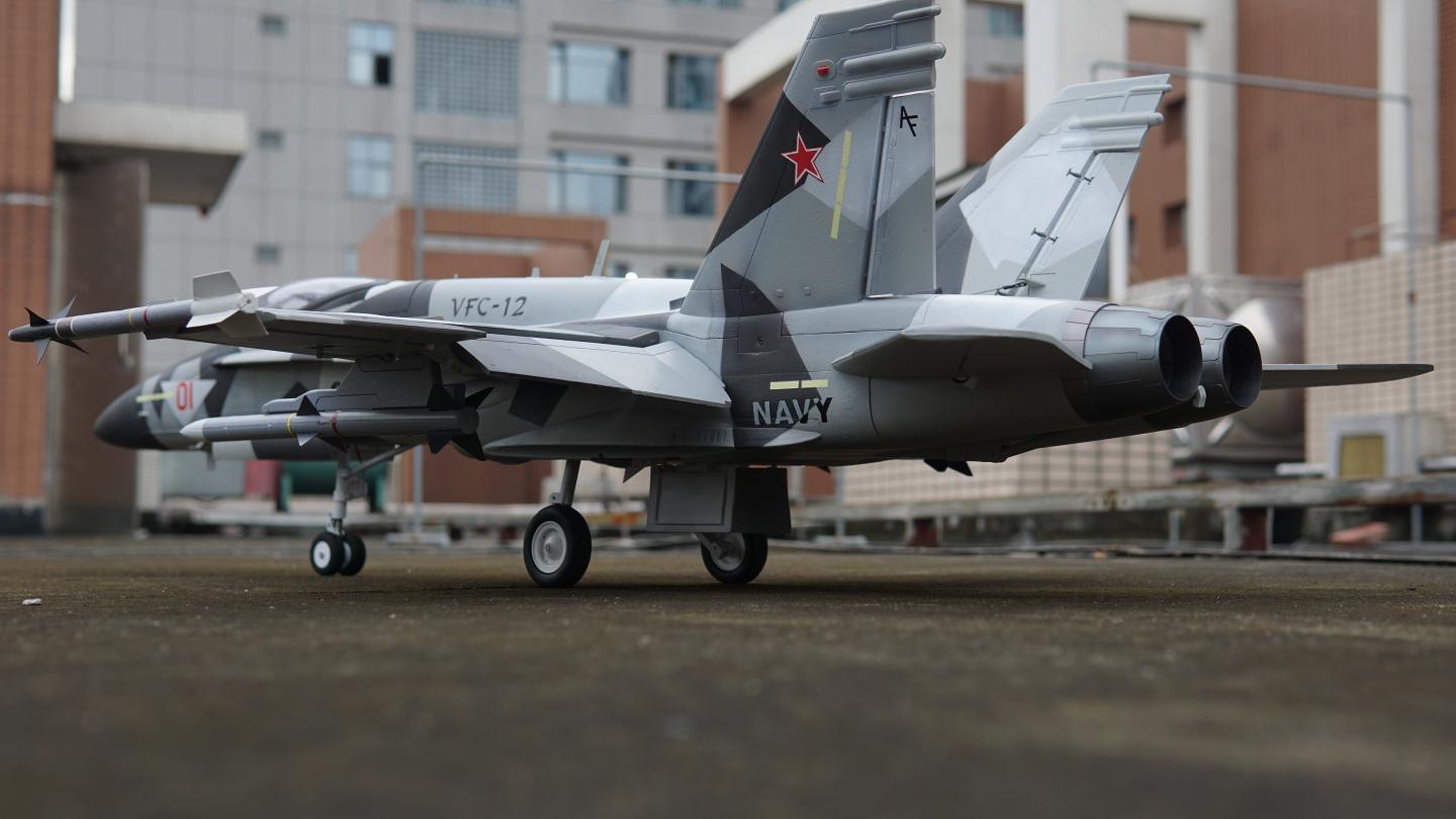

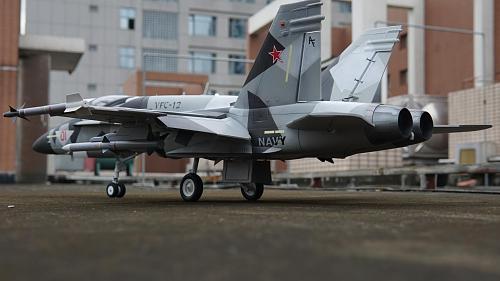

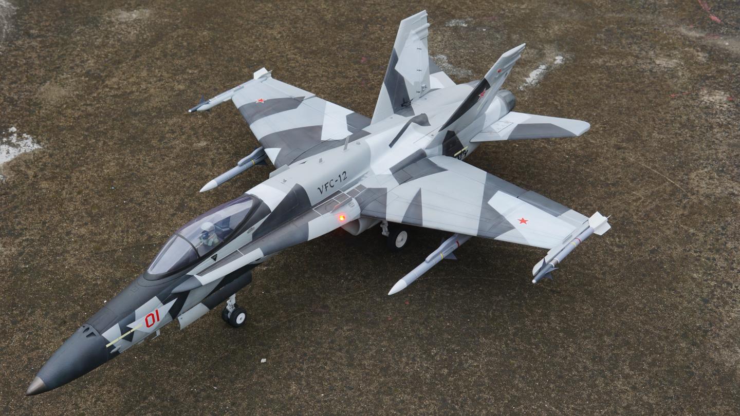

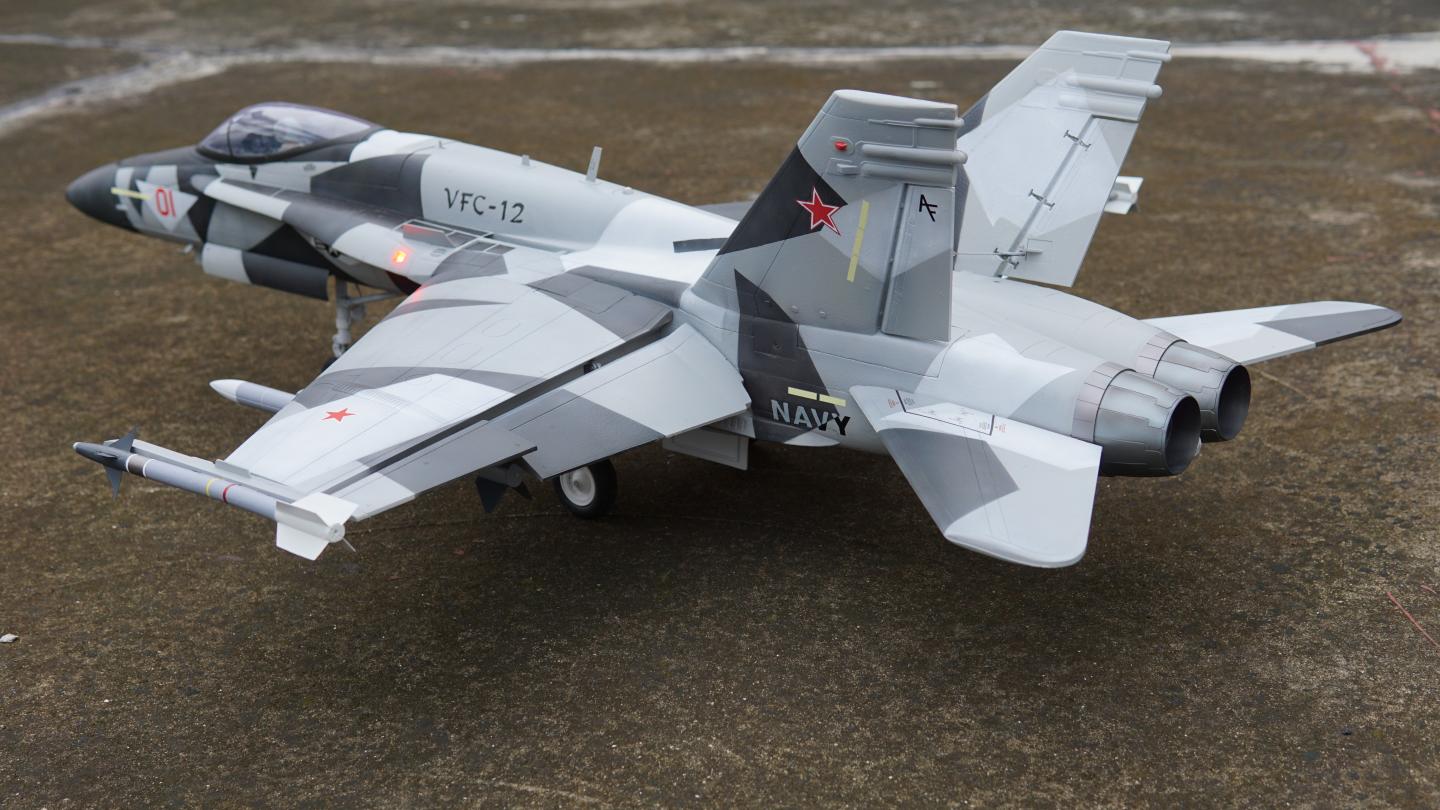

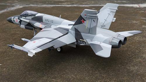

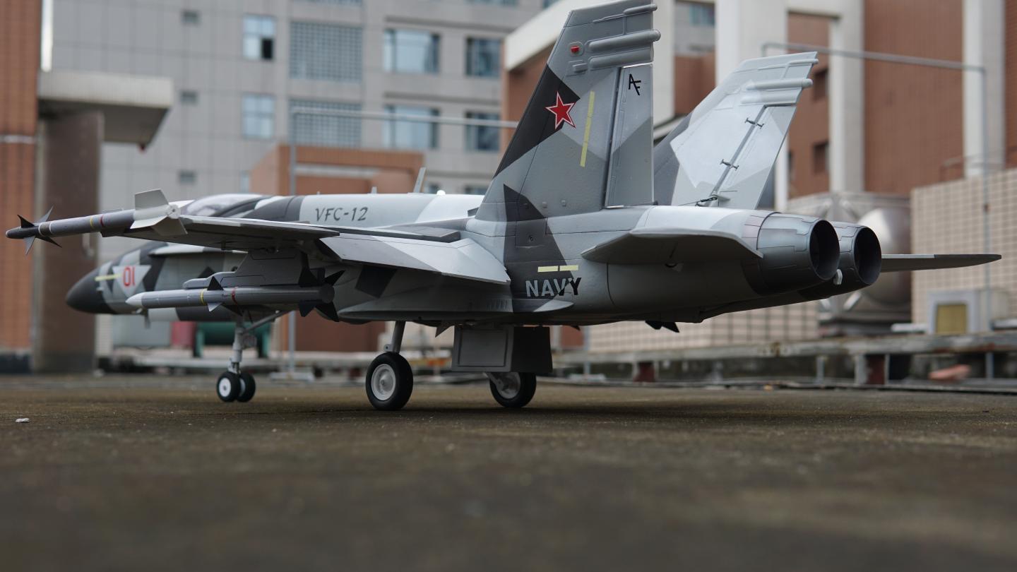

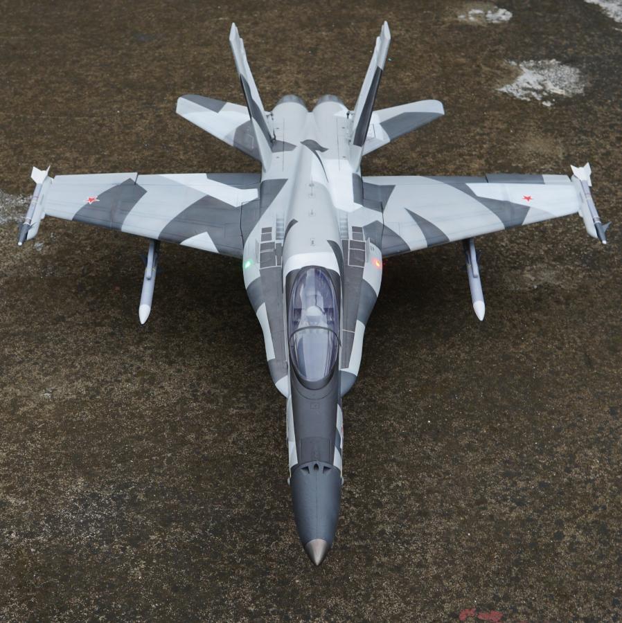

                          I received a message requesting what the 90mm F-16's ordnance looks like on the 90mm F-18, so here it is on my repainted bird. The AIM-9s and AIM-120s slot right in, and as you can see in these various angles the overall proportions are good. The fuel tanks, however, are too large in my opinion. For a center tank, at least the smaller capacity that VFC-12 flies, the 80mm A-6's wing tank is a good overall shape and length. I haven't had time to paint and install it yet, though.
                          If you have any requests for photos of other ordnance combos, let me know. I'm going to use the 90mm F-4's double AIM-9 pylon to mount two AIM-9s for a 6x AIM-9 configuration I saw online.

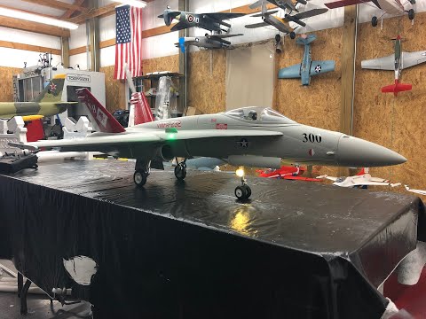

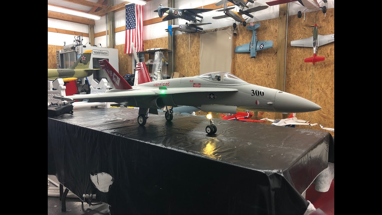

                                Short vid showing how I have mine set up. Have not flown it yet. Also added the Radar-Guy wheel covers.
                                What radio are you using?

                                    DX9 and an Admiral 10 channel Rx. Used 8 total channels (6 normal + 2 extra) and 6 mixes (3 for Flaps>Ail and 3 for Ail>Elev). I may end up applying Tailerons to all the flight modes at some point and not just landing flaps. Would be really easy to do.
