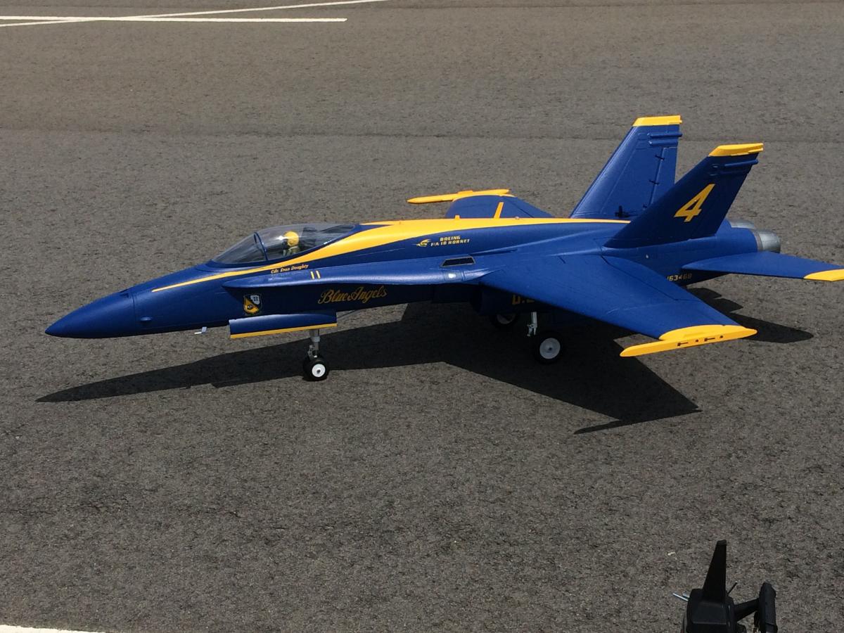

              So I’m still at the field waiting for the rain to stop. I was able to get 1 quick flight in before the 2nd round of storms. I set everything up per the manual. Leading edge of the horizontal stabs 7mm below the line. Flaps 9.5 below the line. Elevator at 36mm of travel. 80mm 1680kv stock edf from the f-14. 5000 mah HRB 6s battery, and the balance point was as far back as I could get. 80-85mm.
              Great first flight! Low setting on flaps (not full span) held full back stick till the nose came up and let off the stick and it flew off beautifully. Plenty of power on climb out. I used zero trim the entire flight. First landing was with full flaps at normal config and it slows down fine. Next landing I tried full span flaps. Required more power and a lot of up elevator, but was the best landing out of the 3. 3rd landing was back to normal flap config and was almost power off. ( too steep). Roll rate with ailerons only is just as responsive as with tailerons. I think the only real benefit of the tailerons is when using full span flaps. For now I’ll probably use full span if it’s smooth conditions and normal config for any gusty conditions.
              With the 80mm I had plenty of power for loops and other aerobatics, but it’s not unlimited vertical. Alpha is right, I had to use slightly higher throttle than my other freewing jets, but nothing to make me want to spend the extra money for a 90 quite yet. This is probably going to be my favorite next to the 70mm v2 f-16!! Nice job MRC!
