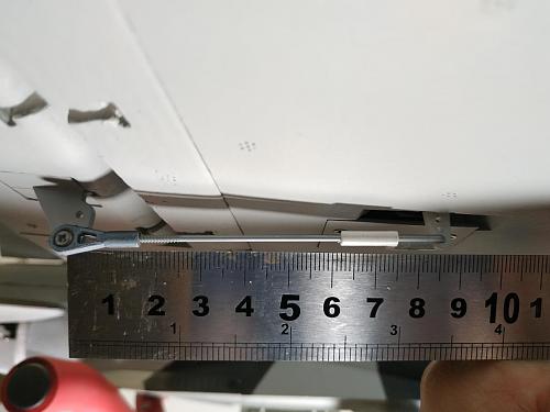

                        Going off the top of my head I have 4 75mm rods and 2 70mm and 2 55mm
                        according to the manual I should have 4 80mm and 4 70mm.

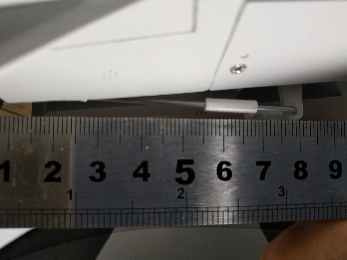

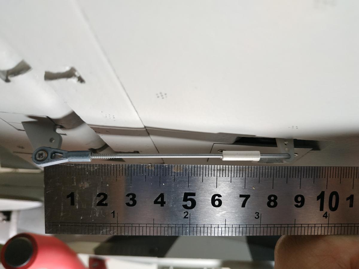

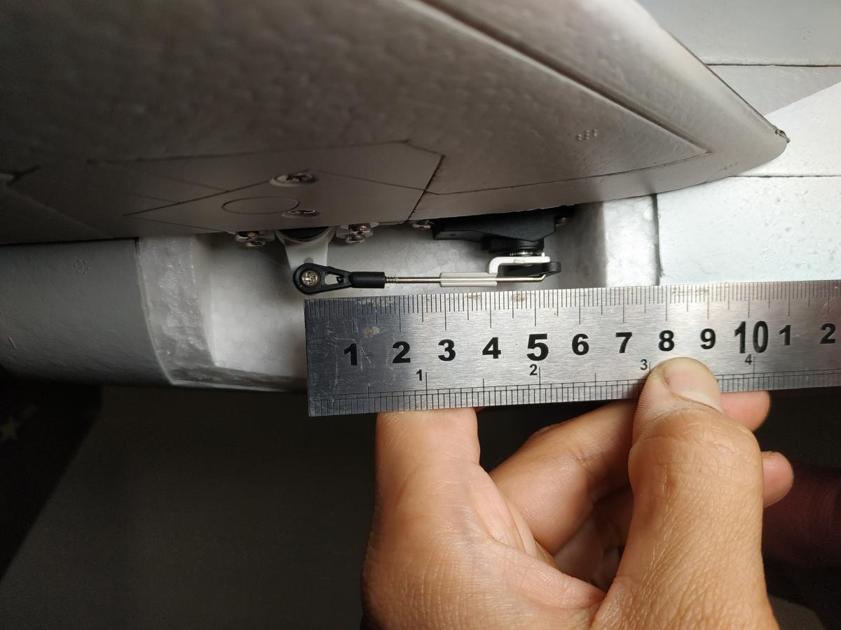

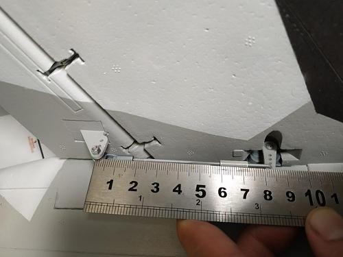

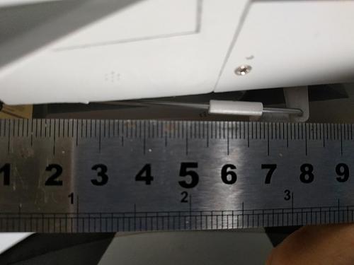

                        Hi Thisguy65, I know you've got experience --my answers are generalized for the entire audience since I know there are less experienced people reading this who may be wondering the same question. My underlying point was that the rod length given in the manual for A/R/F doesn't take into account the total length of the Rod + Clevis. Looking through it, the manual's diagrams are confusing and the elevator's length doesn't make physical sense (we'll edit that and repost online), so in cases like that I default to arranging the linkages as the aircraft requires them have level surfaces.The aircraft's servo positions and neutral surface positions are fixed, so our total linkage measurements (rod+clevis) should be just about the same as long as you're using the same holes. Below are my results:
                        Aileron:
                        Your 75mm rod = My 75mm rod + clevis, adjusted for neutral surface position = My 88mm Aileron (measured between the centerpoint of the outer hole of the servo arm and the centerpoint of the ball link control horn)*

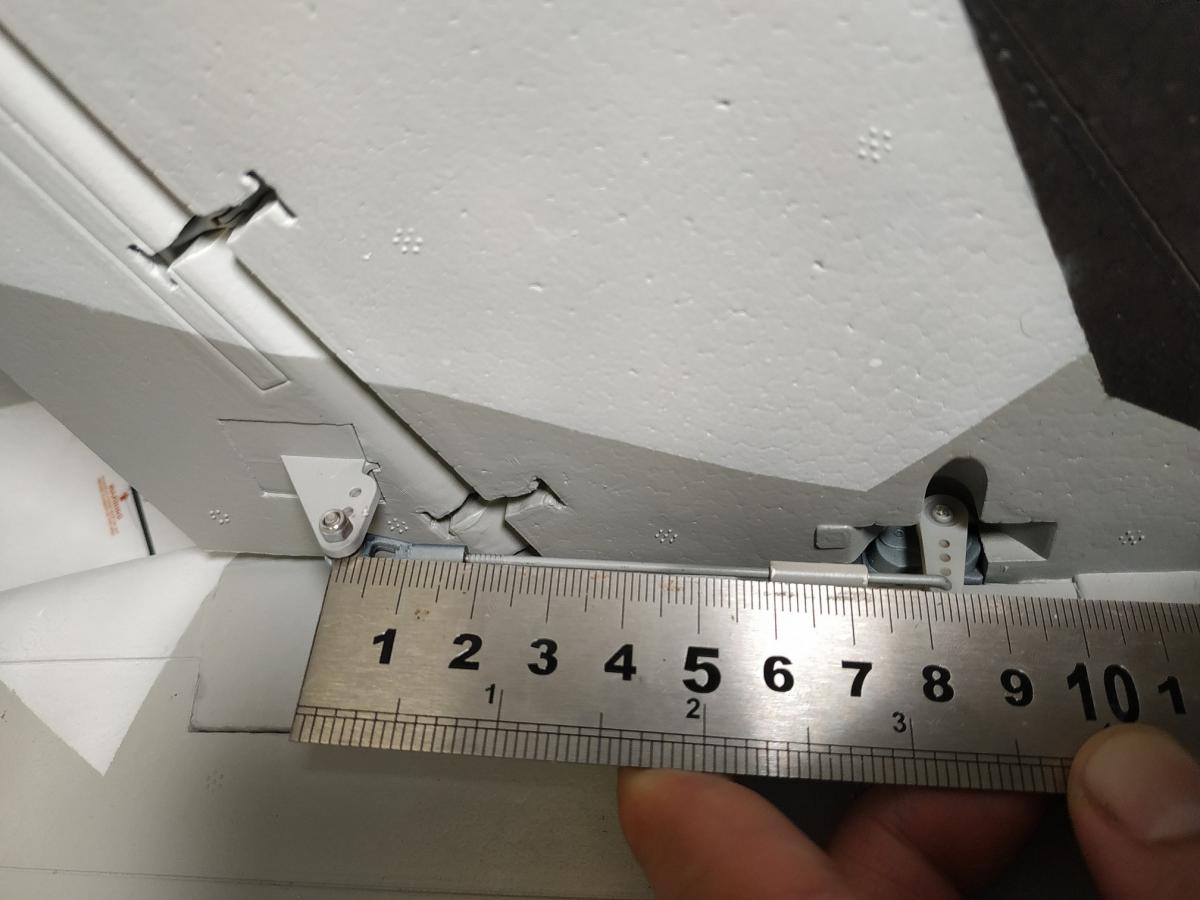

                        Rudder:
                        Your 75mm rod = My 75mm rod + clevis, adjusted for neutral surface position = My 84mm Rudder (measured between the centerpoint of the outer hole of the servo arm and the centerpoint of the ball link control horn)

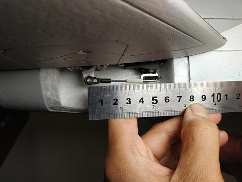

                        Flap:
                        Your 70mm rod= My 70mm rod + clevis, adjusted for neutral surface position = My 78mm Flap (measured between the centerpoint of the outer hole of the servo arm and the centerpoint of the ball link control horn)
                        Elevator:
                        As for the Elevator, my elevator rods are about 45mm long, + the clevis, resulting in a total length of ~53-55mm (measured between the centerpoint of the outer hole of the servo arm and the centerpoint of the ball link control horn). It your shortest available pair of rods is 55mm, that's probably going to be at least 3mm too long (since part of the total measurement is the thickness of the clevis itself. Please contact the CS team on Monday if that's the case.

                                      Alpha,
                                      Thanks for help And pictures that cleared things up.
