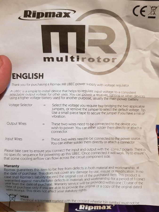

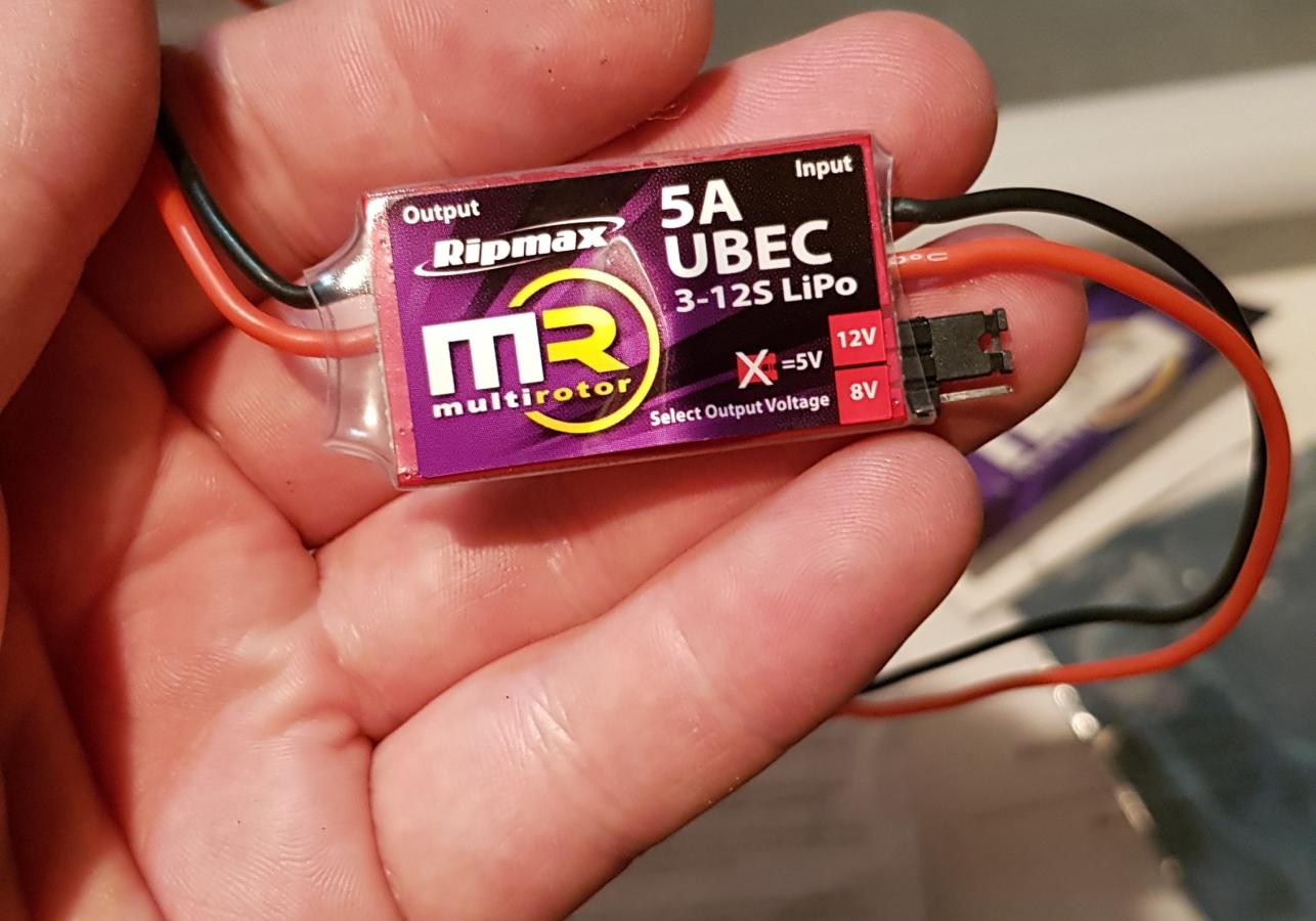

        I have also been wiring in a ubec to power my centre burner. Could some one just confirm where I have the jumper set on the ubec that I will get 8 volts and no more than 8 volts. Instructions aren't particularly clear.

          In your picture it looks like you have it set to 12 volts. Move your jumper over to have it positioned on the 8 volt block. Hopefully someone else chimes in to verify..
          In other words, you have 3 prongs there. The top one is your positive 12 volt one. The bottom one is your positive 8 volt one, and the middle is the common ground.

            Yes thanks you are correct. Also I was being a moron. Realised all I have to do is put a volt meter on it to check it. Lol

              • Just as well I checked otherwise I may have had a real after burner lol
