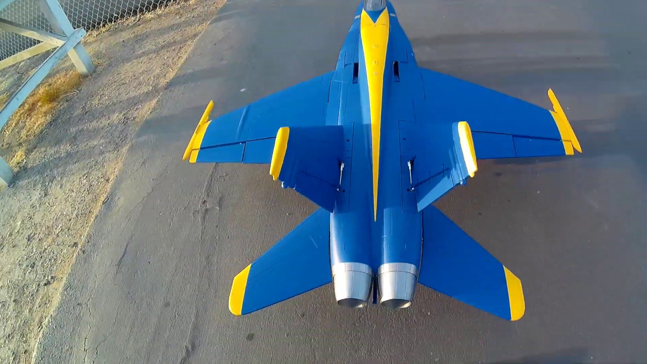

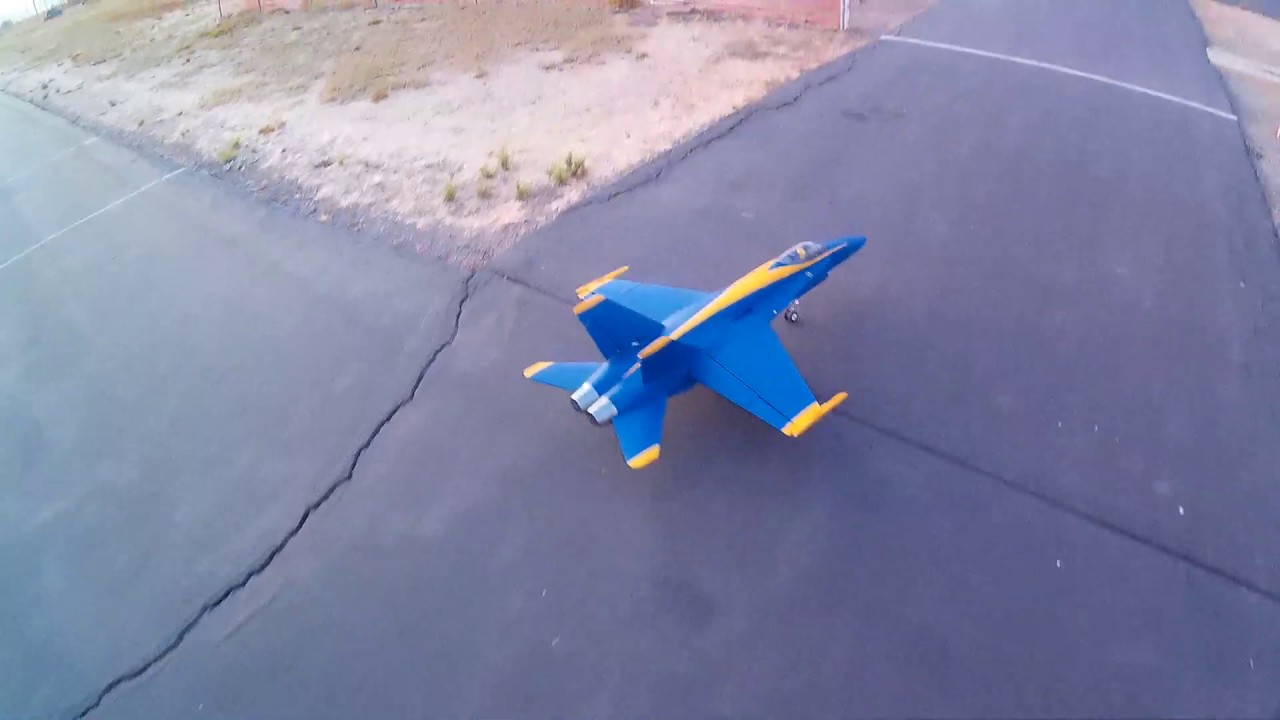

                      I am really happy to see this! I will get one simply because I wanted to get a gray one as well! I love the FMS 80mm 12 blade fans and this is an FMS plane with Eflites name on it. FMS had said that there were a lot of EDF jets coming and I am sure that this is one of those and Eflite is just putting their name and AS3X into it. It looks awesome to me and I have no issue with the lack of lights! I will just add the most important one! the Firey BOOTY!! LOL
                      Also I got my Blue Angel in the air yesterday! got 4 awesome flights with my older F-15 Hopped up Set up. Hard to believe that I got this thing going back in 2016!! Leopard 4082 1600kv inrunner with the older Freewing 12 blade rotor and Gooniac Balanced of course! It did amazing in this plane and I am super happy with it! All of the hard work paid off and I am glad that I went through all of the issues that were being had with the bird! Will share video later...
                      • gooniac33
                        The Original Gooniac
                        • Jun 2016
                        • 1047

                            I got 4 flights in crazy windy conditions. My field is 44 miles away so if its windy when I get there I am not gonna turn around and go home.... gotta fly!! Glad I did too because it went wonderful! Aside from trim not working on my left aileron for the maiden (I did get it fixed and working later) the plane flew great! Ailerons are super touchy!! I cut my throw down to 45% but I am also using towerpro MG90S servos which may have more travel than stock. I really cut down the elevator throw as well since I have different 17.5g JX servos there. I ripped off the elevator mounting plates and then put super thick CA there and they are not moving at all... Very happy with how it flew and by the 4th flight the wind had calmed and I was able to fly a little more aggressively. I am using a 3 year old set up that was in my F-15 back in the days but it moves this thing around really nicely! I am working on another MONSTER 6s set up that should be done by this week once all of the parts show. This set up should be capable of 4-8 min flying times depending on how you use the throttle.... more of that later when it shows... here are my flights and if you don't like hat cams just don't watch ok? thanks...
                            Also if you want to know how I set it up here are the specs...
                            Freewing 90mm inrunner housing
                            Freewing 90mm 12 blade rotor (older individual blade style)
                            Gooniac Balanced to perfection
                            Red Brick 200amp ESC
                            ZTW 10amp UBEC
                            LemonRX 7ch receiver
                            Towerpro MG90S Metal Gear Digital Servos (Flaps/Ailerons)
                            JX 17.5g Servos for Elevators
                            Gooniac's RC EDF Creations LED Afterburner

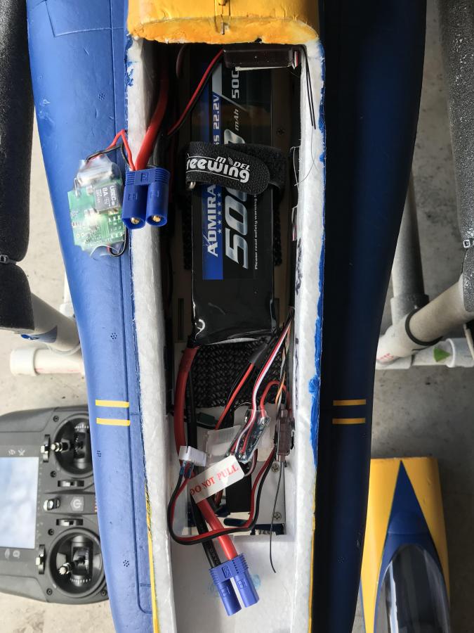

                                  Does anyone have pictures of their Admiral 5000 battery location? My first one went in due to elevator but with people mentioning they had their Admiral battery 3/4 of a inch from the front bulkhead has got me, well concern.
                                      Here you go. Other than the Carbon 5100 mAh, most my 6S batteries are at this same location.
                                        The 5000 admiral is a very light weight pack. I found it needs to be right at the forward edge of the battery tray. But dont trust me 100% as I also run ordinance. Just set the CG with your fingers on the back corner of the plastic forward wing mounting plate.
                                        My Admiral 6000 pack I run with it pushed up and almost touching the blue box

                                          Odd to me that guys are running them so close to the bulk head.
                                          Here
                                          Example
