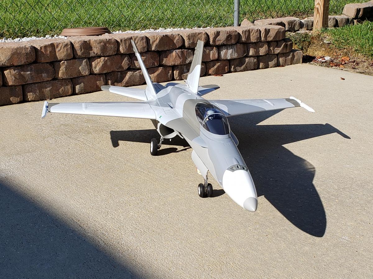

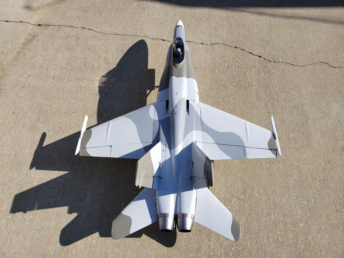

                        Maidened the bird yesterday with two great flights. I love the power and the speed. The landings were surprisingly easy. I like the way she settles in on final.
                        Repainted her last week. She has full span flaps with ailerons as flaperons. I did add some reflex on the flaperons linked to the elevator. I had to dial in some elevator-flap mixing as well.

                              #4135
                              yeah man I couldn't stand the other scheme. Now I need to contact Callie for some NSAWC decals.

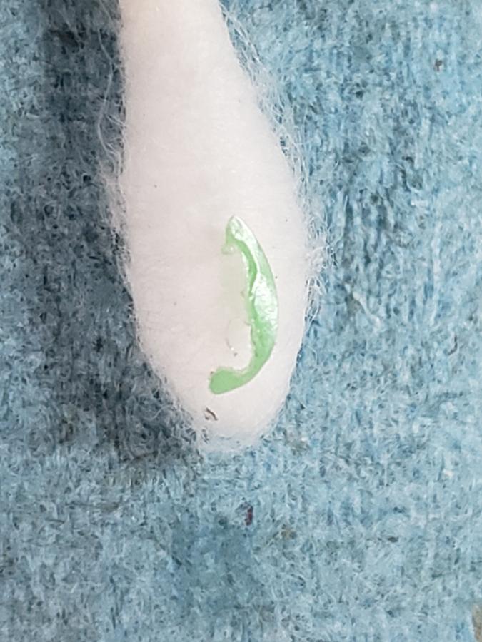

                                On flight 1, the nose gear unit would not retract. So I made flight 2 with gear down. Upon disassembly of the retract unit, it was apparent that the can motor was not turning, even without the gear case. So I disassembled the can motor and found this piece of plastic FOD inside. The unit works fine now.
                                Motion was going to give me a store credit for the gear, but there is no need now.
