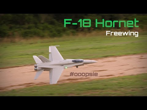

    And another video... still pulling some acro moves with the damaged EDF rotor before I got to change it! :)

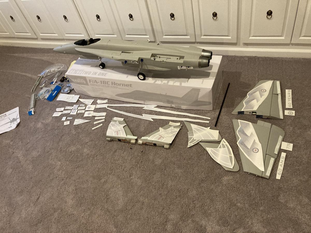

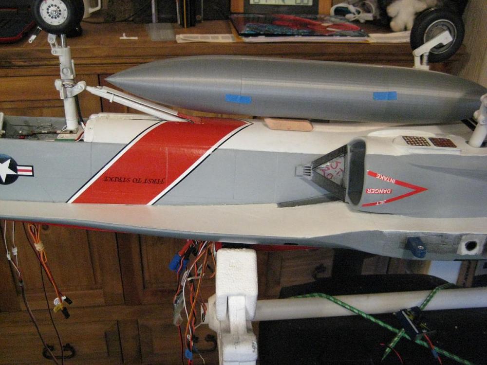

      • I would like to 'tank' all of you for being so patient with me during this build. Best, LB
        Click image for larger version  Name:	IMG_0424.JPG Views:	49 Size:	131.2 KB ID:	280031

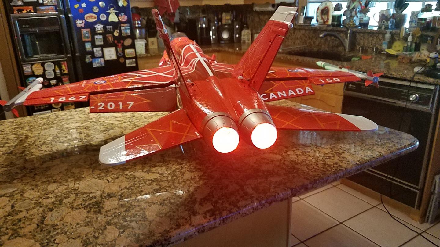

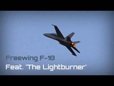

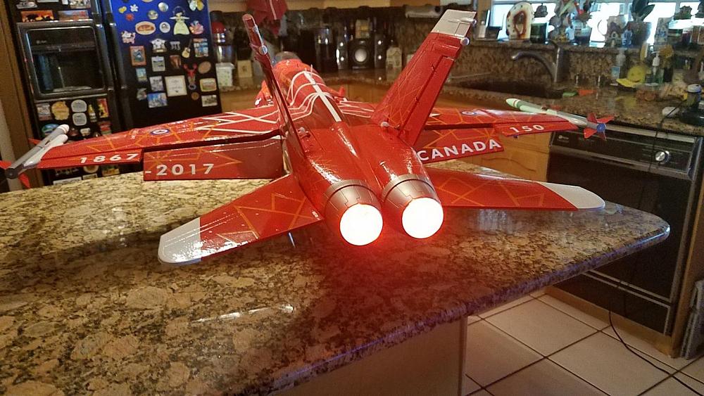

                        • Just as promised... LED afterburner is here, and it looks dope!
                          Centerburner courtesy of 'The Lightburner'!
                          (I have yet to paint the ducts so the light doesn't seep through!)

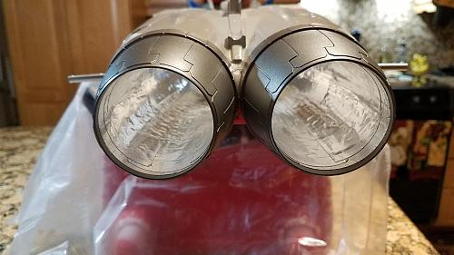

                          • Originally posted by Airguardian View Post
                            (I have yet to paint the ducts so the light doesn't seep through!) ;)

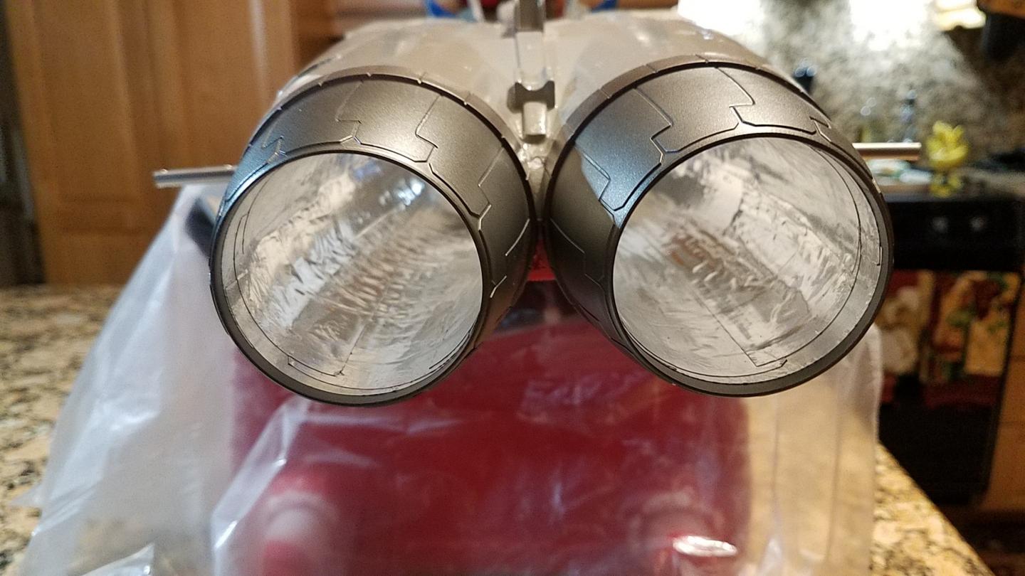

                            You may want to put aluminum AC duct tape in instead of painting. I have afterburners in every EDF I have except the A-10 and tried them without paint, with reflective silver paint and the aluminum duct tape and IMO the duct tape gives by far the best results, but maybe that's just me. Takes a little longer to install properly but now every EDF of mine with an AB has that tape.
