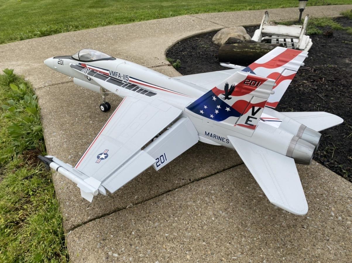

                Hey Hornet Drivers, Still plugging away with big graphics and some reassembly. I keep finding those, "I'll do that when I get to that point" items' however, excited to have finished the install of the Tail Hook Assembly. I will redesign the cover to a more scale length but other than that, it's done. Got some 3DPUP trim parts installed including (Insert Original Author's Name Here) LEX Fence Bracket. It is a perfect fit, I printed it at .5mm Z which worked better for me. Anyway, big thank you there. More, when there's more. Best, LB and Happy Labor Day.
                          Quite simply put, OUTSTANDING!
                            Elbee commented
                            Editing a comment
                            Thanks, Hugh.

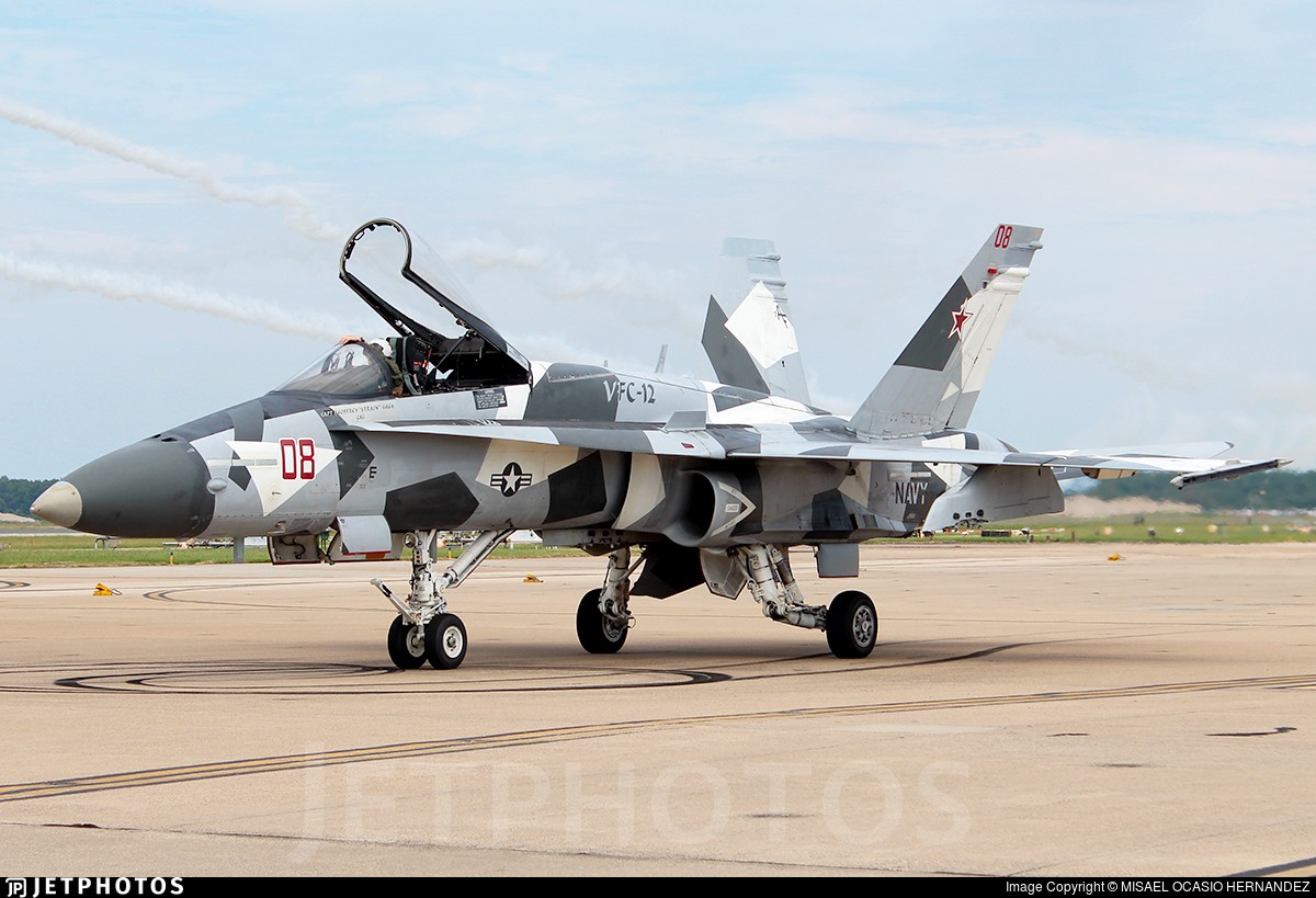

                              #4175
                              Hi guys, I am working on a VFC-12 Fighting Omars livery on a base gray F/A-18, but in reference to the picture below the base gray paint from Freewing is a bit light.
                              For the guys that have done custom liveries, are you folks just using the stock base gray paint as your canvas, or respraying with a darker gray to better match the scale aircraft?
                              I just have a feeling if I stick with the stock paint, while I may be the only one to ever notice, it would bother me. So I'm likely going to respray, just looking for suggestions on what paints / colors folks are using. If there is a good base color from Krylon/Rustoleum, etc, that would work. Or even Vallejo, Tamiya, Createx airbush paints would be even better as I prefer to not use a rattle can if I can help it.
                              Thanks!
