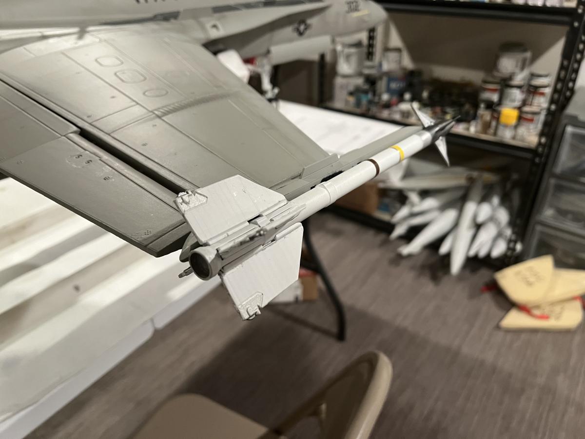

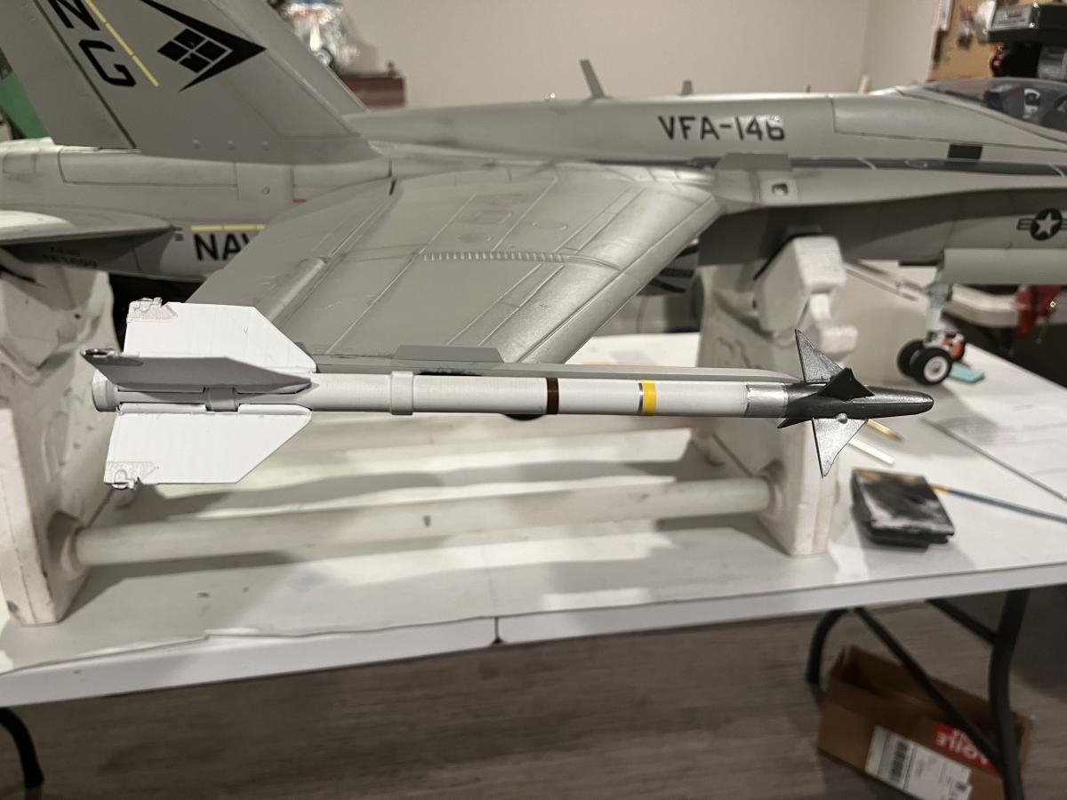

                        After getting my 29th flight (3 on this new airframe with the innards the same on all flights so far) I am now looking out the window at the white stuff coming down. But I'm taking advantage of the down time to work on my AIM-9 Sidewinder missiles that I am learning to 3D print with my Prusa mini. These are from the files of Dirty D in 1/10 scale. So, although maybe slightly larger than scale (1/10 versus 1/11 of the model), that difference is really indistinguishable when they are mounted on the wingtips.
                        I still have scale nomenclature and markings to put on the missiles that I'll have Callie print up, and then they should basically be finished. I plan on doing some test flights with these missiles mounted next week when the weather gets better.
                        A Big Shoutout to LB for his continued support of getting me up and running on this new medium of model building!
                        Davegee

                          Originally posted by davegee
                          After getting my 29th flight, I am now looking out the window at the white stuff coming down...I'm taking advantage of the down time to work on my AIM-9 Sidewinder missiles that I am learning to 3D print with my Prusa mini. These are from the files of Dirty D in 1/10 scale...
                          DG, Absolutely fabulous work. Sir. :trophy: Best, LB

                            #5773
                            I had an Excellent teacher!
                            Davegee

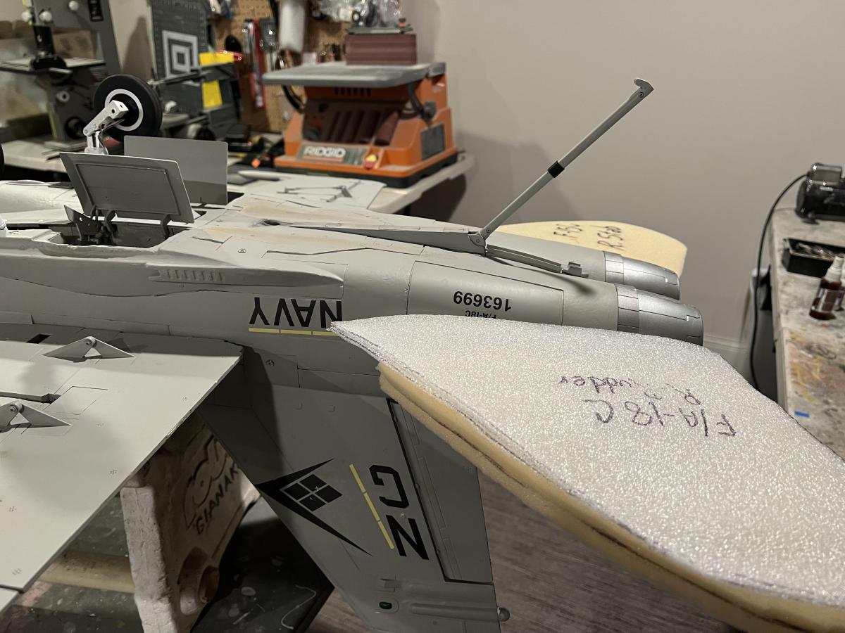

                              #5774
                              I just finished up another mod for the F/A-18C Hornet. This is a movable tail hook via a small servo in the tail. 3D printed parts courtesy of Elbee that I printed up from his STL files and put it together. I had to order a small Du Bro connector pin that came today, so once I had it in hand, the finishing up went relatively quickly. There's always a bit of fiddling to do on these things like servo travel, checking security of the mechanism, and all that. But it is well worth doing, for me. I have put a movable tail hook in my F-14D, A-4E, and a Grumman F6F Hellcat years ago. This one is not stressed to actually "catch" the airplane, but I'll probably do some photos of it in the air with the hook down, just for yuks.
                              Cheers
                              Davegee

                                • 8225
                                #5775
                                What a cool mod! Nice work davegee! You and Elbee never fail to impress.

                                  #5776
                                  Credit goes to Elbee. This is his design and it works very well! Thanks for the kind words, Aros. I’m a newbie trying to learn 3D printing.

                                    • 4851
                                    #5777
                                    davegee. Parts look great : Check. Functioning unit: Check. Nicely done, Sir. :trophy: Best, LB
