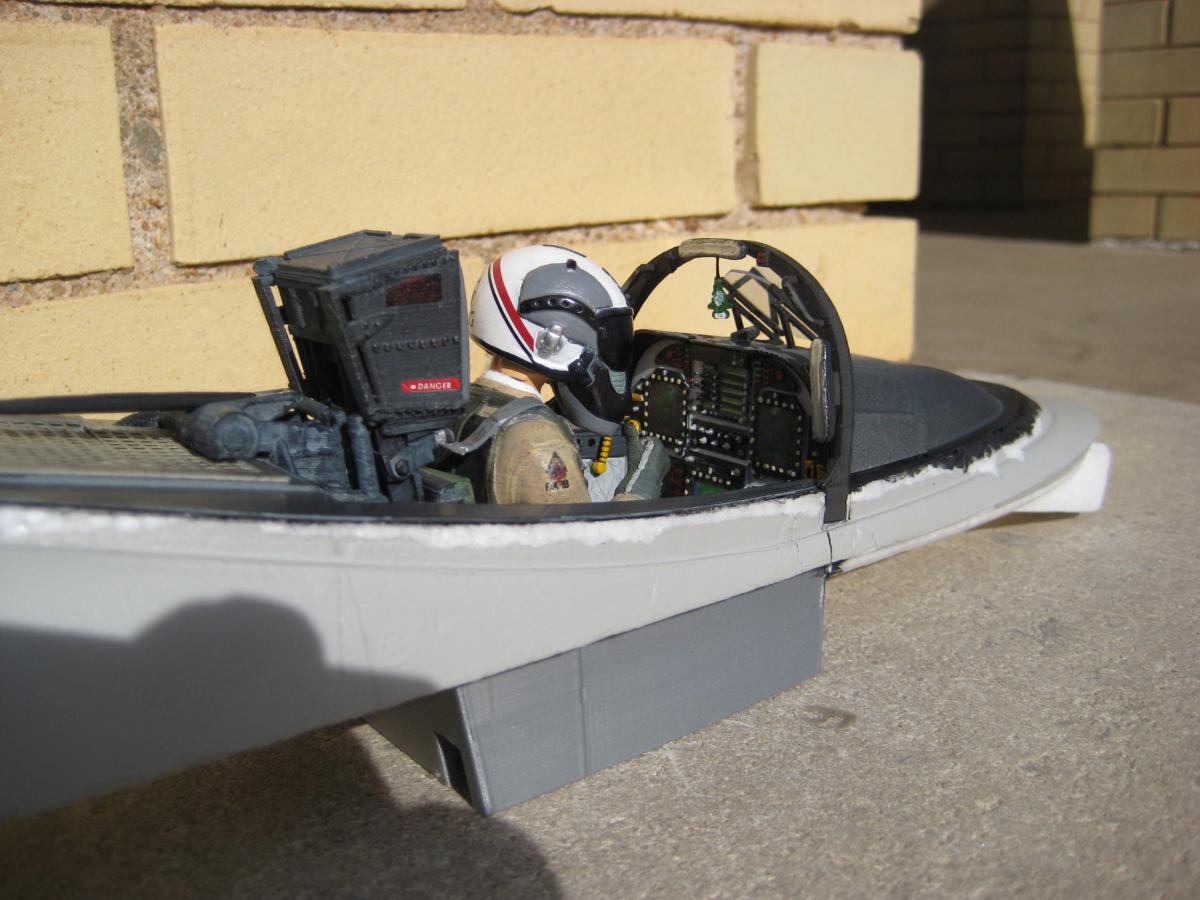

                              Originally posted by Fruchtzwerg76
                              Hey Steve, really great work! The parts are superb.
                              I was wondering which pilot figure did you use in your F18 cockpit?
                              Telling from the pictures, the pilot is not included?
                              Best greetings.
                              Alex
                              Hey Alex,
                              The pilot body is from Max Grueter Designs and I found it on CGTrader, also Greuter has some things on Cults3D, I think.
                              There are a couple pilot figures that are similar and less expensive around that you could use.
                              I modified the OEM pilot head by removing a "V" shaped section out of the back, pinching and gluing it together, and printing a modified cylinder shape for a new neck.
                              Sounds strange, I know, but it worked as I liked the general design of the OEM pilot head.
                              Happy 4th of July.
                              Best, Steve
ID:	428486 Click image for larger version

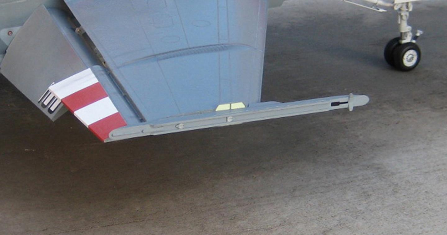

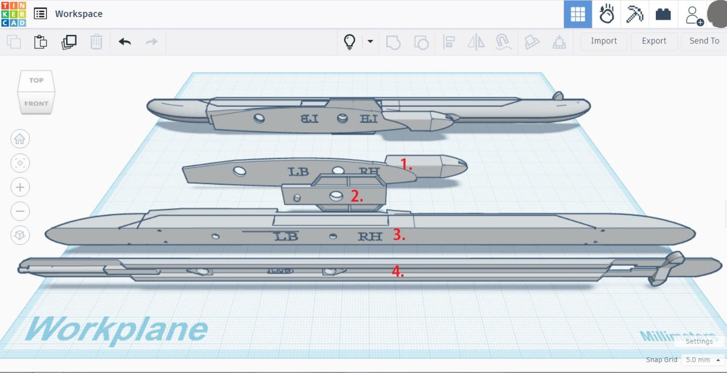

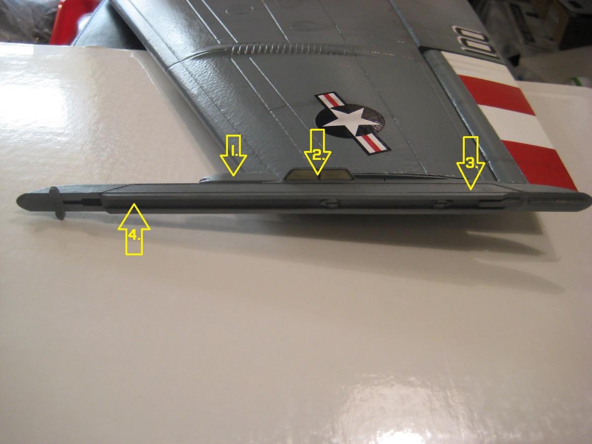

                                    https://www.printables.com/model/134...le-rails-lh_rh
                                    Hornet Honchos,
                                    There's been some renewed interest in the 3DP missile rails for this model.
                                    Okay, just one guy, but we all know him.
                                    I have posted my version I used on my Hornet on Prusa Printables. See Link.
                                    Better late than never, I said I would about 2 years ago, "Doh!"
                                    My set comes as 4 printed parts each side and screws in place in the OEM location.
                                    I drilled and tapped the OEM Mount points to 2-56 (or 4-40 ) and used countersunk nylon screws from the hardware store,
                                    It should be noted there is no mounting provision for Aim-9s, though you could add those with your own mod.
                                    Best, LB
                                    Click image for larger version  Name:	Freewing F-18C Missile Rails.jpg Views:	0 Size:	104.2 KB ID:	428509
                                    Click image for larger version  Name:	IMG_501.jpg Views:	0 Size:	71.6 KB ID:	428510 Click image for larger version  Name:	IMG_0526 - Close up.jpg Views:	0 Size:	79.2 KB ID:	428511 Click image for larger version  Name:	IMG_1202b.jpg Views:	0 Size:	77.6 KB ID:	428512
