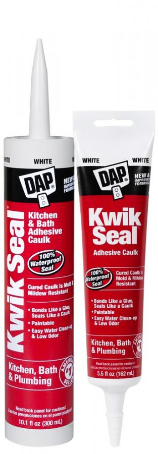

                                    I am about to try this.
                                    It's "East Water Clean-up & Low Odor", so I'm assuming it will not dissolve EPO foam.

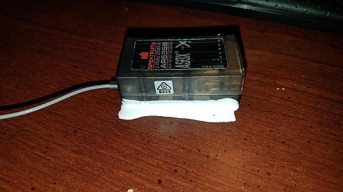

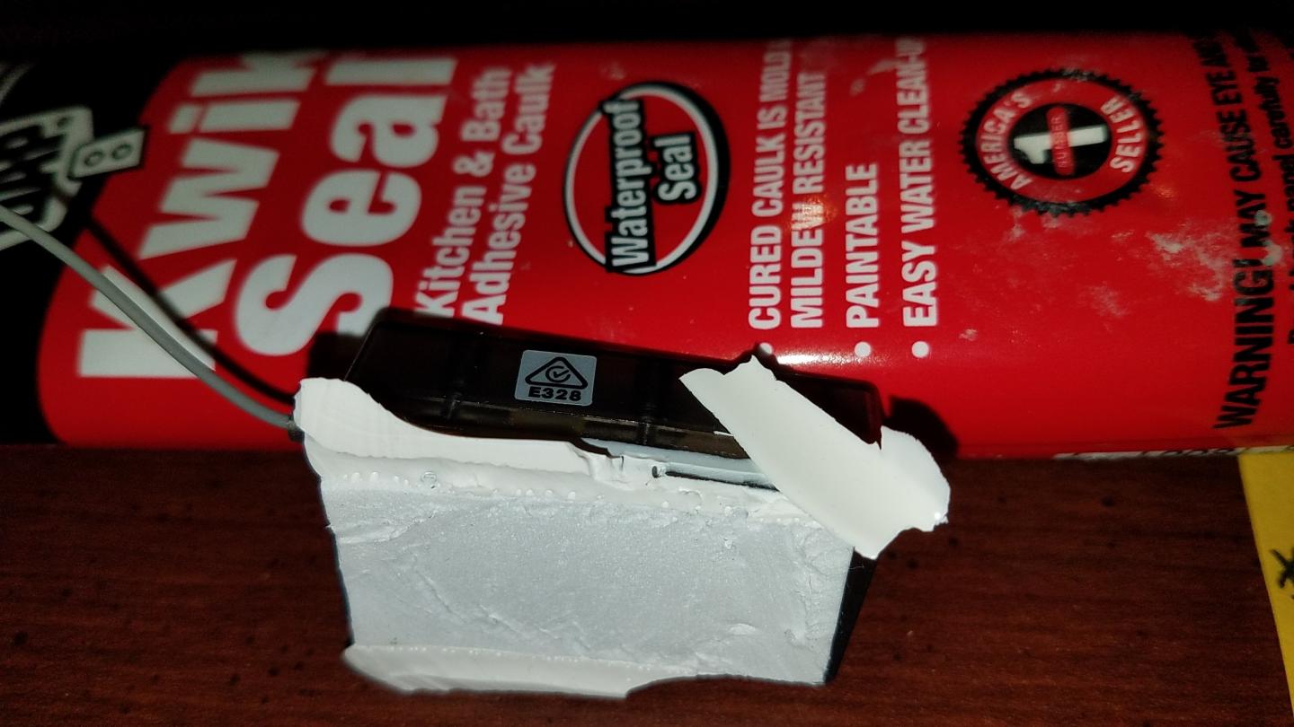

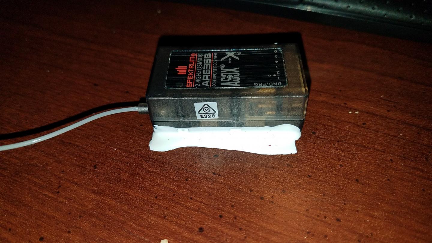

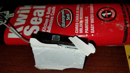

                                      fredmdbud not sure if that's the same as the adhesive Freewing and E-Flight are using. I've tried it before elsewhere in filling a "hole" or dent in a foam plane, smoothed it out and repainted it and it was a nice filler, but I don't think it has the same "adhesion" quality of whatever caulk they are using. It seems that the Kwik Seal silicone caulk does not "stick" as strongly to foam and plastic as you may like it to. You might want to try it out on a "spare" piece of EPO foam and stick a piece of plastic to it, let it dry thoroughly and then pull it apart. If you're using this to hold in a retract plastic landing gear mount, the last thing you want is it pulling out easily. The Beacon Foam Tac might be better for this, unless you find out it "holds" after testing it.
                                      As you can see from the photos below, E-Flight uses this same adhesive to "glue" in the receiver in the SU-30 (also in gluing all their receivers in for BNF as well as many other places including aileron servos in some planes). When I removed the receiver from the SU-30, it actually started to rip out some of the foam (so I had to slice it out with an x-acto knife to not ruin the foam) and the adhesive stuck to the receiver so well it needs to be cut and scraped off. First see if the Kwik Seal caulk "sticks" that well before committing to it. As I said earlier, if it does not, the Foam Tac will definitely do the trick and you will still be able to remove the mounts later if need be (not easily, but more easily than using epoxy-my usual go to adhesive). Keep us posted.

                                        Already did the Foam-Tac/contact glue - it didn't hold; in fact, the landing gear repair failed during its 3rd flight. fell out in the air.
                                        Gorilla glue wasn't any more successful - the bird limped back uneven-legged after the 3rd landing.
                                        After curing overnight, the landing gear seems secure, so time to do the magic 3 again.

                                          fredmdbud OK, seems your testing facility is way ahead of me, surprising that the Foam-Tac was such a huge failure. Looks like you're definitely on to something then with the caulk. I'm sure it's very disconcerting taking the bird up and wondering if the gear is going to fall out before landing, we have enough problems to worry about without that being one of them. Several years ago I did glue in some landing gear mounts on an old Stinger, but used epoxy then and it held.
