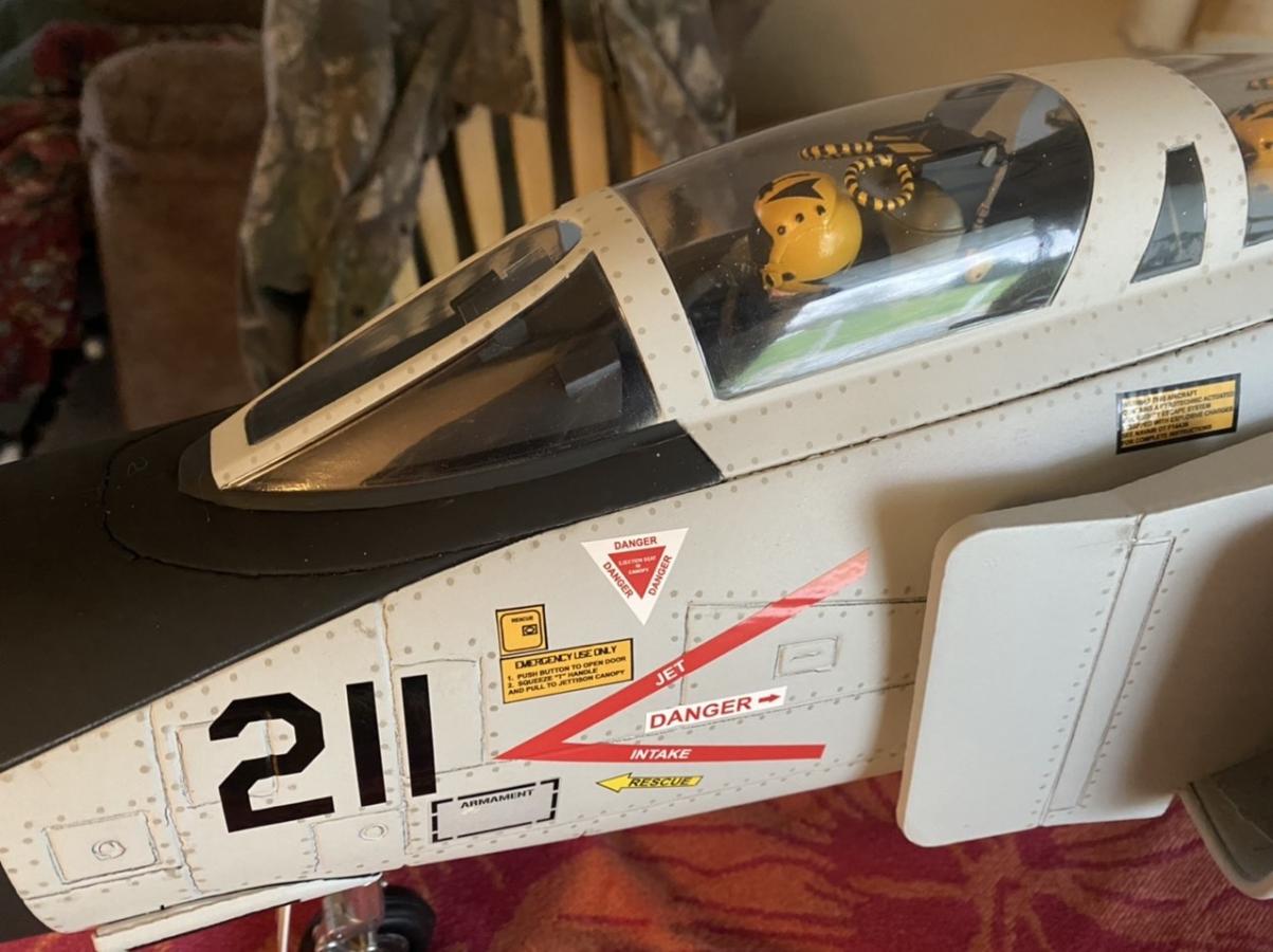

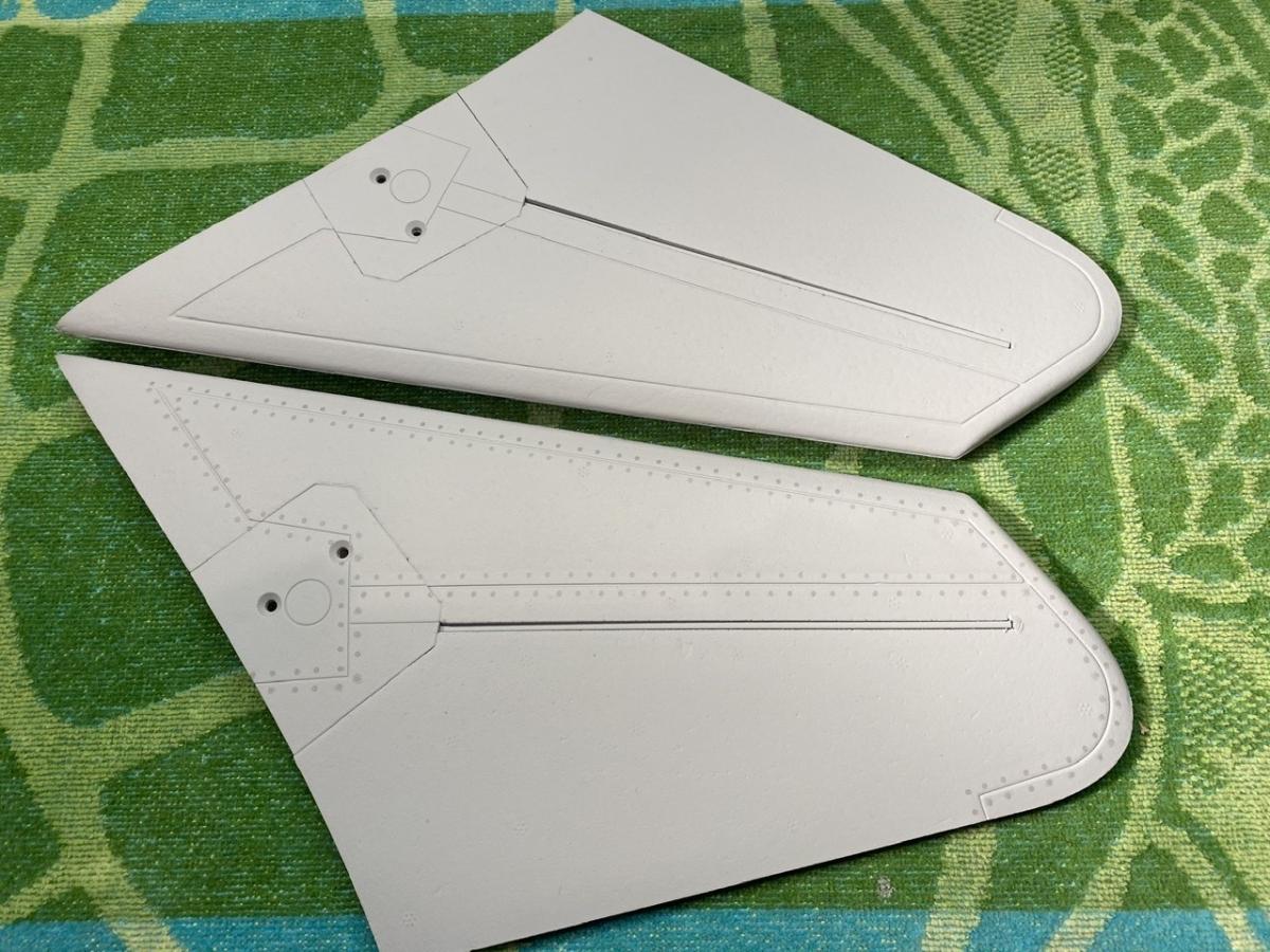

                              I finished painting the base color this morning. I used the same paint I mixed for the top side of my F-4. I am now starting to add rivets. I know it’s not scale but they really looked nice on my F-4.
                              Here is a pic of the stabs, one with and one without the rivets. Also a pic of the details on my F-4.

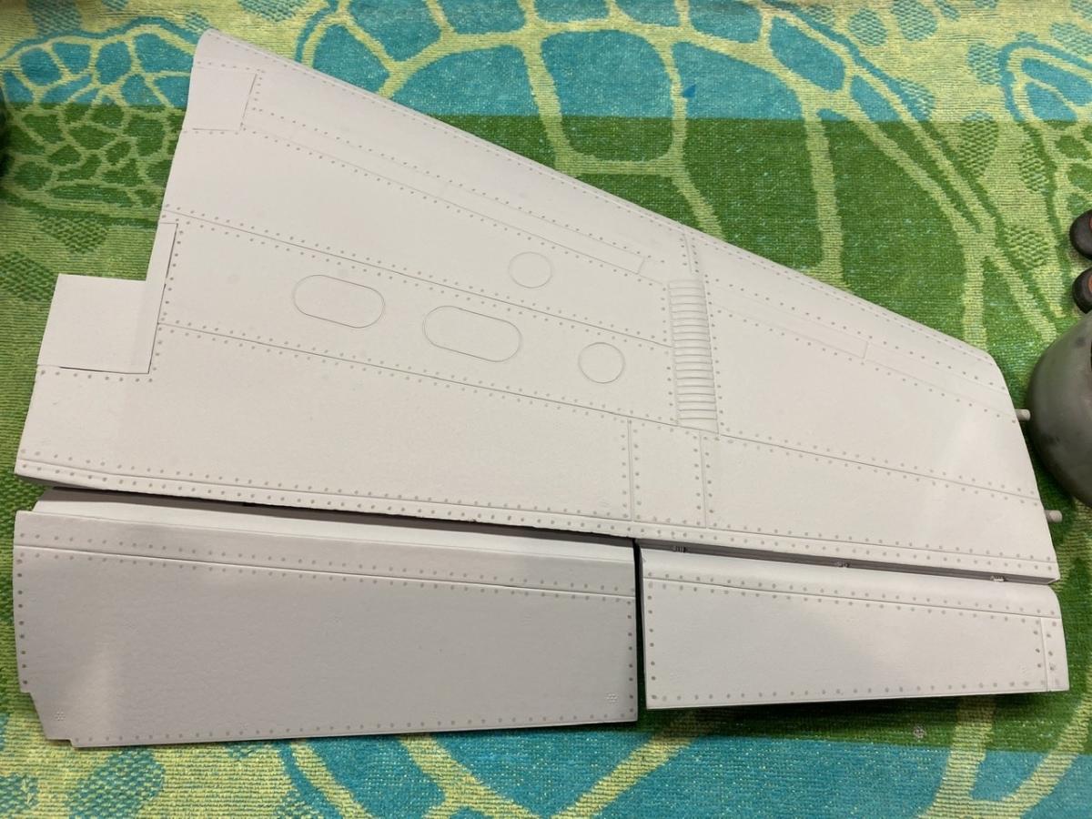

                                  The rivets are going much faster this time around. I have the tail complete and one wing panel.
