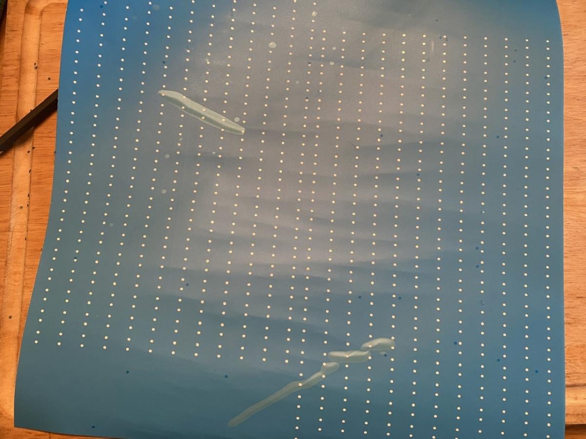

        Waconut how did you do your rivets?

          I cut low tack vinyl stencils. The rivets are .050 in dia. The strips are 1/2” wide. I get 24 strips out of a 12”x12” sheet. I then airbrush the rivets. I get about 4 uses out of each strip. I used about 65 strips doing my F-4.

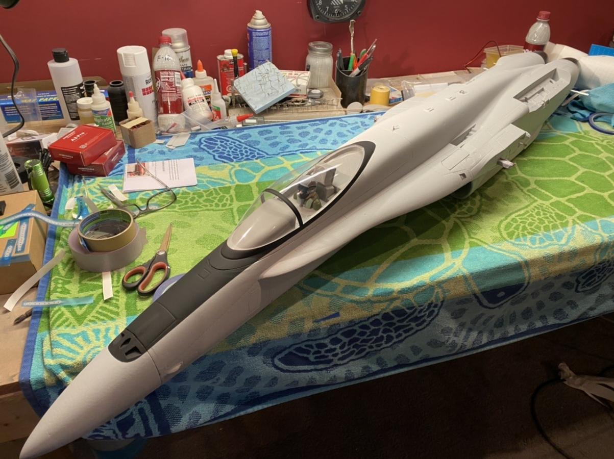

                      After taking the better half grocery shopping this morning I finish up the rivets on the wings and I did 1/2 the fuselage. I took a break from the rivets to mask and spray the flat black on the nose and around the canopy. I am doing the Silver Eagles livery. I also received my graphics today and the dual lightburner.
                      Will finish up the rivets tomorrow.

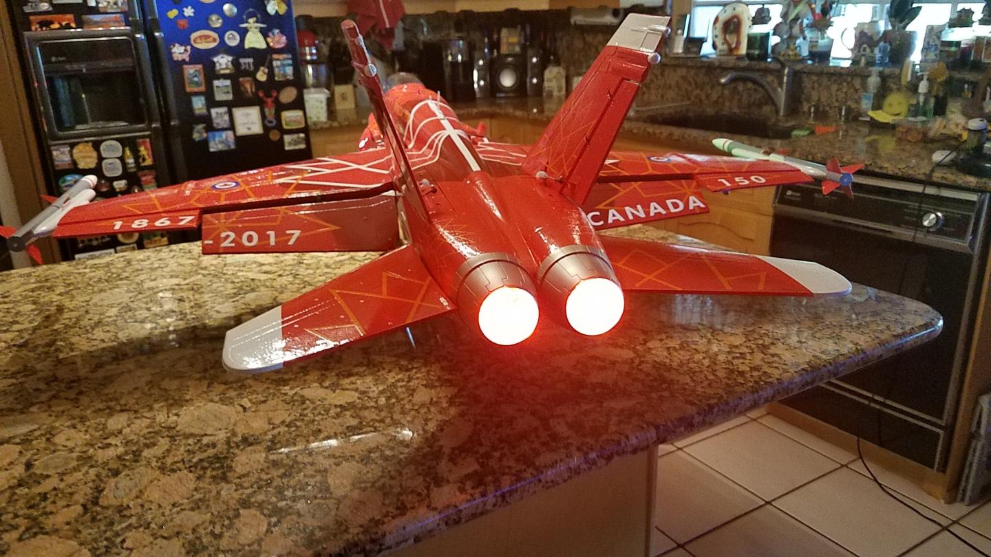

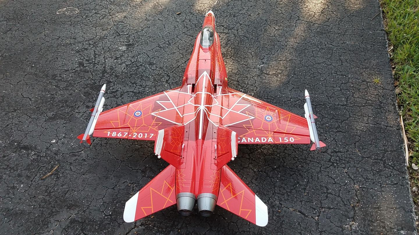

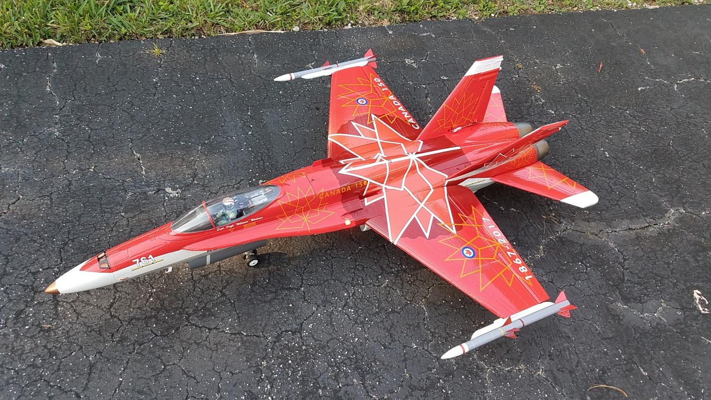

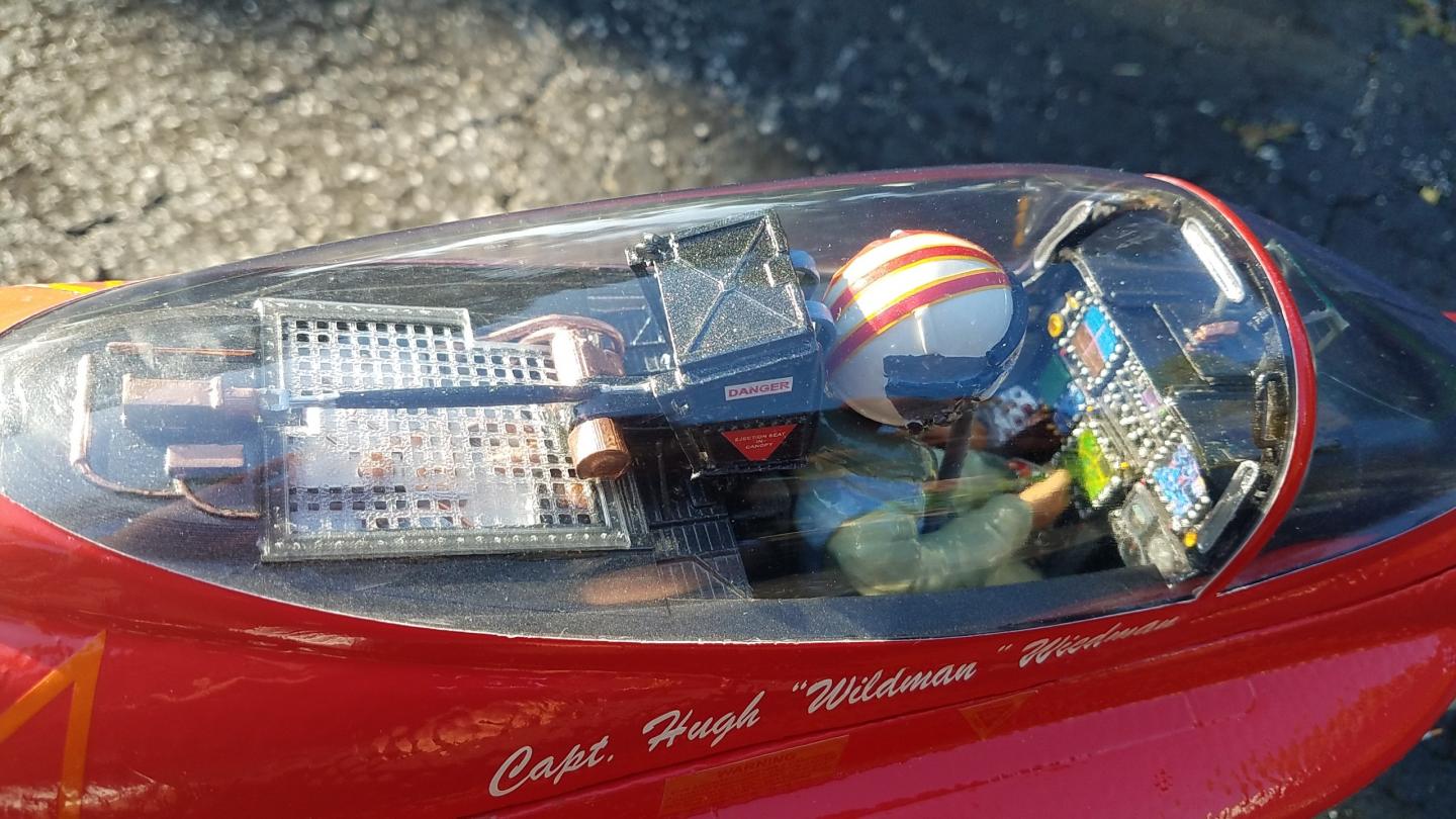

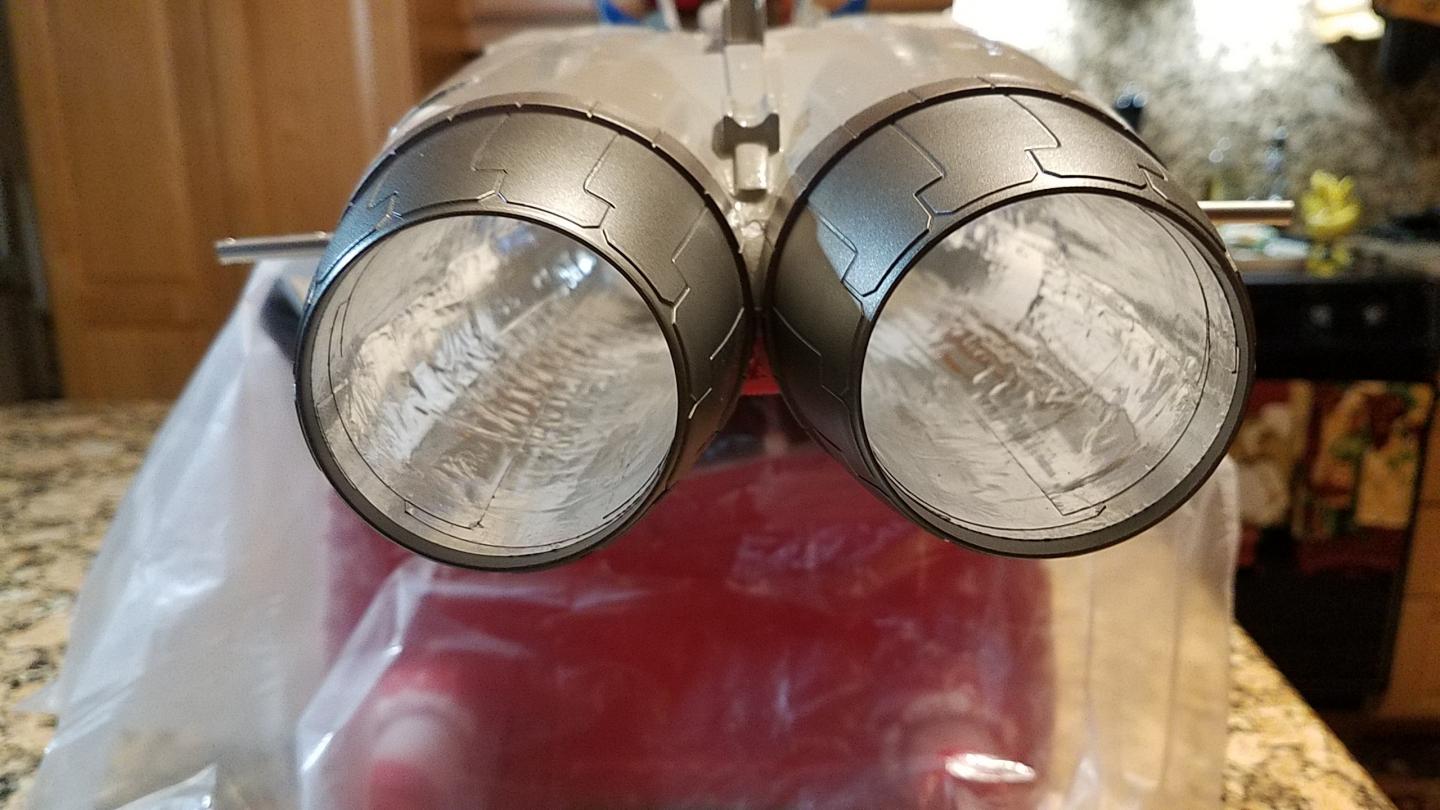

                              Finally almost finished with the F-18 Corona Hornet Canadian Demo livery. This is one of the few schemes that fit my outrageous personality so I didn't have to add any additional paint schemes or mix and add graphics from different schemes to get where I wanted to be. I must say that this definitely was the most time consuming build/repaint I have ever done, took 3 weeks to do the cockpit and another 3 weeks to finish the plane. If I wasn't in lock-down, I'm not sure I would have had the patience to do it, but now that's it's done, I'm very happy with it. I calculated that in order to get as much flight time on it as I have in build time, I will need to accomplish 3,250 three minute flights. :dizzy_face: Definitely something to be said for unbox, assemble and immediately go fly. Thankfully I didn't live in Michigan :mask: or I would not been allowed to go to Home Depot and get the paint, Rustoleum Gloss Spray Strawberry Fields, almost a perfect match for Callie's graphics. Added a twin LED afterburner as well and a few other minor modifications. The last thing left is setting up the D/R and final balancing, which is usually no problem, but the cockpit ended up weighing 190 grams (vs the 53 grams of the plain stock cockpit) making it very nose heavy. I moved the "blue box" back as far as possible (so I could move the battery further back) and will be adding about 3 ounces of lead to the tail in the elevator servo bays (I'll post some photos when that's completed).

                              Yes, I know a demonstration team doesn't carry ordinance, but the missals are just too cool to leave off, so no snide remarks.
                              Since I can't go to the field and fly yet, did a video on this F-18 static on the ground:

                                Beautiful looking model there! Excellent work!! This is my favorite F-18 scheme I I have mentioned this before in this thread to those who have done versions of this jet: the maple leaf roundels in the graphics is incorrect as it is the pre-1965 style roundel. See attached photo for the correct version.
