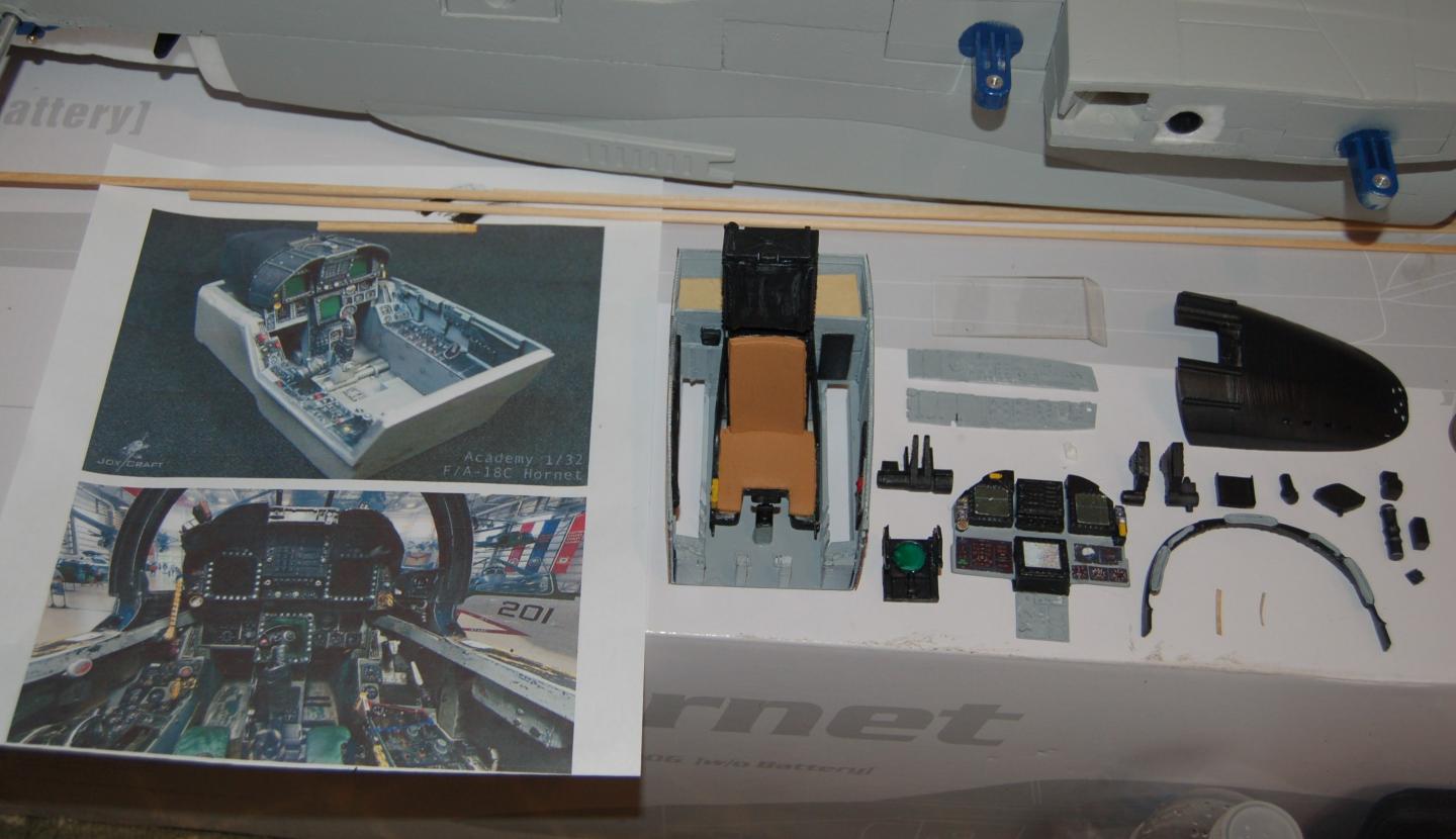

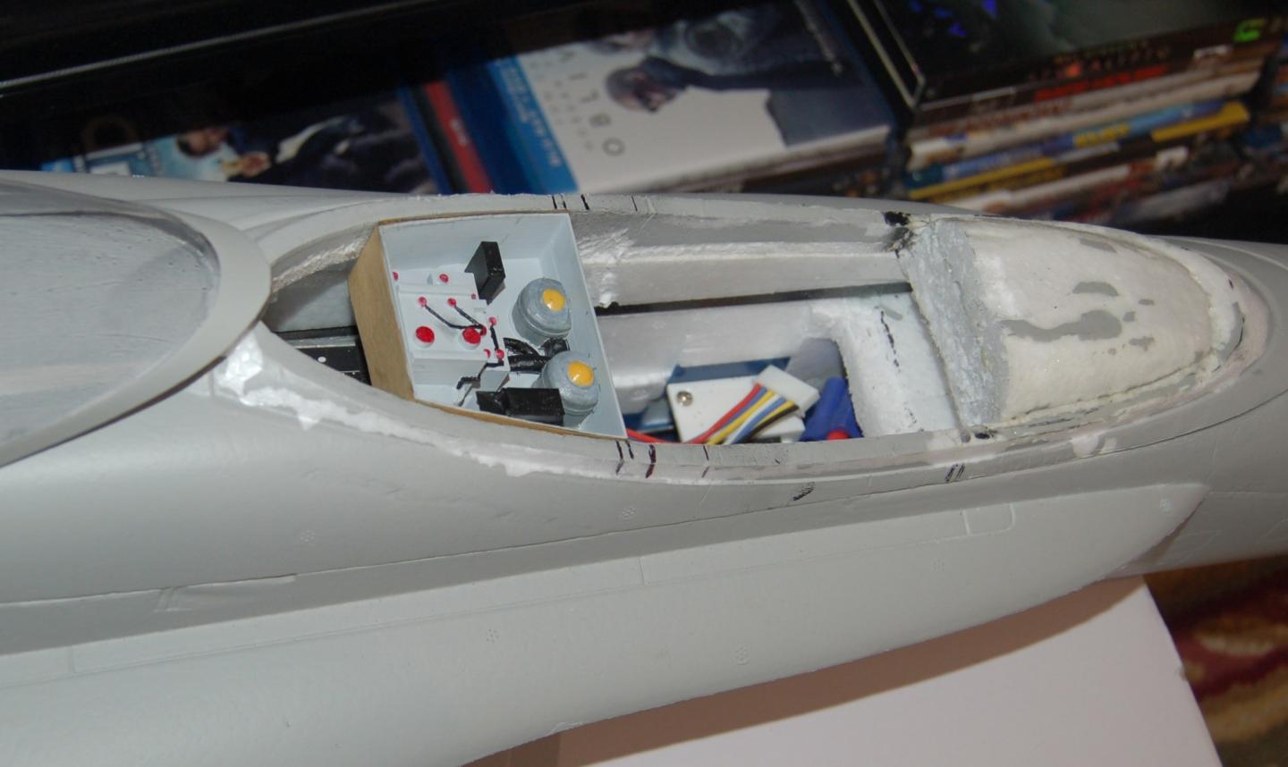

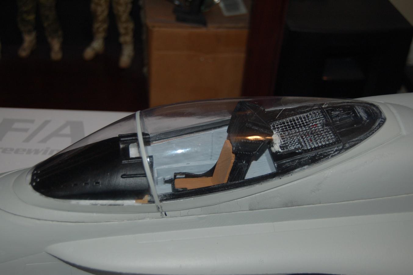

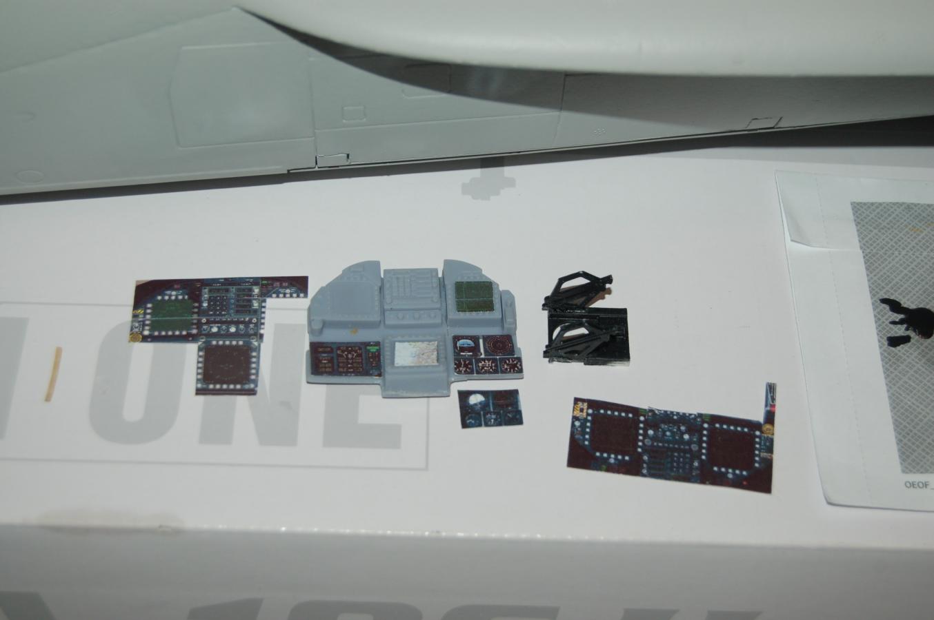

  • Finally got my pieces from RCGEEK. Dry fitted I'm now painting up the parts. For the gauges and displays I copied an instrument panel on photo paper and cut out some of the pieces. The shroud I had to round off to the shape of the canopy to get it to fit; no biggy.
    • Dustman, You are doing some beautiful work on that cockpit. Big Time Well Done, Sir. Best, LB

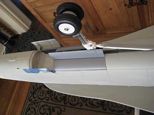

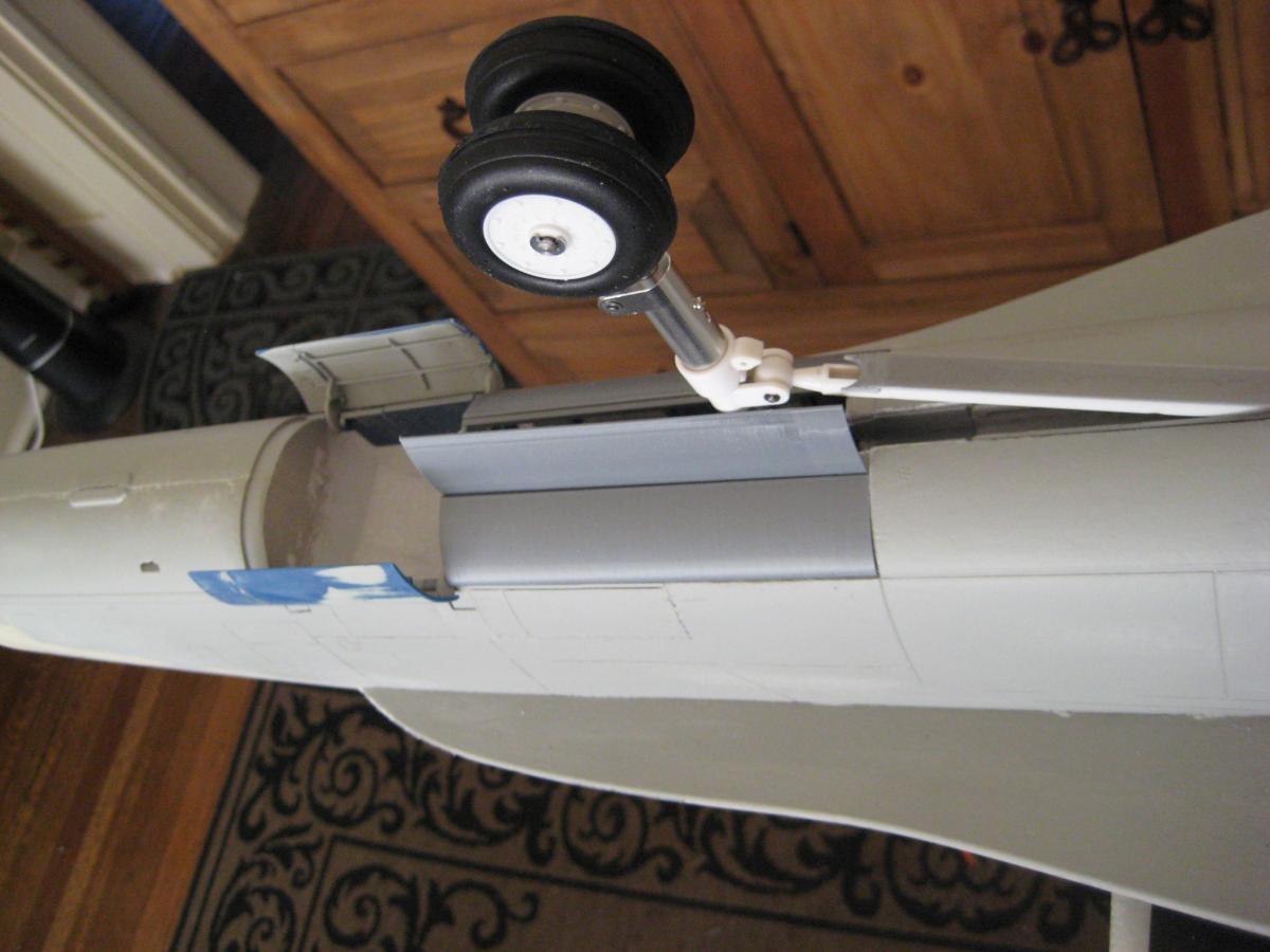

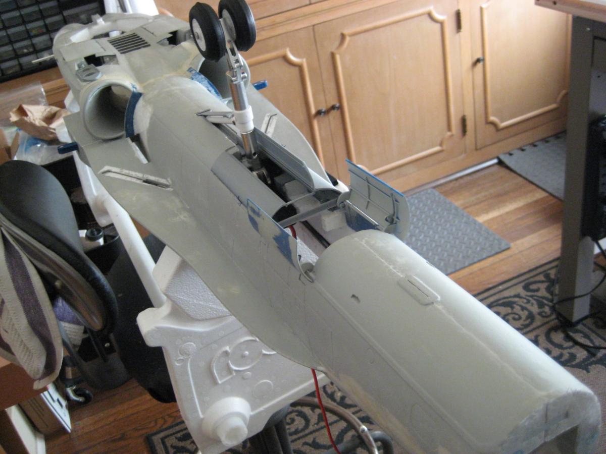

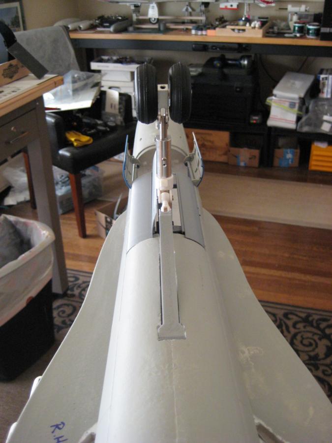

            • Hey Guys & Gals, A little more progress on the NG Door mod. I really like the way it looks now. Best, LB

              • Beautiful job LB!!
                • That looks great! I assume you'll leave the landing light off or change to another style?

                  • GarrisonR, Thanks. There isn't space between the retract motor housing and the strut to put the Landing Light in it's correct location. I've been thinking about smaller LEDs if these are bright enough and breaking out the Dremel...but that might be getting a bit out in the weeds. We'll see as I would like a landing light. Best, LB

                                Amazing work!
                                  Elbee commented
                                  Editing a comment
                                  BP, Thanks, I still have the linkages to finish and I'm trying to use OEM parts so anyone can do the mod with only the strut and drag brace doors as 3DP parts from STL files. We'll see how that goes. Best, LB

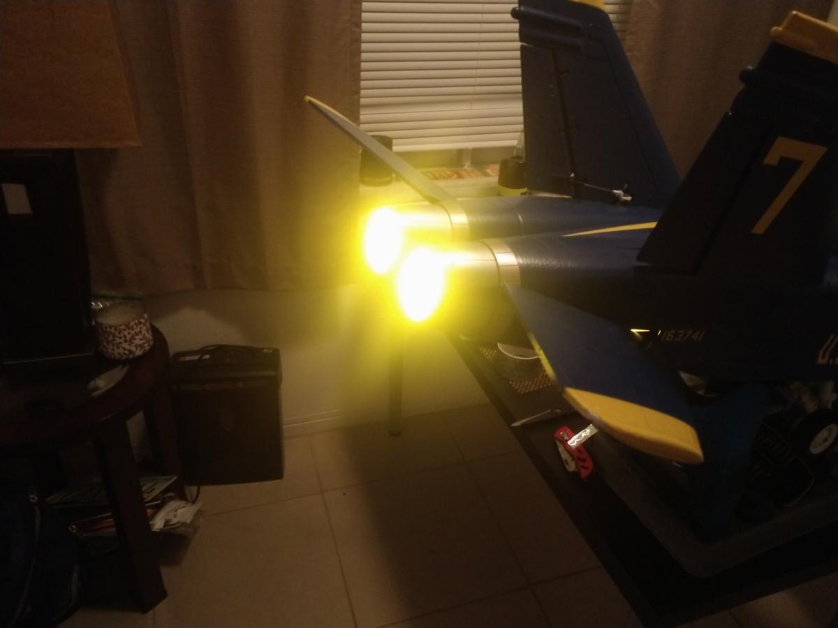

                                • Added foil tape to my Hornet exhaust nozzles all the way up to the EDF, and wow what a difference that made for my Afterburner kit. I wasn't happy with my AB even with dual lights, it just didn't glow bright enough. It's because inside the fuse there's blue painted area's that decrease the light from AB. Now my Blue Angel #7 will look much better during the day. Click image for larger version

                                    BK, now that's bright. Looks great. Best, LB
                                    • Originally posted by Dustman View Post
                                      The door mod is one I would not mind doing.
                                      DM, I have not yet installed any of the parts for the NG Door modification as I am still changing things. As a result, I won't post the STL until those are correct in my way of thinking. I started this mod by purchasing the F-18C Nose Gear and Main Gear "Plastic Parts" from MotionRC. About $12 USD plus shipping. My original idea was to only use those parts so the mod could be done by anyone willing to cut up their model and modify the extra parts.
                                      This mod can be done this way and frankly other than the "Steering Arm" would have been easier. Also, what I figured out was if you're careful, one could use only the OEM kit parts w/o buying the extra parts by buying styrene sheet to make mounts and for the extra doors, but the 'peace of mind' of being able to return to square one if need be helps when hacking into your model. LOL I used Plastruct Plastic Weld to glue all ABS parts together. In this case the 2 NG doors that cover the NG wheels.
                                      Additionally, cutting the L/R NG Door mounts that are glued to the foam of the model was required, but I think cutting the foam away carefully and reusing those worked out well. Gotta use Foam Tac here to join all the parts in their new order. What great product, BTW!
                                      The only challenge really was the OEM Steering Arm shape. The pivot point needed to remain OEM, but needed to be lowered to fit inside the Fuselage skin, so I designed a 'curved' steering, but again stacking say .063"- .125" styrene sheet to get the height and length, then carving, drilling, tapping, and sanding would accomplish what I designed and printed and would create a stronger part, I think. LOL.
                                      My point is 'old school' methodology and a bit of ingenuity can be used for this mod and accomplish what I am doing with CAD and a 3DP printer and require less trial and error. In any event, once I am satisfied with the results, I will post STL files of the mods. Best, LB
