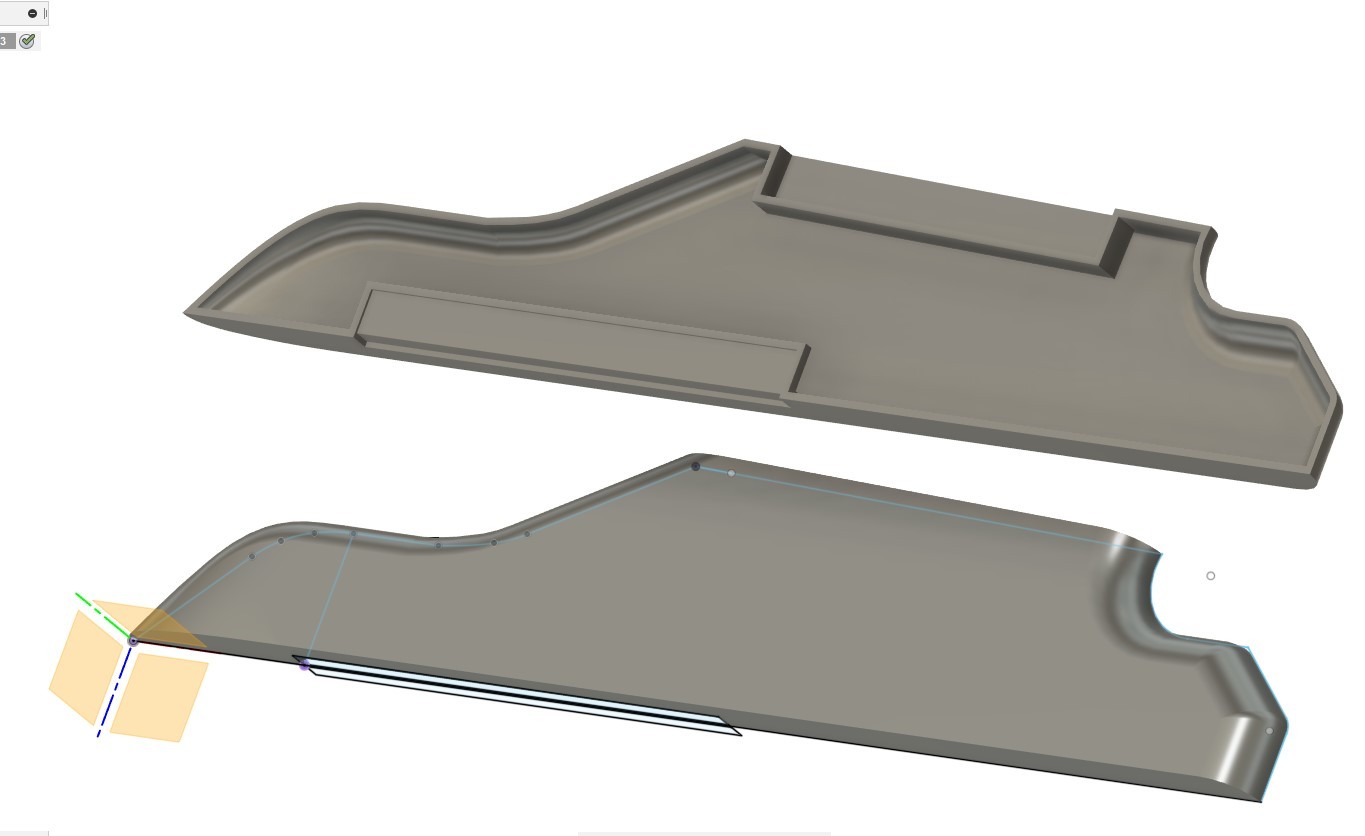

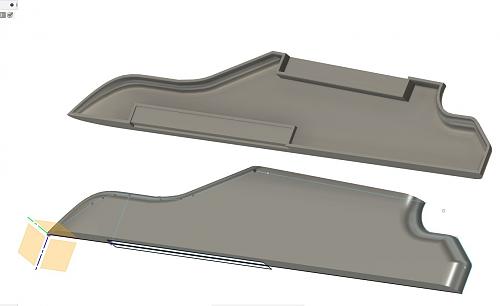

                                      Pardon my ignorance if it has been covered already but has anyone designed the wing pylons for the F-18 to be 3D printed? Anyone know? The tank and centerline mount look great but wondering about for the wings?

                                        Steve, take a look at these files and let me know what you think. I didn't print those yet! The halves have a thickness of 1,5mm.

                                          SAWEEET!!!!! Thank you!
