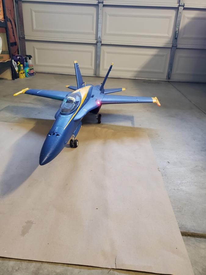

      Jets and Wings and James . Thanks for the tip. I actually had a friend of mine with me. He has a little more experience than I do with simpler planes but wasn't sure about my question about the ailerons and elevators on the hornet. But he flew my plane first and then handed it off to me. I actually didn't do so bad. I guess I'm a natural. I picked up on it pretty quick.
      Elbee I just posted a pic of my Hornet.

        #3503
        Fantastic! I'm sure it will be the first of many more in your future. They are just a tad bit addicting

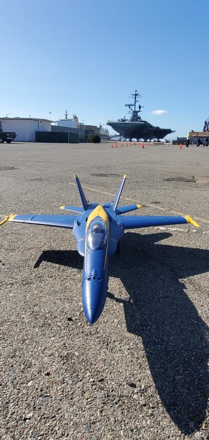

          #3504
          A1, Great looking Hornet. Bravo Zulu, Sir. Congrats on your successful first check flight. Best, LB

                                      #3518
ID:	235774 Legacy Hornet ready to take flight in front of the USS Hornet Carrier

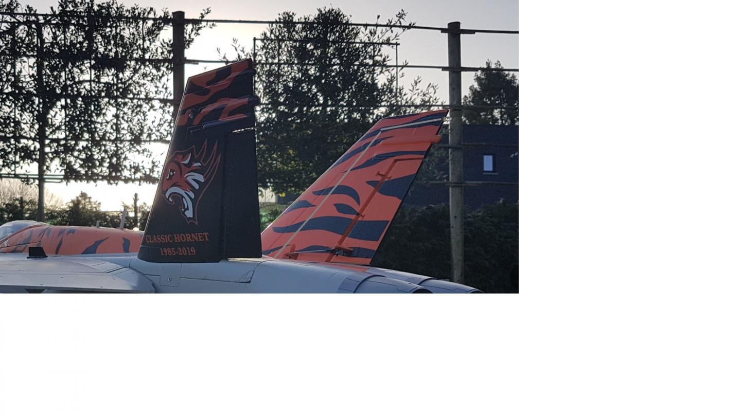

                                        Hornet Howners Hassociation, et al, are there any/many reinforcement doodads inside the Verticals? You know, carbon rods, plywood plates, that kind-o-thing hidden exactly where the Nav Lights, Formation lights and beacons are? Our X-Ray machine is on the fritz and I'm wanting to do some out-patient surgery this afternoon. I just thought I'd ask before blindly cutting up a perfectly good Vert. Best, LB

                                          #3520
                                          Maybe this can get you started. Here's a picture showing where I did cut a groove (grey line) to run the wiring in for the tail ligt and beacons on the rudder, I didn't run in any plastic or reinforcements, it was foam only. There's nothing to be seen of this mod on the front sides of the rudders as all the wiring runs on the back side of the rudders.
                                            Elbee commented
