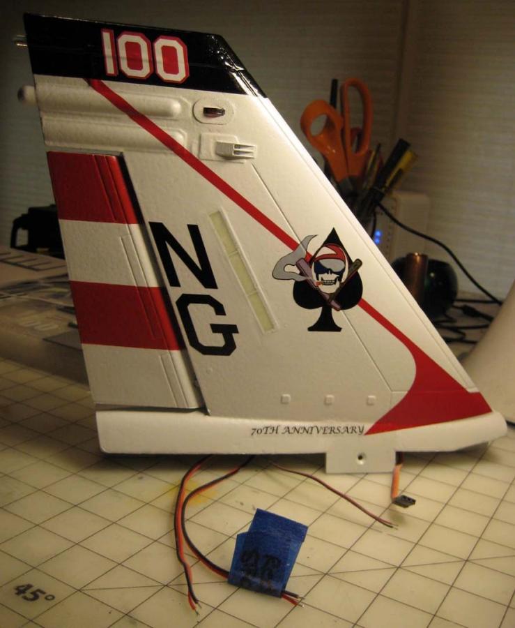

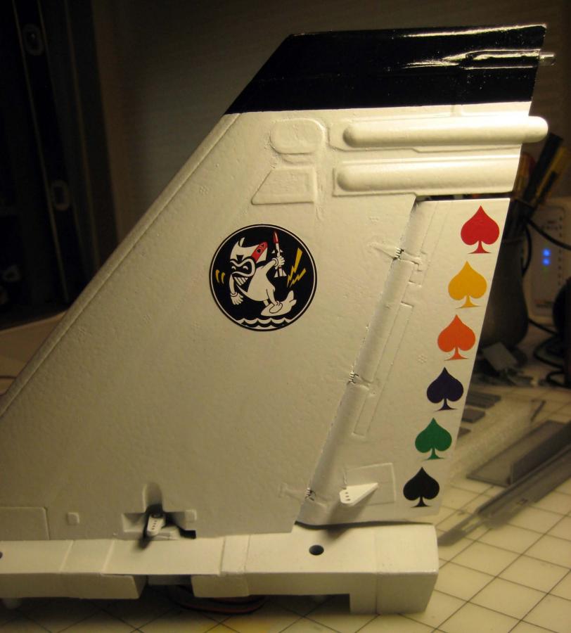

  • Hey all, Now I know why all of you have been posting pics of your Vertical Stabilizers. Been slow goin' over at the LB Hornet Works, but I have finished the RH Vertical. Added the White Marker Light, Back-lit Formation Light, and 'Heartbeat' Red Strobe. Markings are Callie Graphics and the livery is 70th Anniversary VFA-41 Black Aces CAG 100. One down, one to go. Best, LB

      Hey all, Now I know why all of you have posting pics of your Vertical Stabilizers. Been slow goin' over at the LB Hornet Works, but I have finished the RH Vertical. Added the White Marker Light, Back-lit Formation Light, and 'Heartbeat' Red Strobe. Markings are Callie Graphics and the livery is 70th Anniversary VFA-41 Black Aces CAG 100. One down, one to go. Best, LB

      OUTSTANDING SIR!!!!! Can't wait to see the final finished product. With your canopy and pilot mods, this could be the "pride" of the fleet. Of anyone's fleet!

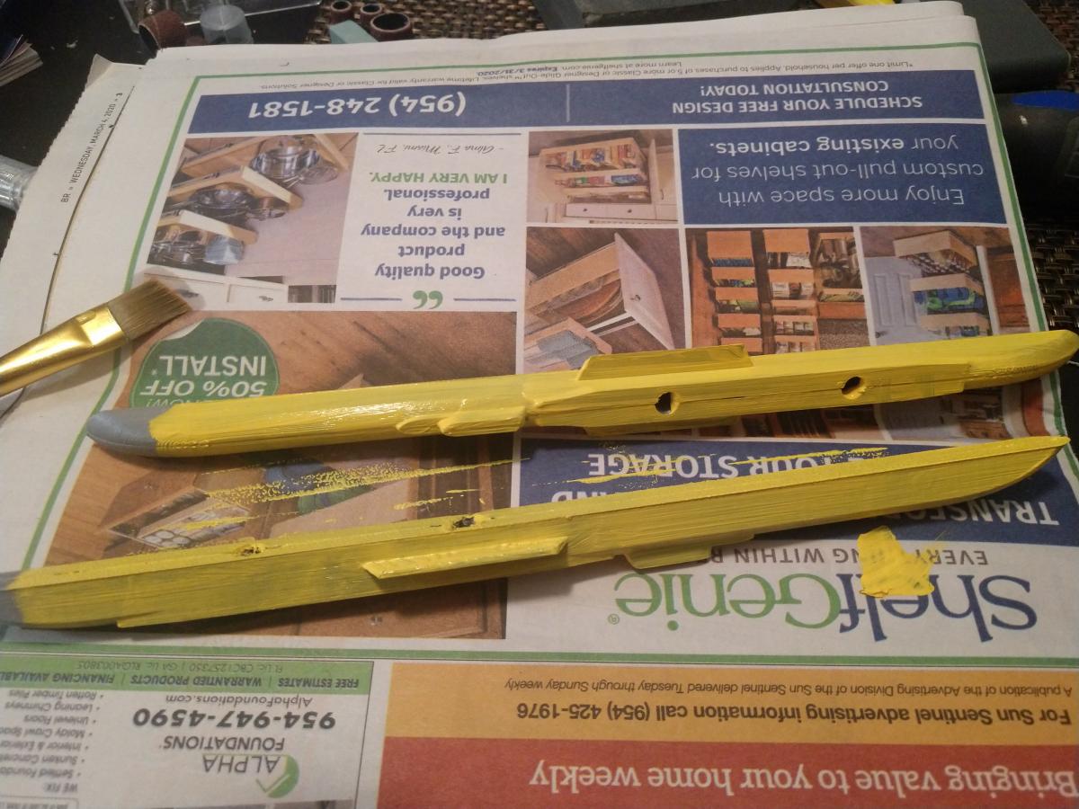

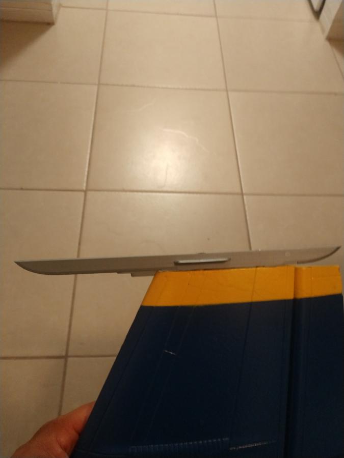

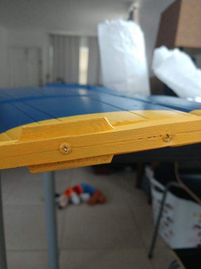

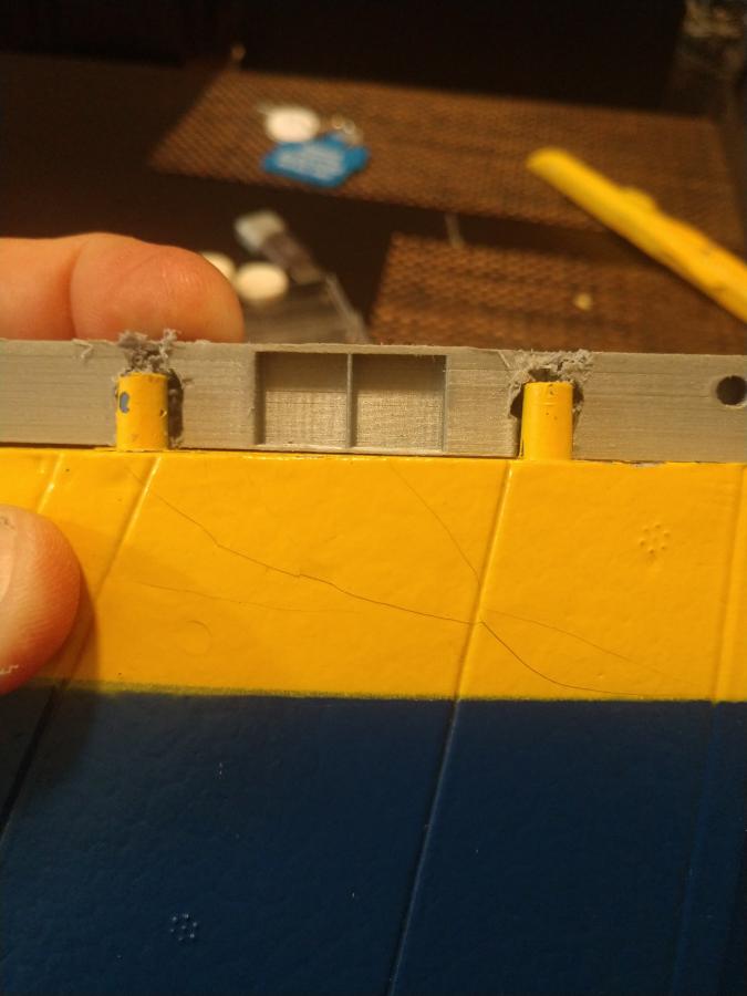

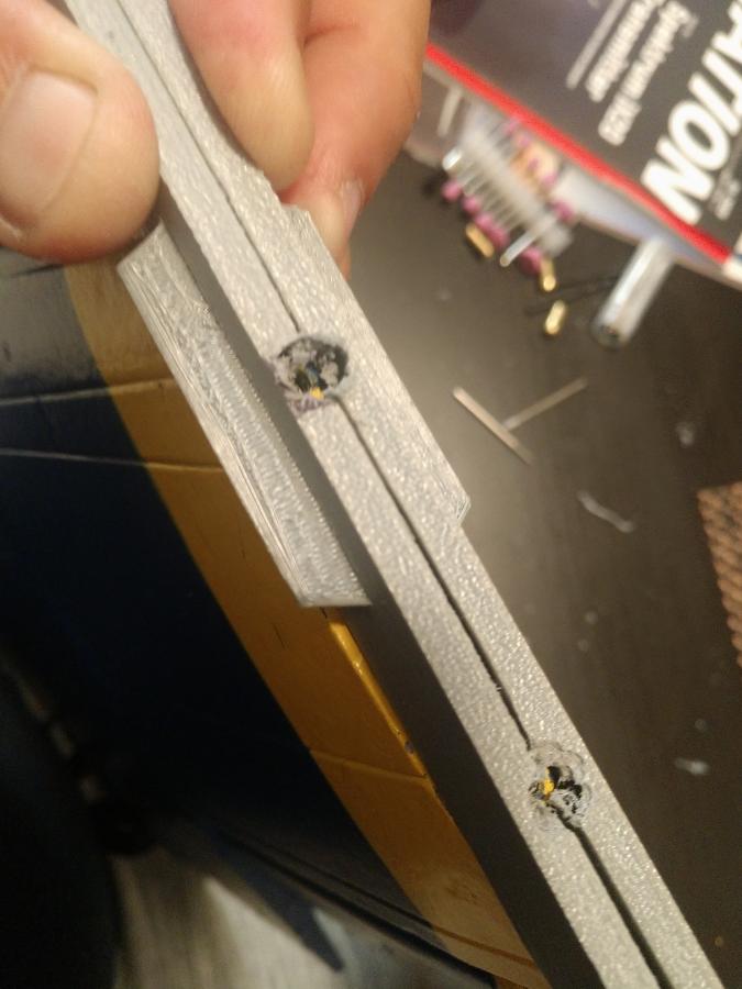

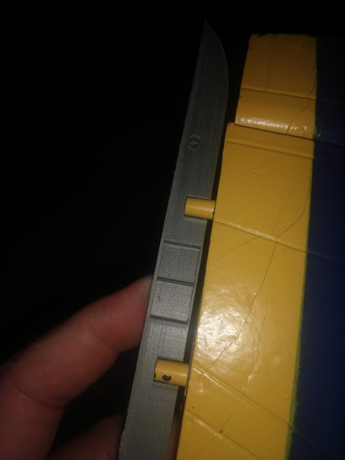

        • 3D printed rails:. So after careful examination and planning I completed the 3D printed rails project. The files were available on this forum (a few pages ago) And those files were printed by Elbee Gracious thank you for help getting this project done. First off I tested the strength and rigidity and these printed rails are super strong and lighter than OEM. They will not snap or break as easy as the OEM.

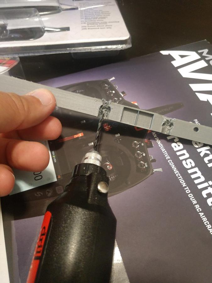

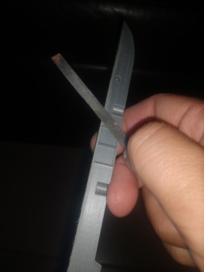

          However the screw holes must be drilled, the holes are half done, you must complete the job with a small Dremel kit. The rails are cut in 2 half's, and must be filed flat before trying to glue them together. The way I did it was by joining one half of the rail with the wing as shown, if you look at the before and after drilling you can see a small gap between wing and rail. The screw needs to sit on a flat spot in order to tighten. I kind of messed up the first rail by drilling a bit too much on the outer part (but I repaired that by using a another screw with a wider flat head).

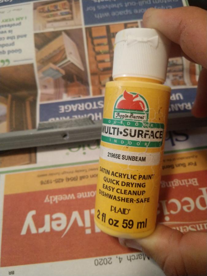

          After test fitting the rails to make sure it fits flush I glued them together with super glue gel. I then used acrylic paint as shown from Walmart for .79. That one matches best. Once again thank you all for your help, the show is this week and I will now have the F18 C model ready to fly at Florida Jets!

            Truly outstanding job! 👍🏼 Love the livery scheme! You're gonna love the Hornet it is as cool as any jet I've ever flown!

                I've mentioned to Alpha that it would make sense to have FW offer these rails as a separate SKU item instead of only being available with the wing set. Hopefully they make that addition soon because they are easy to break. I could use a new set myself.
                Please please please make this happen!! They have kept my wings from getting damaged in cross wing tips but I would love to have a couple spares!

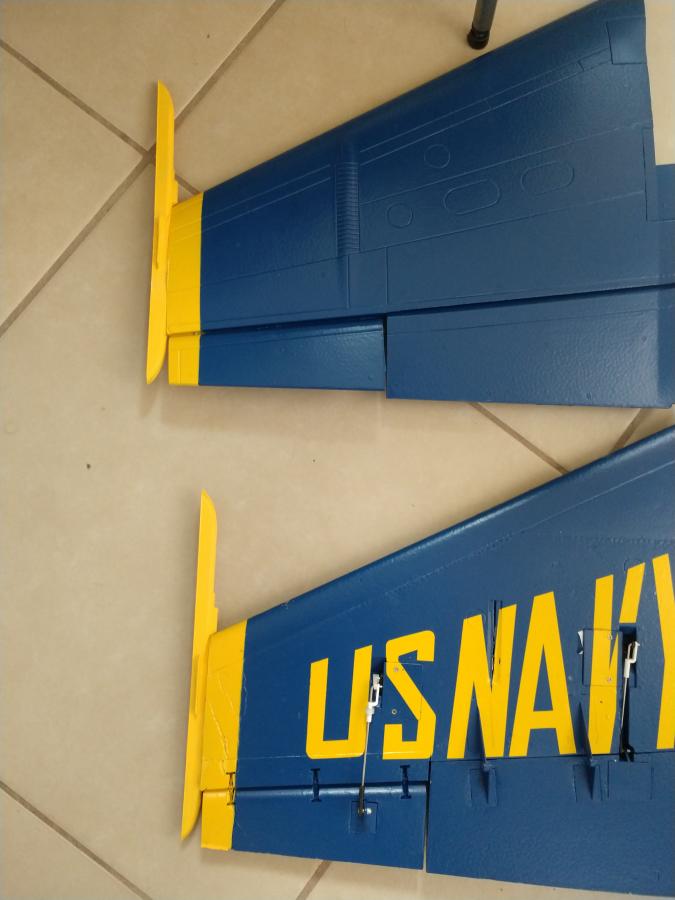

                    So the outer part on the rails which hold the screws just need about a 2.5 or 3mm hole. The inner part that inserts the wing also needs about 2-3mm more space to fit. Final product, looks fantastic Click image for larger version

                      Looks awesome, looking forward to see your F-18 finished!!!

                        Thank you, JW. I, too, am looking forward to seeing the finished airframe. LOL Best, LB
                      Brinka, When you get back and if you'll make the time, would you be willing to sketch out what is needed to make the part perfect and I'll adjust the STL? You can PM me at that time. Best, LB
                            I will indeed, will have to measure properly, but for now they look fantastic. Just need to make those holes on the file. I'm surprised at the strength, they will last a long time!
