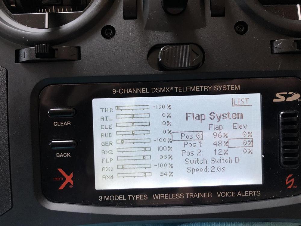

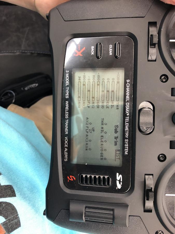

      You should have 0 for the half flaps and then subtrim the horn to center it. The us the - and + to get the proper up and full flaps. As you have it you are using less than half of your servo travel and only one direction.
      Are you in a club? Do you know someone that can help you properly set up a radio program? Not to be harsh but that's a messed up set up.
      And why -130% for throttle? If you have your throttle cut at 130% that's wrong for electrics, it should be -100%. If you turn on the radio and airplane with the throttle cut and then take off the throttle cut it will throttle up with the throttle all the way down. Not good.

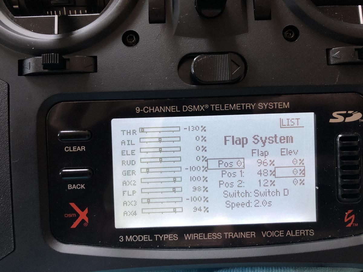

      Click image for larger version  Name:	image.jpg Views:	0 Size:	126.6 KB ID:	203194
      Here’s my % compare them to yours?
      • thisguy65
        • 509
        #1583
        Mine have always started spinning up as soon as you move the stick. I dunno? Once I calibrate the esc and it works. Throttle cut off is -100 to 100
        Yea I’m in a club, near Fayetteville. Just what I was taught in eflite manuals.
        I’ll try the flap your way. You are referring to the subtrim under the servo tab?
        steps for flaps
        1) set flaps position 2 to 0
        2) adjust control horn so it points down
        3) eyeball the linkage to get to take off flaps, and install linkage. Move flaps position % to fine tune for take off flaps deployment
        3) adjust flaps % for flaps up and landing flaps
        sound right?
            -130 is default throttle cut value on spektrum (answers the why)
            For most escs that is perfectly fine as long as initial throttle range calibration is done with cut off so correct range is stored.

              -130 is default but not what you want for electrics. It's what you want for a glow motor.
              If you calibrate your ESC at -100 and 100 which is normal and then plug in with -130 it start running when you turn your throttle kill off. There may be some ESCs that don't do this but it's a safety hazard. Everyone should change the default to -100 when they set up a new electric plane.
                I agree that - 100 is a more sensible choice, but you are wrong on the last part. Most ESCs will not adjust the range once programmed, and they enter programming by being powered on with full throttle only. So most ESCs will handle a mix of - 100 and - 130 just fine.
                I don't agree on this being a safety hazard since an esc will either handle it or not (have seen plenty examples of both). There is no randomness or unknowns here.

                  1) set flaps switch to position 1 to 0 (half flaps).
                  2) adjust subtrim in the servo menu so control horn points straight down.
                  3) eyeball the linkage (and adjust it) to get the correct take off flap deflection, and install linkage. You should not have to adjust the flaps position % to fine tune.
                  4) adjust flaps % for flaps up and landing flaps.
                  Ideally you should end up with flaps up at about 100% (or -100%), mid flaps at 0% and full flaps at -100% (or 100%). If you need less than -60/ 0/ 60 you should move the linkage to a hole closer to the center on the servo. This allows you to get the best mechanical advantage so the servo works easier.

                    At my field maybe 10% calibrate their throttles, about the same KNOW how t do a range check, maybe half check balance before they fly their new plane... There are a lot of unknows.
                    The -130 is a safety hazard.
                    You understand the differences, most don't.
                      What we can definitely agree on is that ignorance is a safety hazard 😂

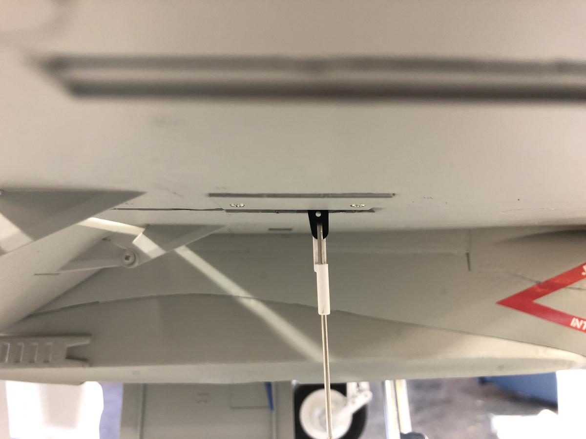

                          Flap and elevator I did move the linkage in one hole. Here’s servo with no sub trim.

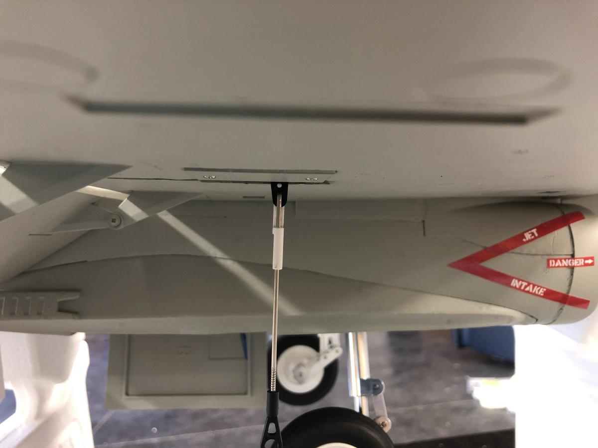

                            After setup of control horn

                                Looking good.
