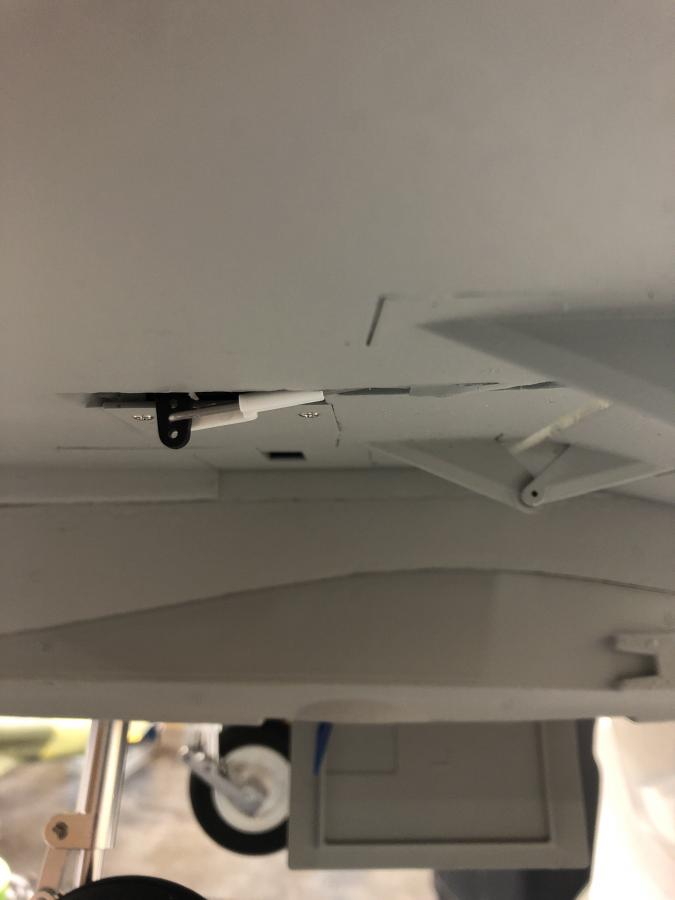

        I suggest you move the push rod closer to the center of the servo. At least to the second hole. If you can go to the inner hole but it may bind at that point. The idea is to use more of the servos throw to get a better mechanical advantage.

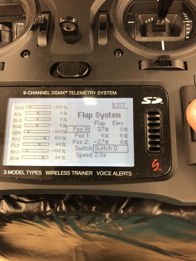

          -130 is default but not what you want for electrics. It's what you want for a glow motor.
          If you calibrate your ESC at -100 and 100 which is normal and then plug in with -130 it start running when you turn your throttle kill off. There may be some ESCs that don't do this but it's a safety hazard. Everyone should change the default to -100 when they set up a new electric plane.
          I’m a noob and all of my planes have the throttle cut at -130. I have the -100 and 100 range and none of my motors will start running when i turn throttle cut off.
          Is is it a spektrum thing? I have no clue lol.
            Doesn’t look like it will word. Buts it better than being at the very bottom like factory/book

                            you have those flap servos set up all wrong in my book. They should not be that far forward, their binding just trying to move.
                              How itvwas from the factory

                                      #1618
                                      Yeah it's a Spektrum thing.
                                      Most ESCs handle the combination of -130 and -100 just fine, which is why you haven't noticed any problems.
                                      However, some ESCs will redefine the low throttle value each time it initializes (most ESCs only ever do this if powered on with full throttle to enter programming mode). So if the ESC decides the new low throttle level is -130, and your radio then jumps from -130 to -100 when you switch off the cut, you get the idea of what will happen :D Fair enough, it is only still about 15% throttle, but with a sharp propeller that can be bad enough.
                                      As Evan says, using -100 as value for the throttle cut function is by far the best practice for electric models.
