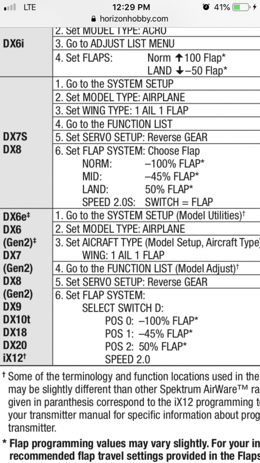

          Click image for larger version  Name:	89AF66DD-7B22-4E90-8975-A2659A6F2006.png Views:	0 Size:	425.4 KB ID:	203396 Coming from Eflite planes, they have the % for flaps setup in the manual, starting from -100. The horn was always deflected close to end travel and commands would move it toward center. Applied this across the board bc I thought was right
          attach is manual from viper

                  I did have to remove the servo and had to center the horn to the servo on factory servo
                  I’ve found Eflite aircraft to be weird in some ways. You’ve also seen this with the throttle thing. I believe they are what they are because most of their planes (and quads , helis) are RTF or BNF and as such, their PNP models are set up the same. They were either already paired to a TX that comes with it or are expected to be paired to a Spektrum TX.

                                Just picked one up and maiden it at the house. The manual is wrong regarding the flaps. Had to fix the flaps the same way Evans mention previously.
