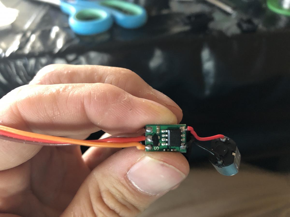

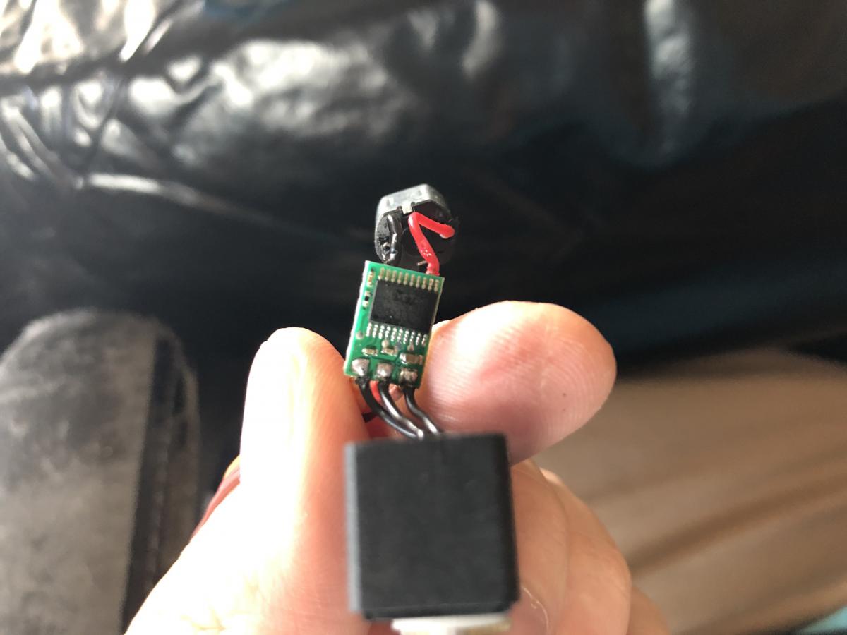

                  BEC measured at 5volts dead on
                  Luckily I had some Freewing 9gram servos. Just had to shorten the lead.
                  picture of the servo with the germlin
                        I'm assuming this was the flap servo you replaced? If so, a word of caution. Not all servos are created equal, so if you're replacing a servo that is Y'd to another servo for flaps, ailerons, dual elevators or dual rudders, you typically want to have matching servos so that throws are the same.

                                #1575
                                Hey Pat, the replacement is the same just longer
                                lead. However I shorten it up to 100mm. Co firmed part numbers. I did notice the servo gear that the horn goes in to is a brass color on the model and nickel color on the new one
                                thanks for looking out!
                                  OK, just making sure. Sounds like you're good to go.
