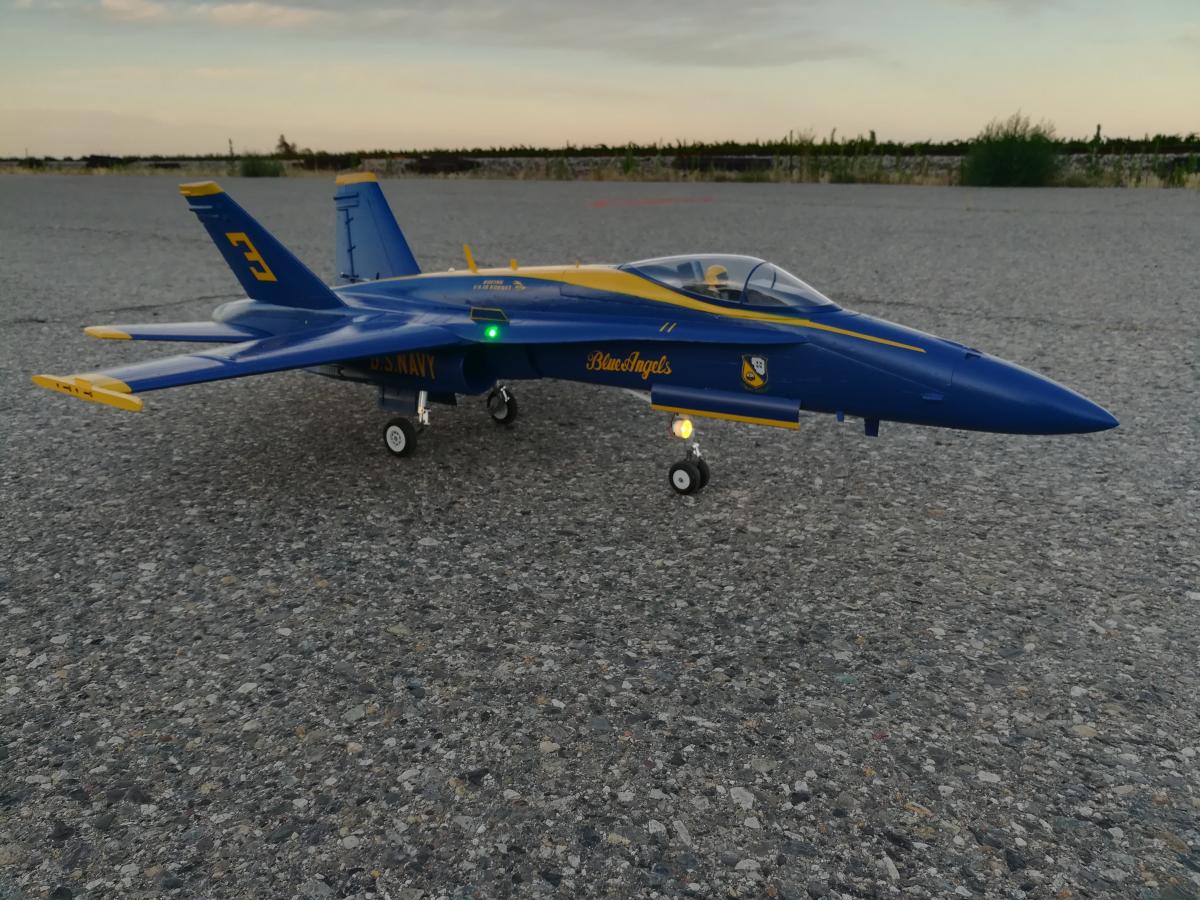

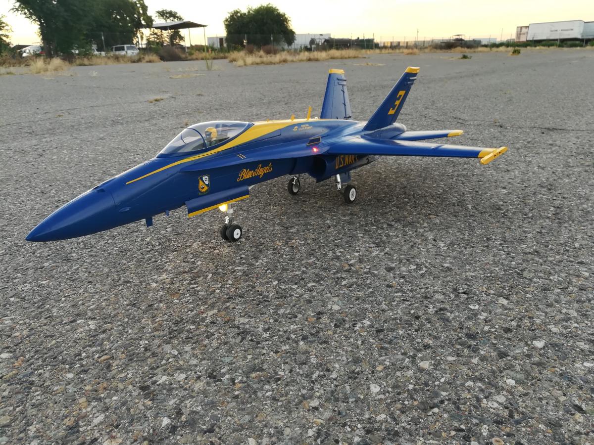

          I maidened the B.A. version today. I’m flying with a Specktrum DX8, Admiral RX600SP and a HRB 6s 5000 mah. All control surfaces, CG, rates and without bypassing the BB were set up per manual and a range check was performed. The maiden was successful. A few clicks of up elevator and left aileron and she was hands off flying. The maiden was flown 1/2 to and 3/4’s throttle. Plenty of speed! After trimming and a few cicuits I deployed gear then low rate flaps as per manual. I did notice a slight nose down attitude and when I deployed high rate flaps the sink rate was more prominent. Flaps set per manual. I may add a flap/elev mix but will wait as I get used to flying the F-18. Landing was spot on! Second flight was way less nerve racking and enjoyable. Set up for landing after 3:00 mins of 1/2 to 3/4 throttle flying in the pattern and had another successful landing. Battery was at 32%. I did notice on both flights it takes a few seconds after roll out to get on step and she tracks well on take off. Hope this info is helpful.

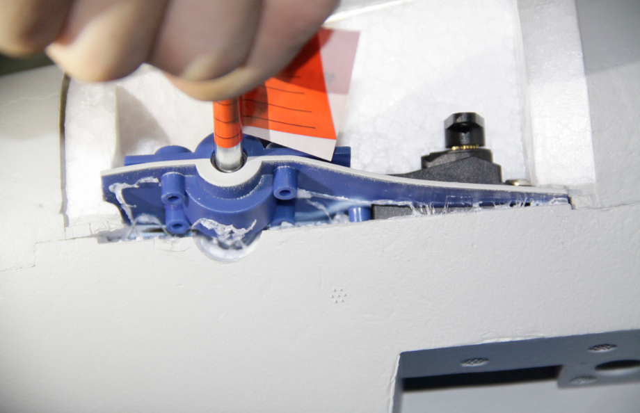

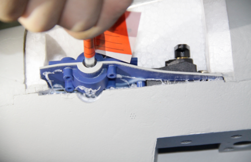

                        We called in the flight team over the weekend to assemble and fly a dozen randomly selected F-18s. Spektrum DX9+Admiral 10ch rx, Futaba 8J+R2008 rx, FrSky X10+X8R rx. Eleven of the twelve models were flown 19-20 times, stock 6s PNP system, Admiral 6s 5000mAh. Aggressive flying. Consecutive rolls, full power dives and loops, everything we could think of. 213 flights over two days, no issues for eleven of the twelve models. Receiver function, MFCB function, servo function, structural integrity function. No problems.
                        However, one of the twelve models, on its 14th flight, during a full power corkscrew spinning dive straight down from ~600ft to ~100ft, had its port side plastic elevator mount lift up slightly during pulling up from the dive. Not enough to come loose, but enough to roll the aircraft over during the full up elevator pull-up to recover from the intended spinning dive. The model rolled over twice as its nose pointed upward (recovering from the dive), the pilot reduced all power, then glided back to the road for a short-field landing. After taxi back, the elevator linkage was still attached and the elevator still moved, but the mount was sloppy and had to be reglued down before its next flight.
                        I would not describe that flight pattern as normal --it's irresponsible. Nevertheless, we took that data point and spent this evening opening 203 F-18s at the factory trying to replicate the failure. We calculated the approximate force on that area during a pullout, then tried to pry up the elevator mount. Of the 406 elevators tested, only 2 of them were able to be pried up with between ~7lbs-8.5lbs of hand applied pressure against the elevator rod (~116oz and 133oz). This prying force applied during testing on the F-18 elevator rod is higher than the force tested on the F-14's and F-22's elevator rods, so again I would consider that above normal use.
                        So, data summary for this weekend's testing is: 12 newly assembled planes flown, 227 flights without any issues, 1 flight with 1 partially lifted elevator mount, 203 planes checked manually at factory, 1 elevator mount able to be manually pulled up with similar force. This is in addition to the hundreds of flights conducted during prototyping/production/destructive testing phases, which are conducted before the first shipment departs Asia.
                        Preliminary Result: No pattern established for physical failure points. One logged failure in 2,348 minutes of logged factory test flights. Flight testing continuing to try to replicate customer-reported crashes.
                        Action for existing customers: As an additional precaution, that statistically is frankly overkill based on the data so far, you might want to check your elevator mounts by gently trying to pry them up. There's a large plastic foot so I don't expect them to tear completely up. If you detect any lifting, take a photo or video and send it to the CS Team. If you can pull the mount up halfway like this with a three finger grip on the elevator rod exerting anything less than 7lbs of force, call the CS Team immediately and feel free to post here. It's a large plastic foot so a complete tear-out would likely crack the plastic. Reglue as needed.
                        Click image for larger version Name:	F18C 196 -SB- 116 ounces -6.24.2019.png Views:	0 Size:	687.9 KB ID:	202373

                          Checked my Elevator mounts this morning before I went up for another flight, didn't find anything loose on mine, did notice there is a a little slop in the rod and plastic bearing but nothing to serious, also noticed after looking over the manual, 9g servos for those big flaps??. Got the decals and gloss coat on it, does look nice, anyway the flight went great, no issues, went back to the stock flap settings is all I did, didn't get no sudden rolls or dives to mother Earth...:)

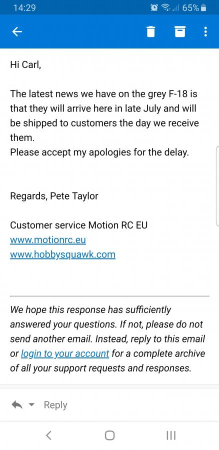

                              From an extra 2 weeks on ETA. To an extra 4 weeks! Has the container ship sunk or run aground somewhere?
                              Not a happy bunny ☹
