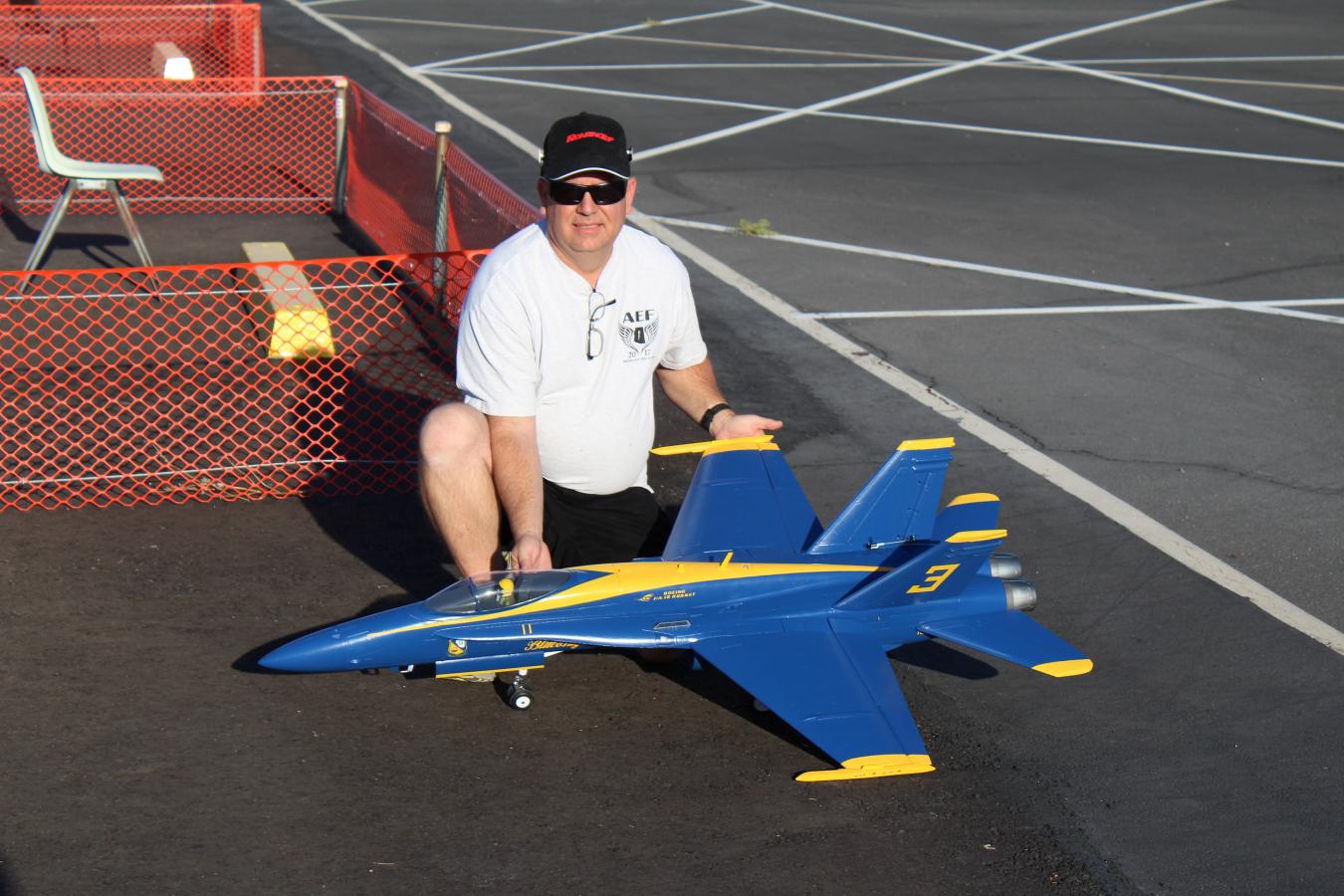

                              • Here's a pic of mine prior to my 3rd flight this morning.
