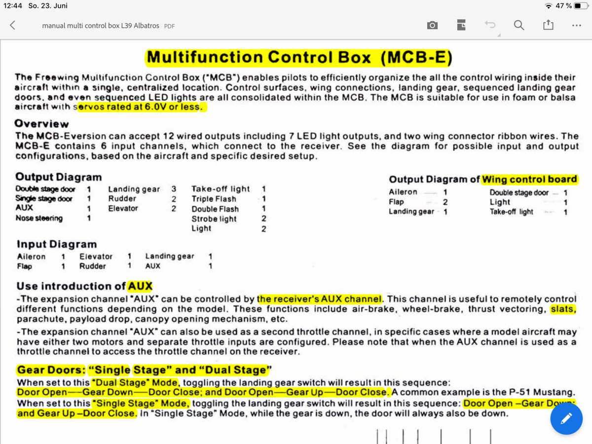

                                        I put this on the F-18 thread on RCG in response to someone who said he proved his MCB-E is faulty and not because of RX compatibility. Figured it may do some good here too.
                                        So far I have had the L-39, F-22 and F/A-18C with the MCB-E. Prior to the F-18 I was using a JR XP9303 converted to 2.4GHz using XPS. I had an XPS Nano RX in the L-39, and the XPS Nano RX with the X10 channel expander board in the F-22. In the F-18 I went straight to Graupner and did not have any issues at all with the MCB-E.
                                        On the L-39, everything worked fine with the gear up, but rudder and nose steering stopped working with the gear down. Sometimes the rudder and steering servos would twitch on their own as well with gear down. Bypassed the MCB-E for rudder and nose steering and went direct to the RX and no issues up until the point I sold it a few months ago.
                                        On my F-22, same as the L-39 everything worked fine with gear up, but as soon as you dropped the gear the rudder and nose steering servos went wild, deflecting rudders up to 8mm. They still moved with stick input, but were chattering like crazy. Once again I bypassed the MCB-E for rudder and nose steering, and everything worked fine.
                                        So I've been meaning to move the F-22 over to the Graupner radio, and decided first to try a little experiment. I got 2 great flights on my F-22 this morning still using the XPS setup with rudder and nose steering direct to the RX. I just went back in and hooked everything back up stock with the XPS RX, and once again rudders and nose steering are acting crazy. So I then stripped out the XPS system and put in a Graupner GR-16L RX. Now everything is connected to the MCB-E and lo and behold everything works perfectly.
                                        This tells me the MCB-E in my F-22 is NOT defective. What I believe the issue is, and I have put forth this theory before, is that the MCB-E is sensitive to voltage input from the RX (and yes, I consider that a problem, but it won't be fixed by getting a replacement MCB-E as I went down that road with the L-39). I'd be willing to bet that the voltage output from my XPS RX is higher than the Graupner, and the MCB-E doesn't like it. So if you're having issues with your MCB-E ("blue box" or "BB"), just unplug the rudders and nose steering from the MCB-E and Y them direct to your RX. I bet that would solve 99% of the problems people are having with it.

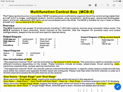

                                        Could be the reason, as the Manuel says max 6V.
