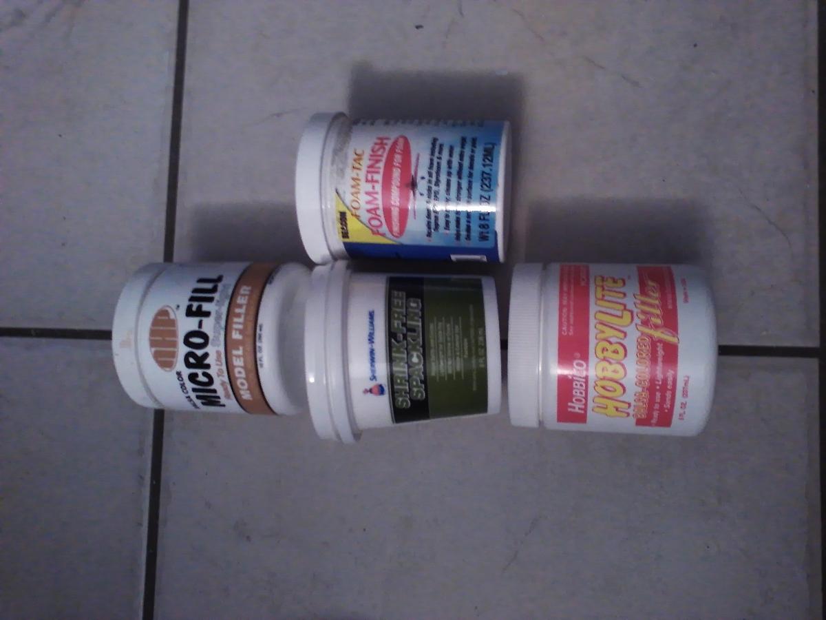

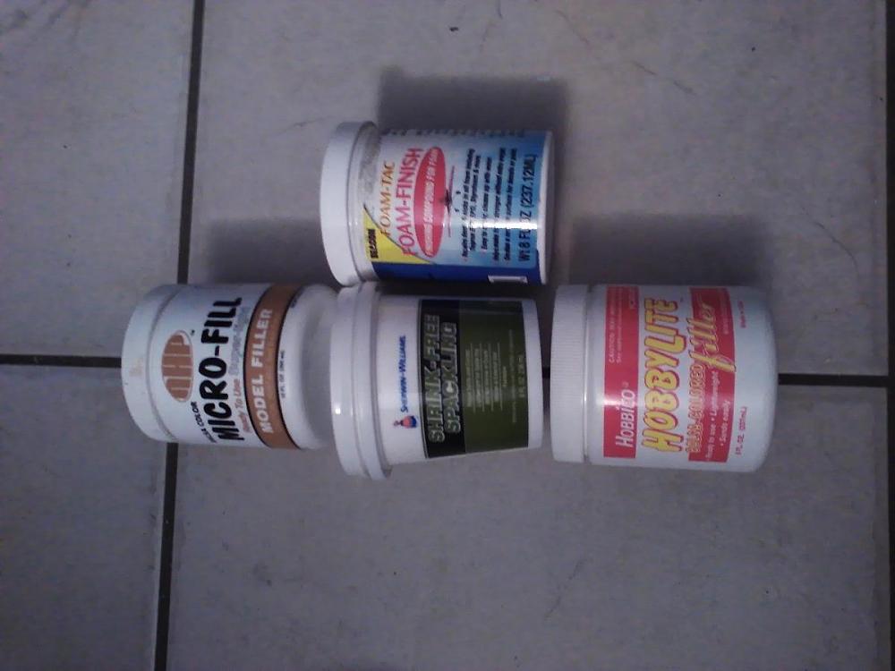

                  Indeed !!! Though there is a lot of shrinkage with it, and when this stuff is Painted on, there tends to be a lot of absorption leaving a porous and sunken finish !! When I do use the HobbyKite , I will apply Thin CA over it before painting and that really locks it in nicely. The 'Sherman' is a better filler on EPOJets for most applications !!! Hahahaha
                  Click image for larger version  Name:	IMG_20171217_082716.jpg Views:	0 Size:	72.5 KB ID:	206890
