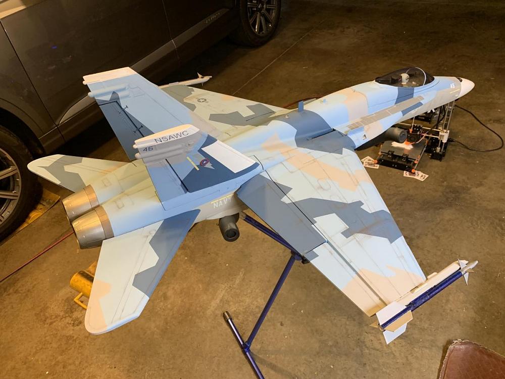

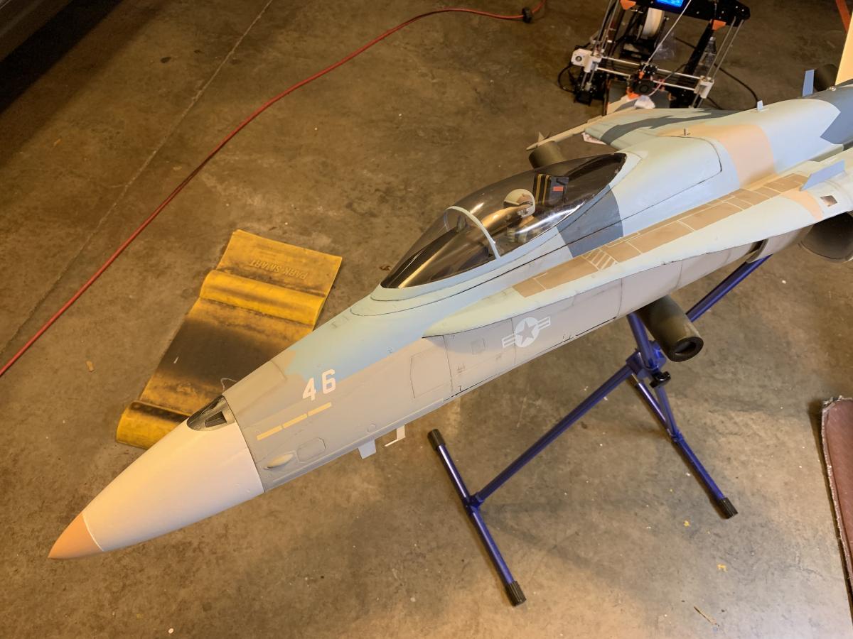

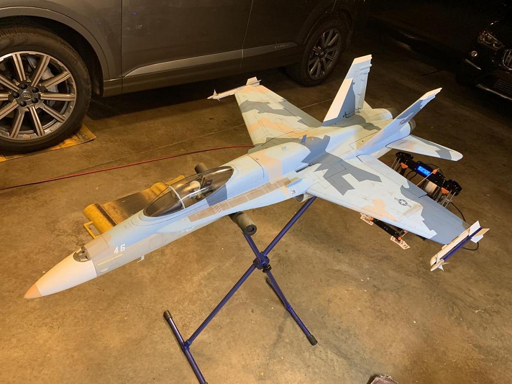

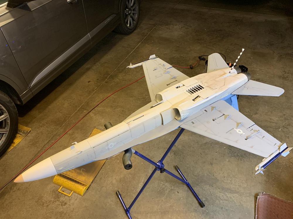

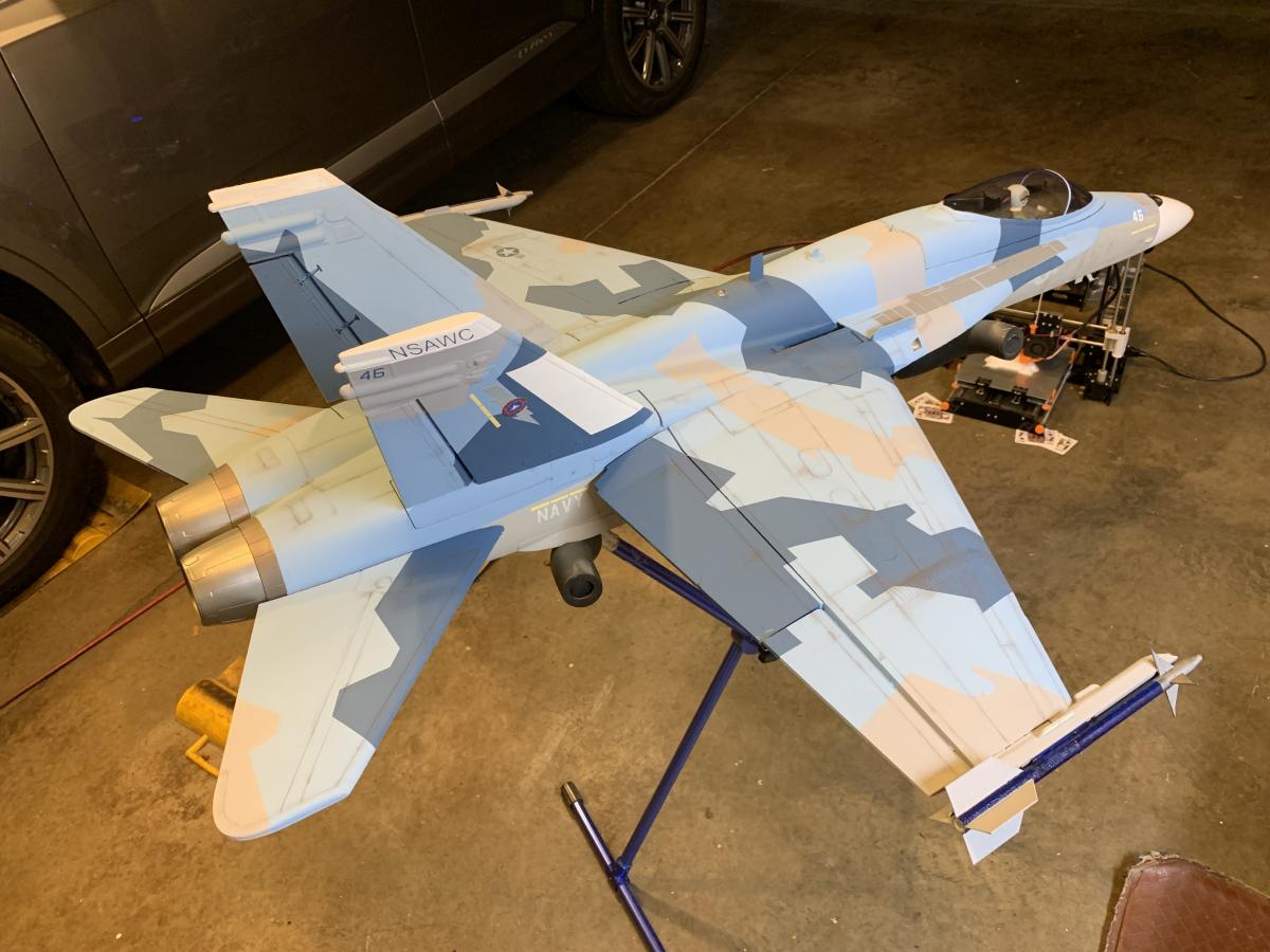

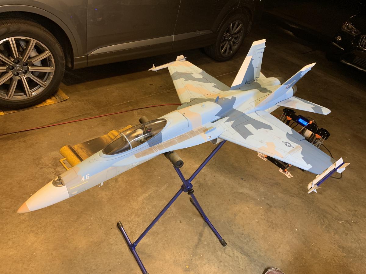

                      I’m calling the repaint “done.” Now, back out to the line it goes for more flight ops. Click image for larger version

                        WOW!! Well Done
                          • 4873
                          #2412
                          V, Wow, is right. Bravo Zulu, Sir. Best, LB

                            Very nice job!
                              #2414
                              Nicely done! Love it!

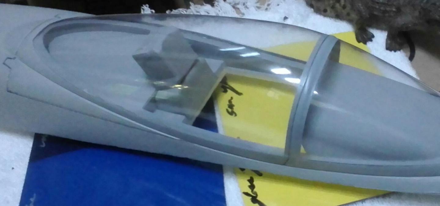

                                I've Posted enough of these pictures to emphasize my thoughts on the thin 'Canopy' rail on this Jet. I must be the only one who has a problem with this. I'll post these again just in case they were overlooked by anyone striving for Scale Accuracy ... If I have offended , I apologize. I'll just have to keep things like this to myself from now on. Click image for larger version

                                I simply cannot understand how someone could bring a Jet in for paint, do such a painstakingly Awesome Job on it and not widen that Rail in the process... we're looking at maybe 5 mins work on that. Click image for larger version

                                  Ha! There’s a lot more wrong than that. I’ll blame the beer for missing that one. Of course it’ll have to be fixed, because now, I won’t be able to “unsee” it.

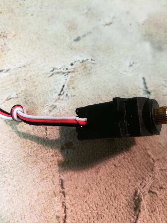

                                    Just took my Blue Angels elevator servos out to check for frayed wires and found the reverse servo has been cut, elevator mounts are good, sure glad I stopped flying it until I had time to check them, got 39 flights out of that frayed servo wire.........
                                    My grey one is grounded until I can get to it and find out if I find another bad servo wire on it.

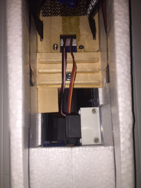

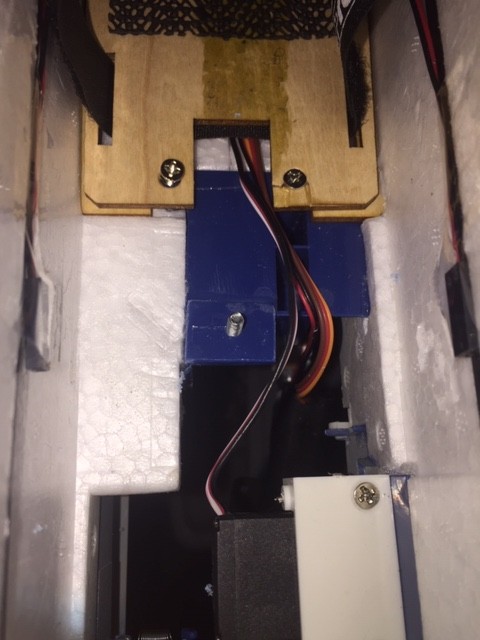

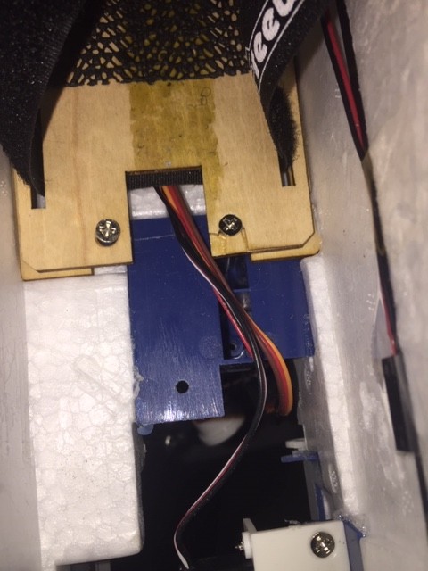

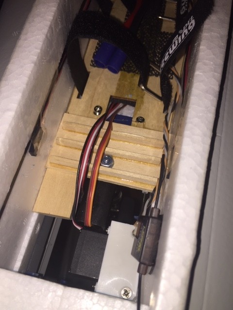

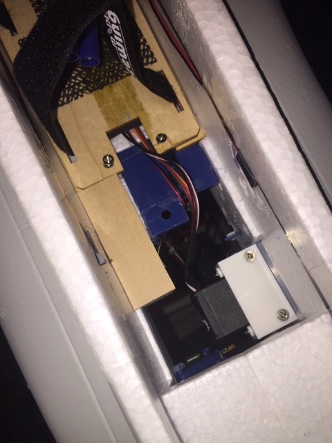

                                      After some rough landings, the nose retract mount started to separate from the foam to the point where the retract no longer closed the spring-loaded doors. Using the included adhesive and applying a shim remedied that, but didn't seem like it was a lasting solution, so I installed a brace plate.
                                      • Removed the retract from the housing and drilled a hole to fit a flathead #6 machine bolt.
                                      • Took a piece of thick plastic with the same width as the mount, sanded the joint surface, then applied a thin layer of cyanoacrylate glue and clamped them together, applied additional glue at the seam to seep in by capillary action, then let it set. Then I continued drilling the hole through the additional plastic piece, then carved with an hobby blade so that the flathead sank flush to where the retract sits. The plastic block now provides additional strength and spreads out forces applied over a wide area.
                                      • Because the foam "ledges" are uneven, I placed a wooden shim to make them even.
                                      • Measured and cut a birch plate and epoxied cross-beams to stiffen it. Positioning it so that the screw would be centered between cross-beams, I drilled a hole to line up with the hole in the mount. I then slid the flathead bolt up through plastic and wood, installed a washer and bolt, and tightened.
                                      • I then finished it with some blue threadlocker to resist gradual unscrewing from repeated shocks and vibrations.
                                      • Test the retract to confirm the doors close, and did some final rod & clevis adjustments to completely close the door gap.
