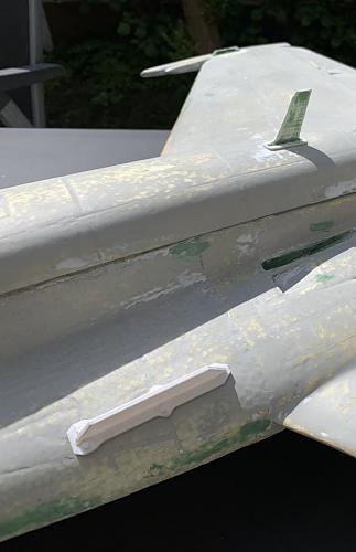

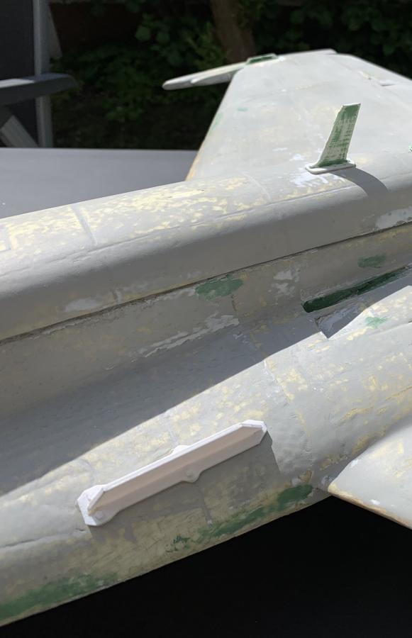

                        Originally posted by Radar-Guy
                        WILCO! How about some LERX fences?
                        Click image for larger version  Name:	CDCC7E0C-1CCA-4CE7-A1BE-C769FF6F0C68.jpeg Views:	20 Size:	43.7 KB ID:	207677
                        If you want honest feedback, the LERX vortex generator looks too "thick" - is it a limitation of the 3D printer?
                        You could achieve a more scale look implementing as a thinner "skirt" applied at the bottom of the stock piece, and sanding tapers at the front and back ends of the fence.

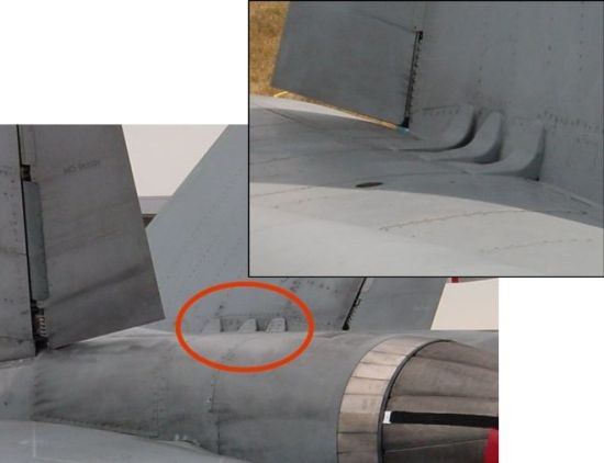

                        And while you are at it, perhaps some vertical tail brackets that were also added for the metal fatigue problems the vortex generators addressed.

                              fredmdbud is correct, the above shown LEX fences are an early work for my LX F-18. There will be a revised 3DP design. Tapers on front or back are hard to print on a part with 1,15mm thickness.
                              As already mentioned, those tail brackets were fitted on early models only. I'll put them on the list, but with low priority. I'll give you the brackets for the later models.
                              I decided to open a separate thread for 3DP files. I think, it will be much easier to find things there.

                                  LX made a Legacy Hornet? I thought it was a Super Hornet. The airframe redesign made the vortex fences unnecessary, so they were deleted.
                                  • Radar-Guy
                                    AirBorn Jetworkx
                                    • 364
                                    #2457
                                    Originally posted by fredmdbud
                                    LX made a Legacy Hornet? I thought it was a Super Horne. The airframe redesign made the vortex fences unnecessary, so they were deleted.
                                    Ah sorry, I meant the Starmax/JePe F-18.
