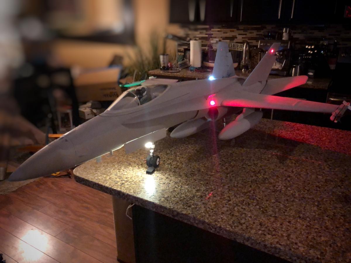

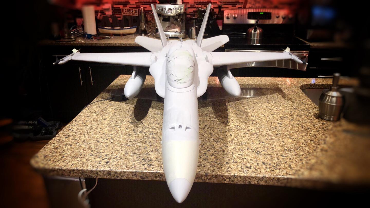

                    • Latest progress. Left vert is almost done.

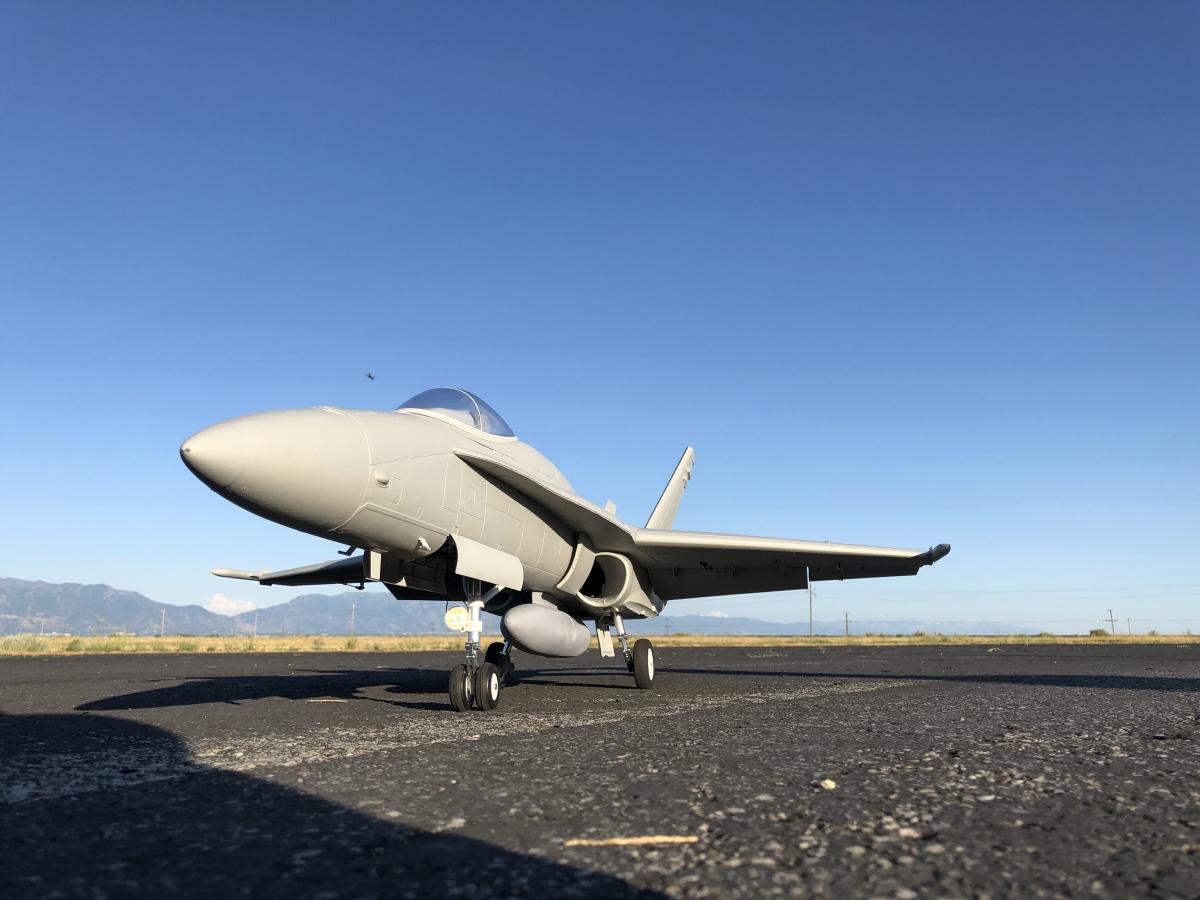

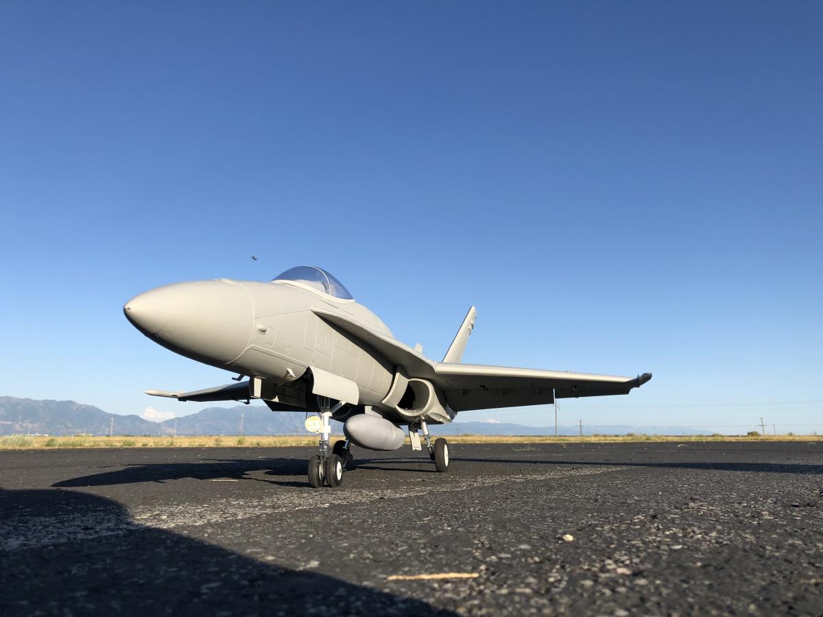

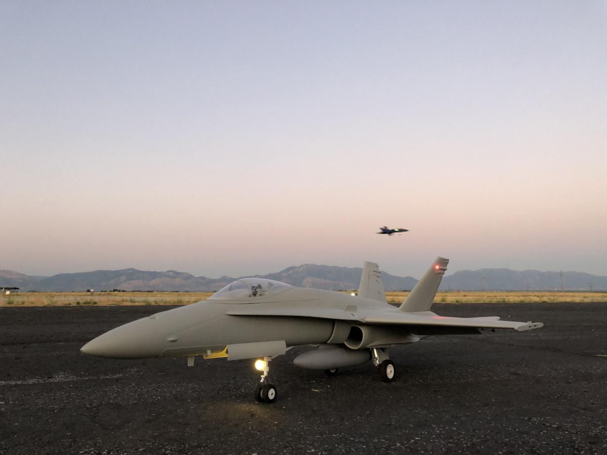

                      • So I’ve successfully test flown the centerline tank with no issues. It’s a 3D printed tank, was spiral printed and very light weight for 3DP. I cut foam on the belly to put the pylon very tight to the fuselage so it couldn’t wiggle. The jet needed no trim with the tank on from stock, and if anything , the tank acted like a keel necessitating a little rudder during slow flight turns.
                        As you can see in my video, it fly’s fantastic.

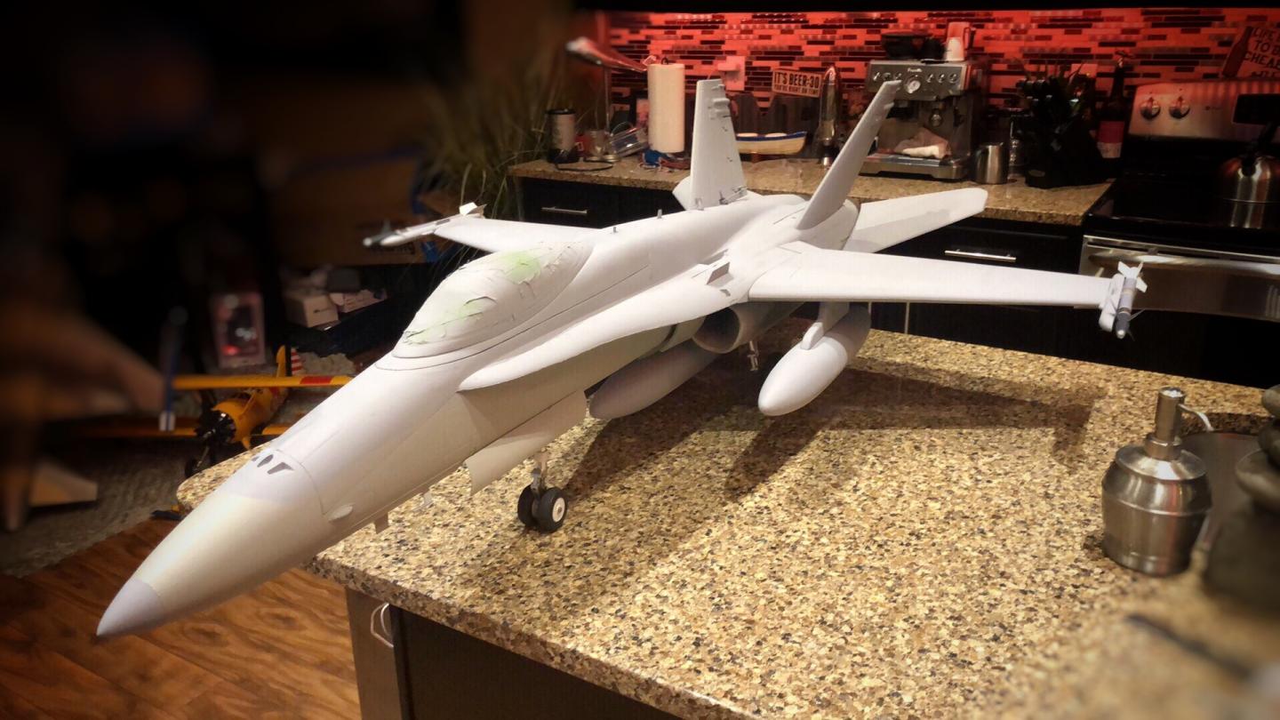

                        I’ve printed the wing pylons and tanks and fitted them, but didn’t get a chance to test fly it today. I have to go fly airliners for a week and will post the test flight results when I’m back.

                                  • Originally posted by JLambCWU View Post
                                    Hi: great looking centerline droptank and pylon! Is it possible to get the 3D printing files for those of us who would like to add this onto our airplanes? Also, the wing pylon 3D files would be great to have too, as I would like to have them look scale to this model. I did buy some F-16 parts from MRC for this purpose, but they don't measure up as well as I would like. If you provide a service for printing these (since I don't have a printer) if you could tell me what you would charge to print and mail them to me, or if you don't do that, just the files would be great!
                                    Thanks,
                                    davegee
                                    • Originally posted by davegee View Post
                                      Thanks,
                                      davegee
                                      The tanks are scaled up half prints of the Napalm canister file on Thingiverse. 215mm long per half. Don’t use the half that has the flange. Just double the other one and glue them together.
                                      Print in spiral/vase mode one half at a time to keep them light.
