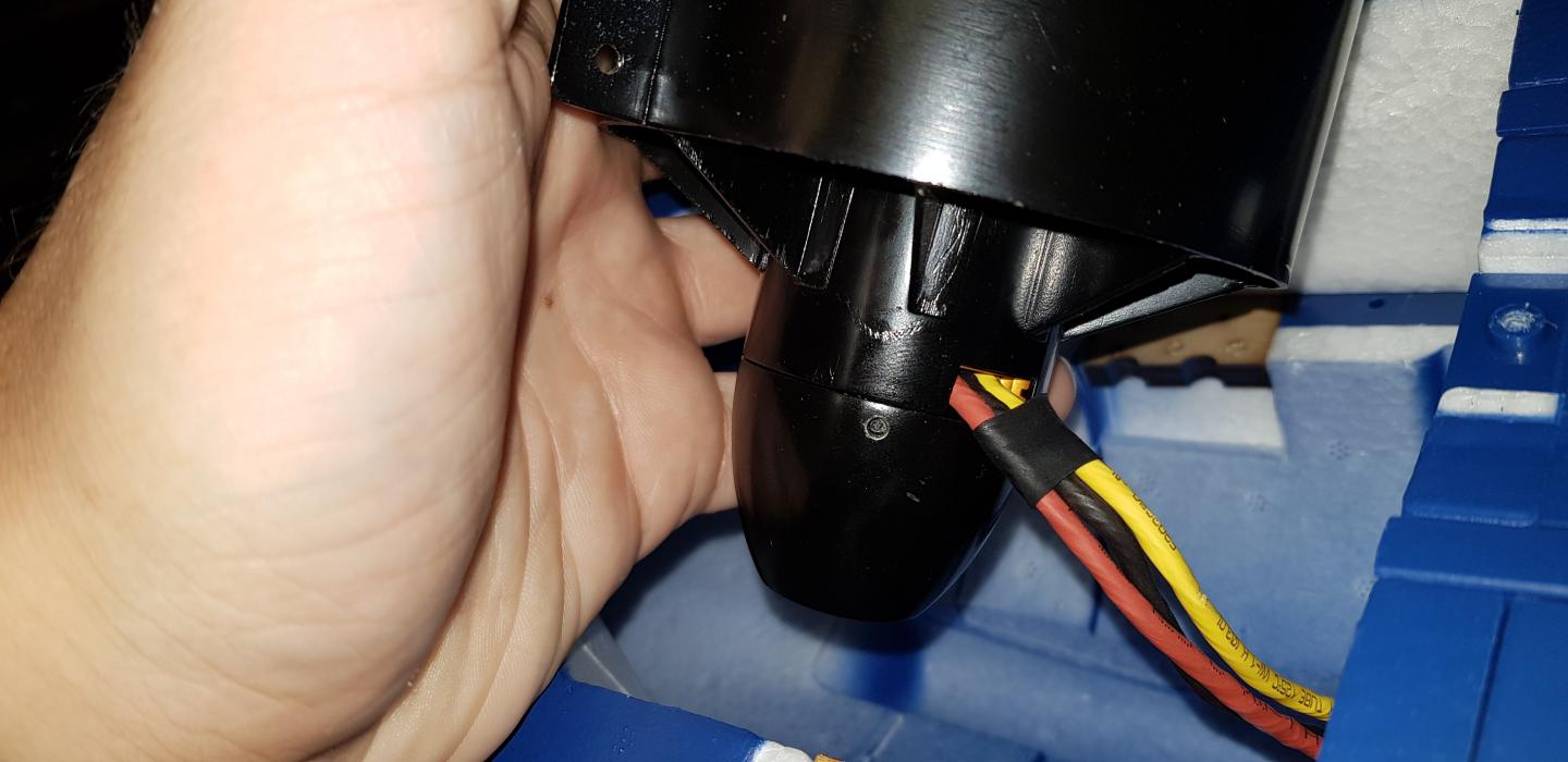

                                Just wanted to install my RC Geek centerburner but turned out that one of the screws on the motor cone has been turned too hard - cannot remove it all :-(
                                  If you have a slightly larger torx key bang that in the head of the Allen key. The torx key should grip it as it has more sides. Works everytime on rounded Allen key bolts.
                                    #2677
                                    The grub screw may also have some Loctite applied to it at the factory. Take a soldering iron and heat it up to loosen the Loctite, then as Carl said above, try using a slightly larger Torx key, or take the regular Allen key and hold it at an angle. Should come out then.
                                      • 5401
                                      #2678
                                      I think just the heat will be enough.
                                          Thank you, that worked!
