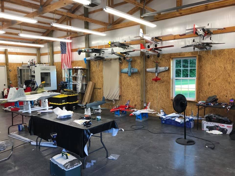

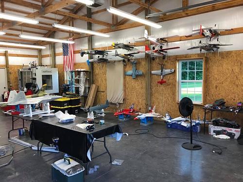

  • This is my current setup. The other 3 walls don't really have room to mount racks. The reason why most of the planes are up high is we use the shop for family reunions (better to mess up the shop than the house).

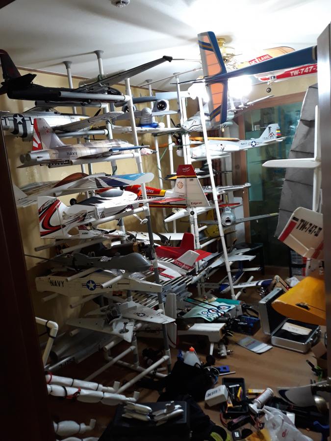

    • Here's my chaosone more rack to build and I'll have the storage needed to get the rest of the birds unboxed and built.

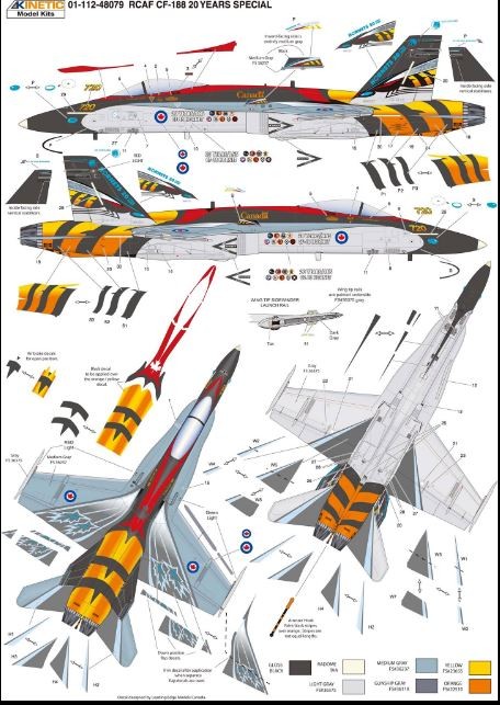

        I think the black is scale. See attached pic. I guess you could put the clear one on first, then the black one over it. Maybe they did that as the yellow does not stand out as clearly as the bigger decals, and you need both to make it pop.
        Well I'll be damned. I never even thought of that!

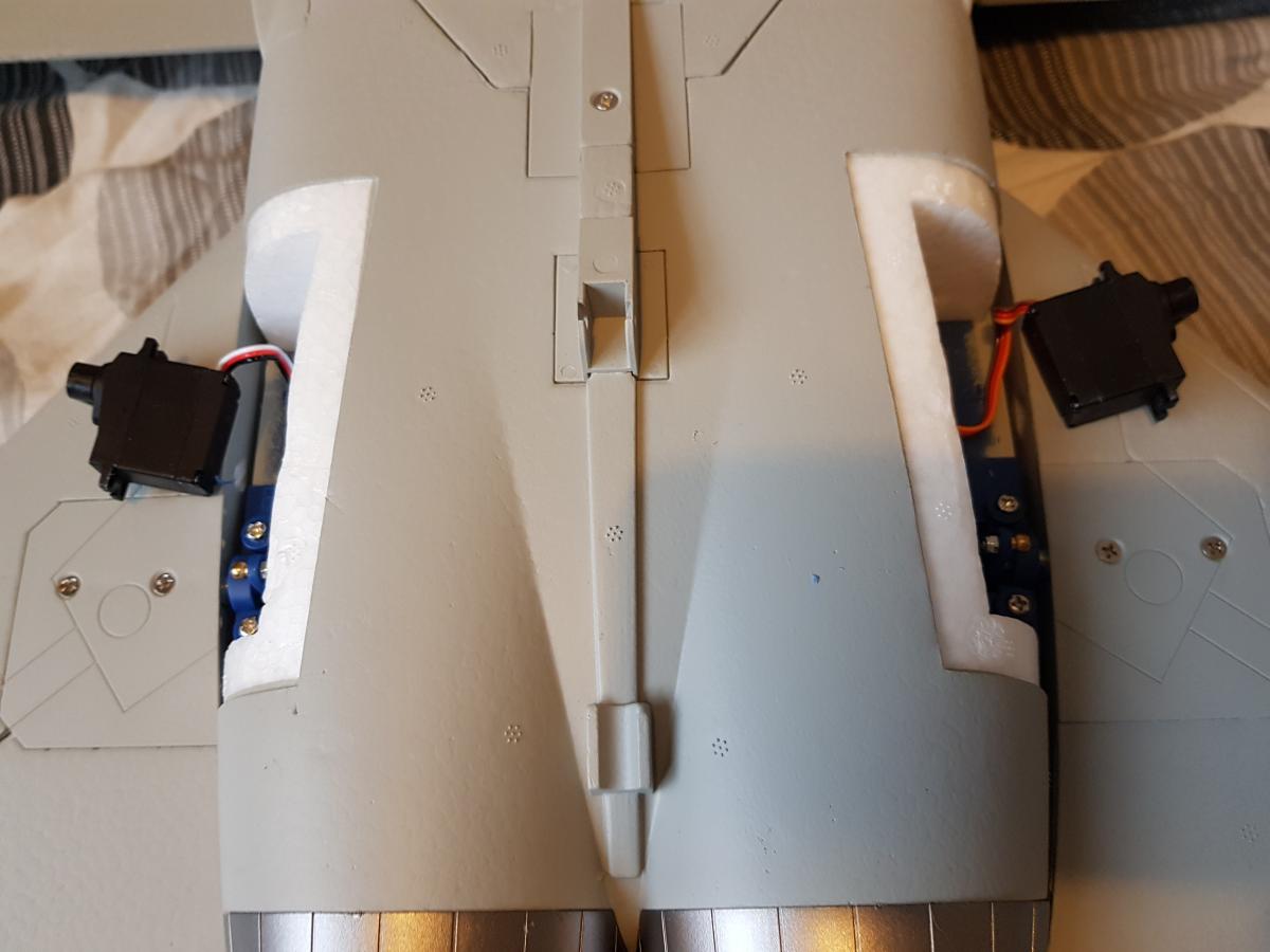

            • So I finally received my base grey pnp yesterday and putting it together today. Whilst carrying out the checks on the elevator all seem fine. Except I have noticed that while the servo wires are fine. They are different colours. One is black/red/white and one is brown/red/orange. This would suggest to me that these are not a matched pair of servos which on a full flying stab that needs to move perfectly together this seems a little off. Thoughts? I have put in a ticket with Motion to see what they say too.
              also what did people do about the slop on the rod again?

                  • Gosh, the color on the servo wires show one is normal rotation, the BRO and the other reverse, the BRW. You seem very critical about things without asking here or doing a simple search.
                    Slop on what rod?

                        As Evan stated, the brown/red/orange lead means the servo is standard rotation, and the black/red/white means it is a reverse rotation (flaps and dual elevators need one servo to be reverse). This is a very good system for determining which rotation a servo is when it is out of the plane (this only applies for Freewing servos, can't say about other brands). Be assured that they are matched servos, just different rotations.
                        I personally have not experienced any slop in the control rods. I think the real issue is that the elevator servos should be full metal gear versus hybrids. The hybrids only have 32 oz/in torque, whereas the full metal have 35 oz/in. I fully believe this is what caused my crash when it would not pull out of a full power 45° dive.
                        • The slop you feel is probably the bearing to housing . Fix is to wrap (1 time) around with masking tape or use a dap of glue. I prefer the tape method
                            No call for that Evan. Having concerns over two servos that are obviously not identical is indeed a valid one. And yes, the answer is because one is a reverse servo and the other not, but his point is still valid. Regular vs reverse servos more often than not are difficult to match properly in both terms of travel, center and derived from that; geometry.
                            • Oh ok fair enough. Not had reversed servos before. To me being old school white, red black was futaba and brown, red, yellow was JR. Hmm maybe I've been in this hobby too long lol.

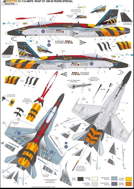

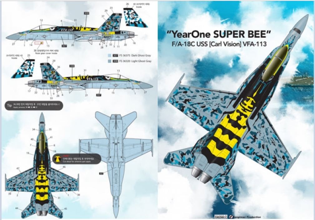

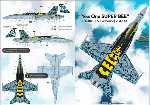

                              • Okay Guys and Gals, I am still looking for a livery, so I thought I'd post some more considerations. Best, LB

                                • Originally posted by Carlbrainiac View Post
                                  The colors don’t necessarily indicate reversed or not, just a convenience for some manufacturers and/or suppliers, e.g. keeping their parts straight in inventory, assembly, etc.
                                  • For motion it indicates reverse.
                                    • Not always. I just replaced an elevator servo in my f35 v3. The wires were rbw, so i ordered a reverse servo. When I installed it, the elevators were acting like ailerons. Come to find out, the one I replaced was a normal servo with red/black/white wires on it.
                                      • True that about replacement parts. I ordered a normal/reverse pair, both had Y/R/B JR cables.
