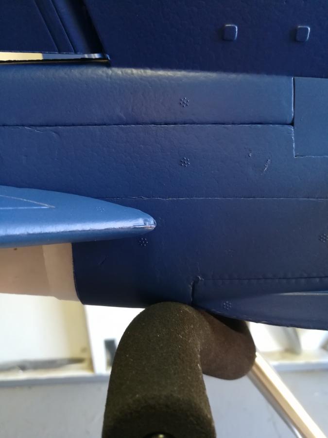

    Its okay, ask all the questions you want, it doesn't bother some of us if the questions been asked 50 times but others get all bent out of shape for some reason, use the CG in the book and front leading edge of the elevator 7mm down from the fuselage seam, real easy, so you wind up with a little up elevator like this pic. Works great for a maiden flight, then you can play with the CG to your flying style, some like nose heavy like me, others neutral, some a little tail heavy, and the arguement will go on and on.

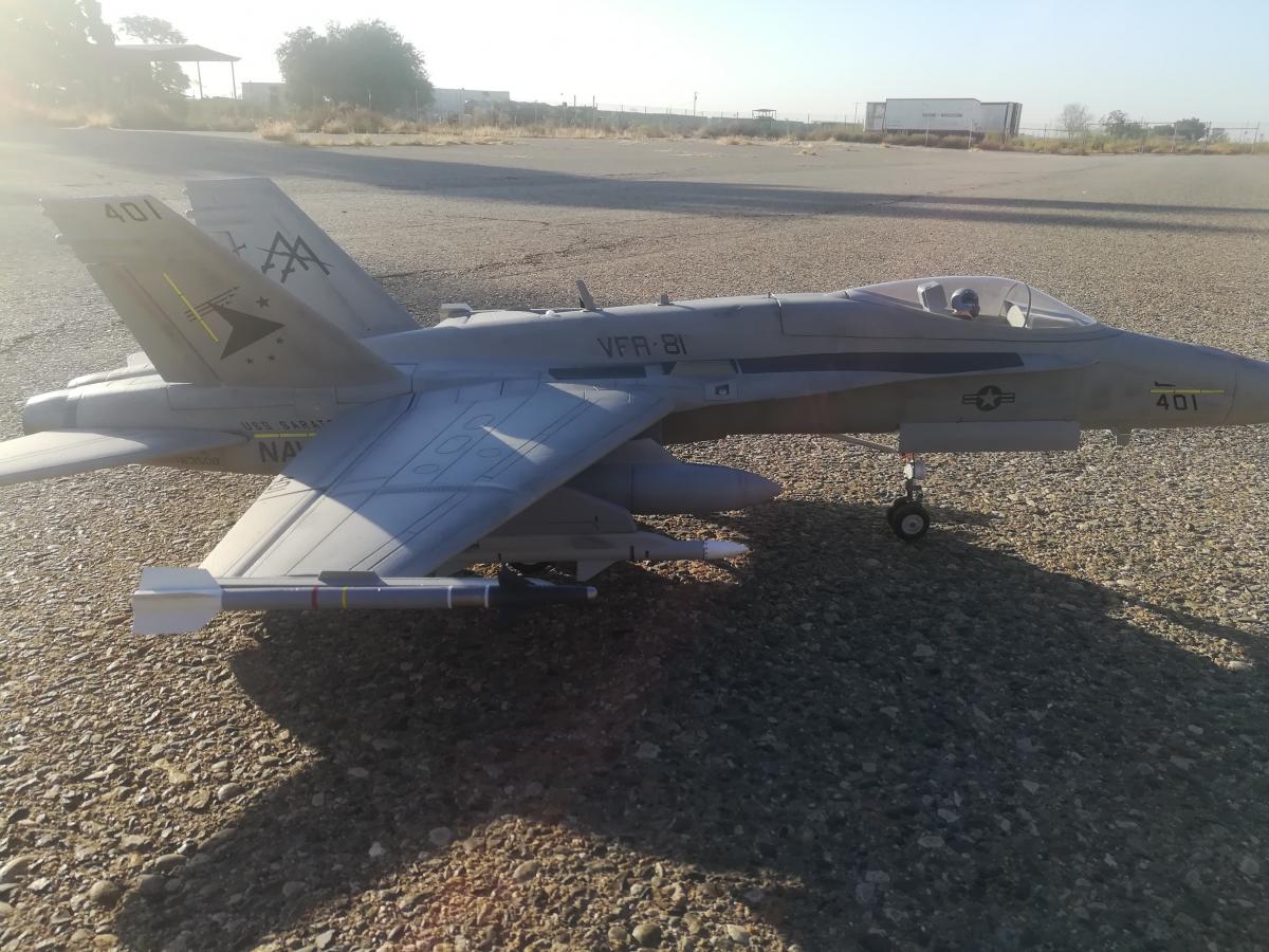

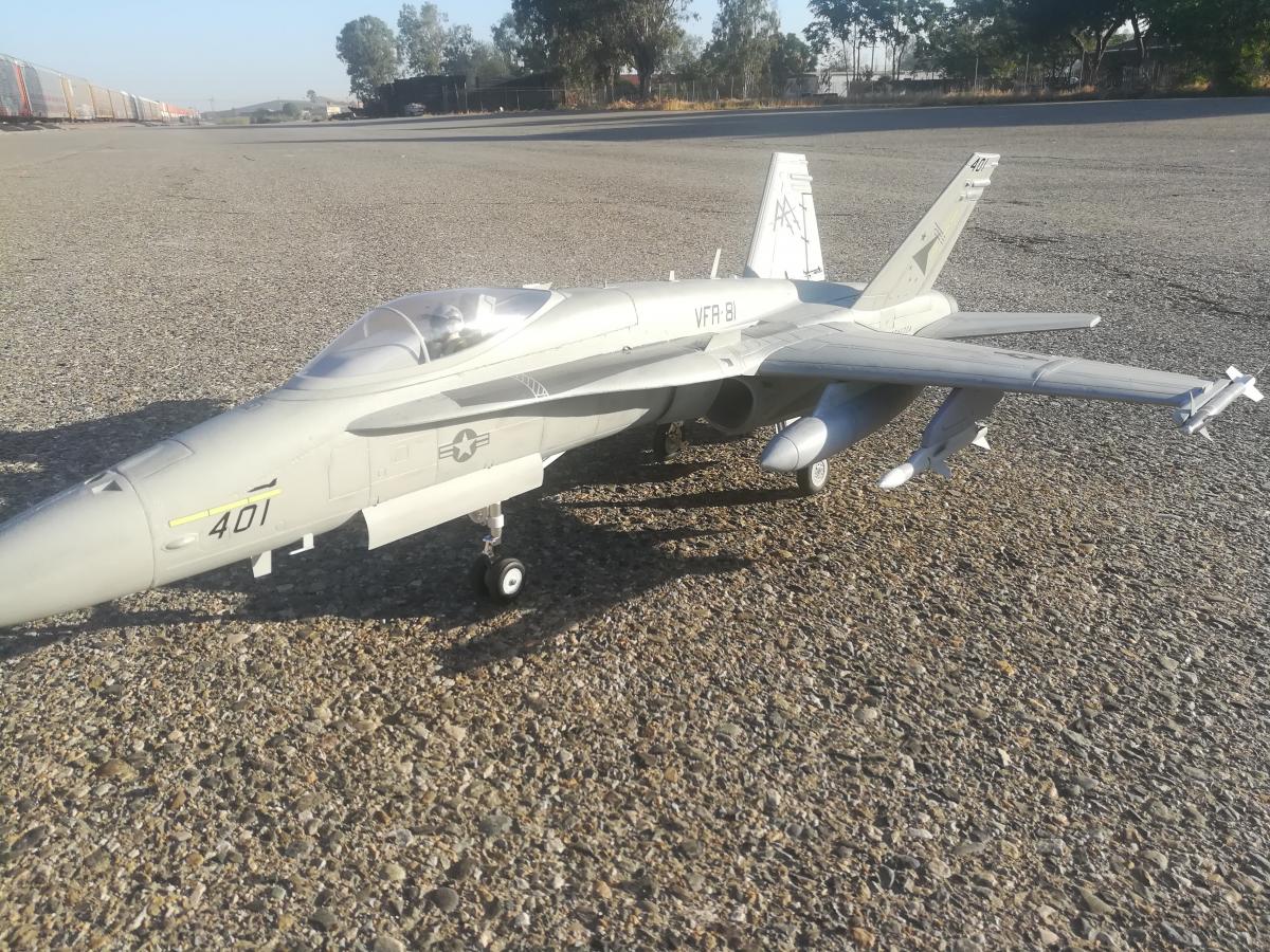

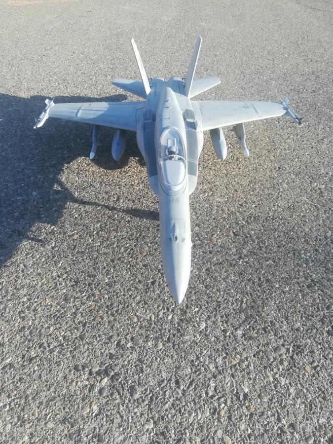

                  Okay, sorry for the bad pics but the sun was not in the right spot at the time, got a flight in before work this morning, didn't fly with the centerline tank yet but did fly it with everthing else in the pic, flew great, small trim change and it actaully landed better, wasn't so floaty with full flaps, just right actually and it looks awesome in the air when you turn and show the belly, not scale ordinace but close enough for me.
                  Just in case someone wants to know this info, I used the attachment points from the FW 90mm F-16, if you look in the spare parts you find that they sell them seperate, the drop tanks and centerline tank are from the FW Intruder, and the pylons and sidewinders missles are from the FW 90mm F-16 and the other missles are from the FW F-15. My CG remained the same, I did move the battery forward just in case but I ended up in the same spot as without ordinace or drop tanks, so that was a good thing, she flew great loaded up, I know I won't be flying it clean anymore, looks just awesome in the air.

                    Looks sweet! Man I love the look of a fully loaded F-18!

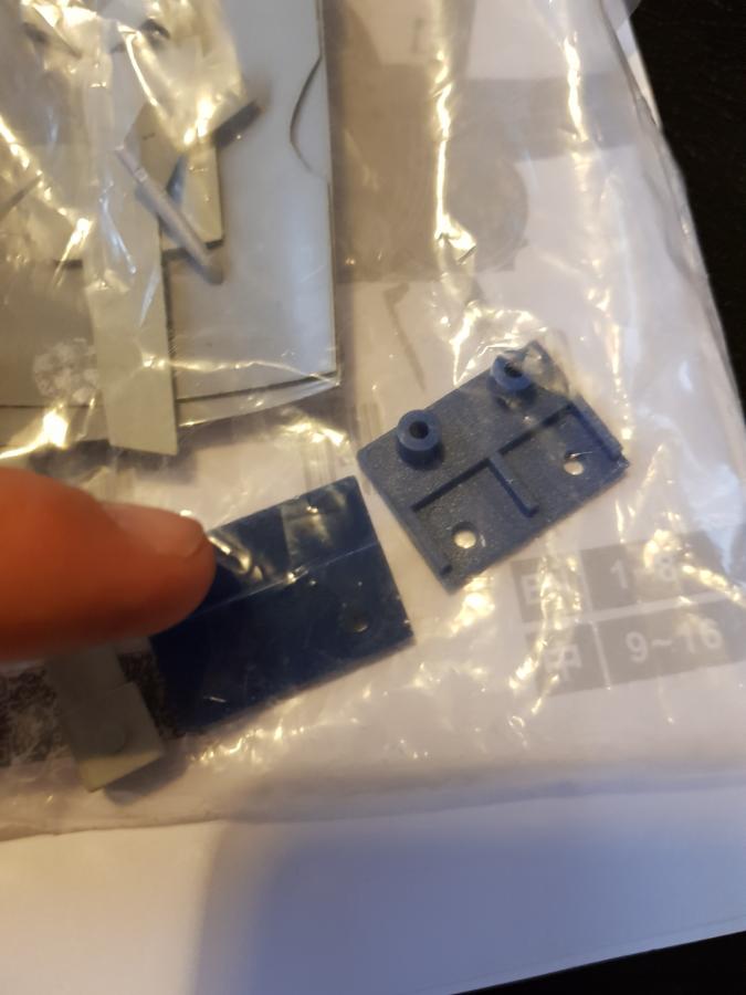

                                      Also what are these blue bits for...
                                        Those go on the 80mm fan mount if you decided to go 80mm instead of 90mm fans.
