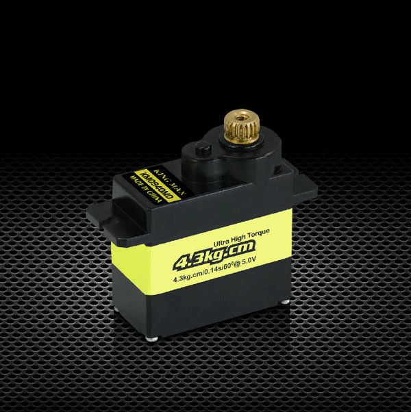

                            These:
                            KingMax KM0940MD--13g 4.5kg.cm torque,digital,Taiwan made high-precision aluminum gears mini servo Largest selection of KingMax Servos in North America at F3AUnlimited.com and Gator-RC.com
                            About double the torque of stock in package that fits easily. There's a little grinding of the plastic pocket involved to make sure the wires clear well, but it's minor.

                              Have you used these servo's on other models? Not much info on the Kingmax and with the very low price point alittle cautious on the quality.
                              I have heard of some issues with the Flaps when deployed at a fast cruise speed and fast servo speed.( anything below 5sec.). Any one else there having issues with the Flap servo's?

                                      No, first model I've used them on. My experience is that the stock servos fly the model just fine and have rarely encountered an issue, with either FMS or FW planes, except with the F/A-18. So, I've had no reason to try out a bunch of different brands. The stock servos in many of the PNPs are somewhat imprecise and sometimes don't center well, but a gyro smooths some of that out.
                                      I've got a little over 30 hours of run time (transmitter time) on these two Kingmax servos without issue. I usually fly back to back and rarely leave my transmitter on very long between flights and set a 3:00 timer, so even at 6 min/flight, that's ~180 flights or so w/o any issues.
                                      Not a statistically significant sample of course, but a lack of sufficient torque is the issue with the stock servos deploying and these take care of that. On a non-critical flight surface and I'm happy with them and don't worry about what speed I deploy the flaps (both airspeed and I have the flap deployment set at 2 sec.).
                                      It's difficult to find a 9 gr. form factor servo that will have a lot more torque than stock.

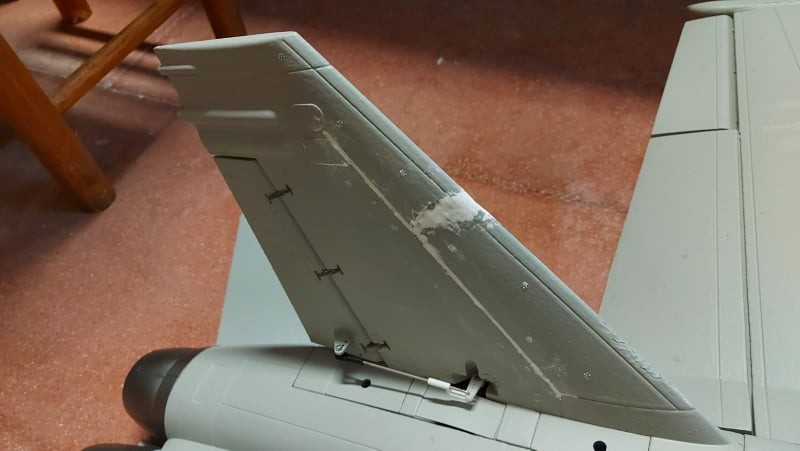

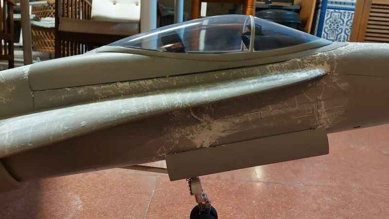

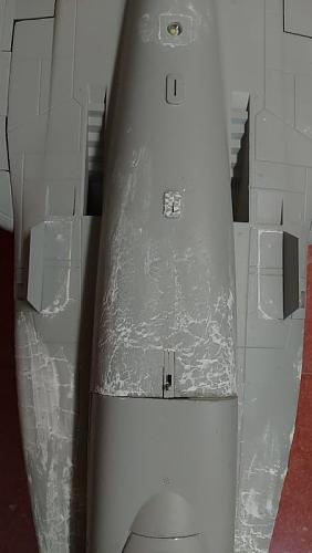

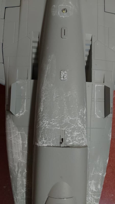

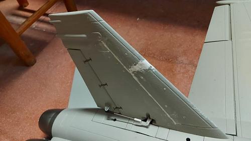

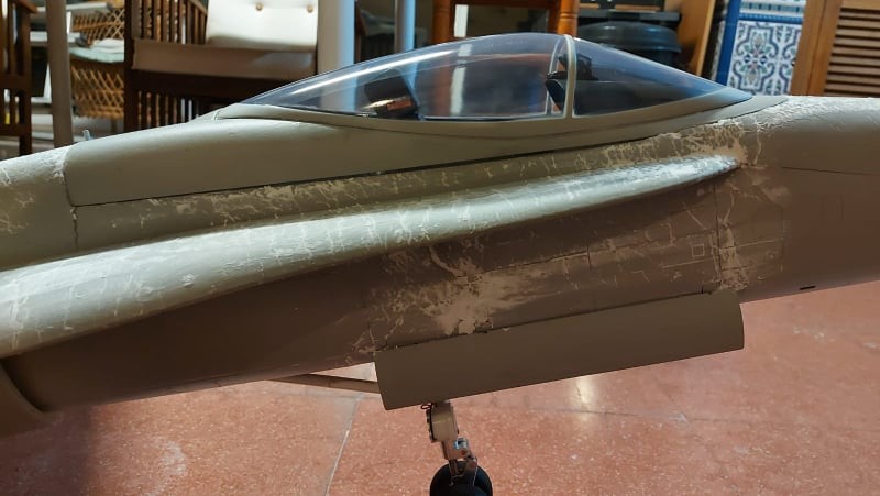

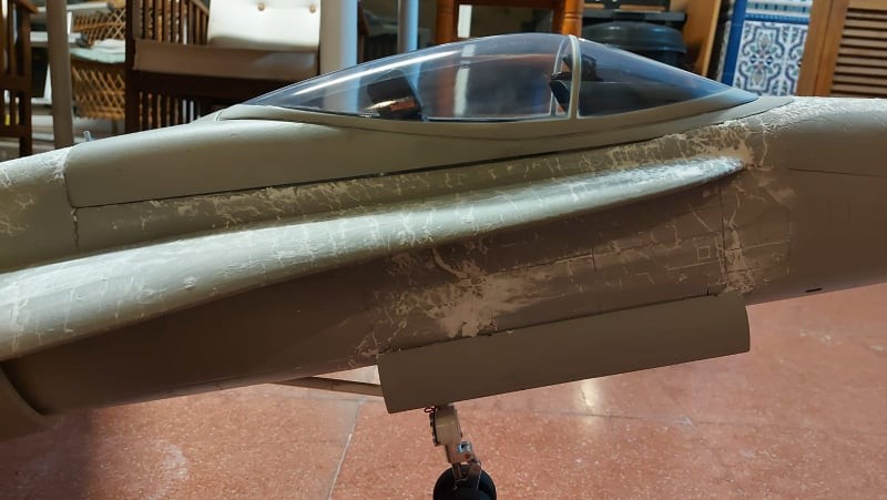

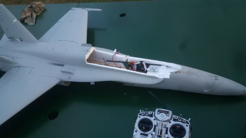

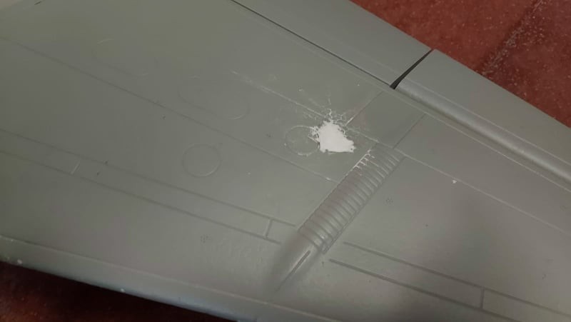

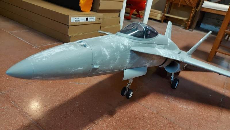

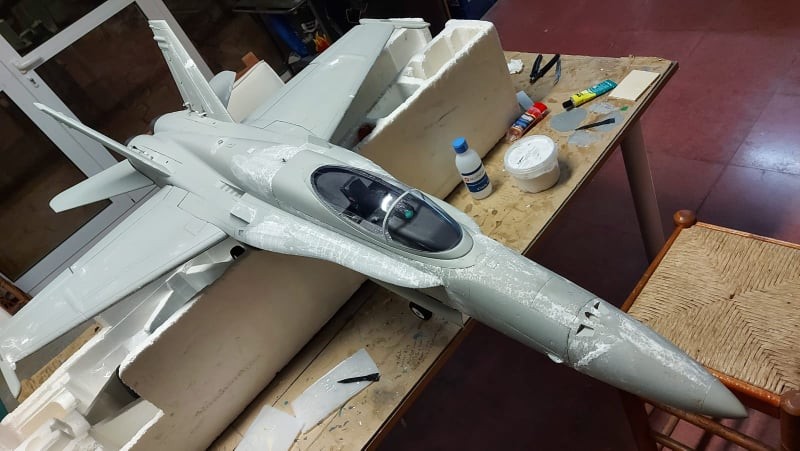

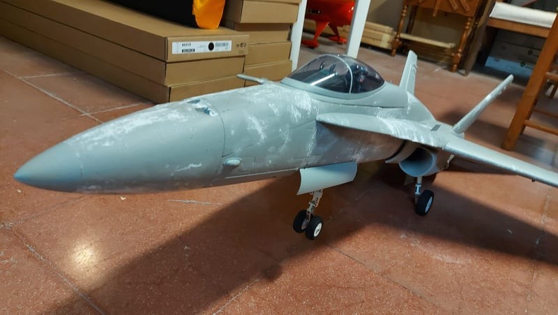

                                        Yup, the Hornet has a horrible stall.
                                        I just crashed mine (again) just a few days ago. Lost orientation (low light, grey cloudy background) and stalled, then hit a treetop, fell from about 20m.
                                        Thankfully the damage wasn't that bad (although nose snapped in two) and the jet is almost ready to remaiden but still... gotta keep reminding yourself to keep speed up on approach (and to fly her before sunset, lmao).
