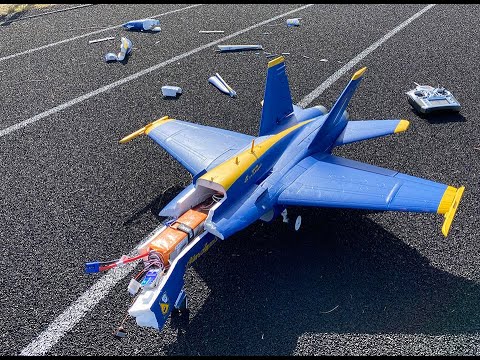

    So, that crash I talked to you guys about... there it goes!
      #4682
      Definitely sucks to see that, sorry for the crash but a well-deserved LOL for the graphics/editing! We've all been there...The dreaded stall you can't quite pull out of. Helpless feeling for sure. I assume this was from a while back?

        #4683
        Glad you liked it! :)
        Yes, the air-to-air video of the Hornet that I posted not long ago was in fact the 're-maiden' after the crash and repairs.
        I have a long queue of edits so things usually come out some time after the flights were made (with a few exceptions). ;)

                                        Sigh.
                                        This one was ALL on me. Perfect flight conditions, no wind, good time of day to fly. Placed the RunCam2 on the bottom side facing forward to switch up the view. Took off, everything was going great. Nice and smooth flight and just as I was starting to think about setting up in the pattern to land (according to my timer I had another 90 seconds or so, plenty of time) I noticed a MAJOR power drain.
                                        Uh oh. I was pretty far out at the time so I rushed to get her back into the pattern and by the down wind, I knew I was out of time and it was either ditch in a drainage area behind a fence or try to cut the downwind in half and get her down inside the track PRONTO. Unfortunately when I banked her on a premature base leg she stalled out and all I could do was watch her ogre in helplessly.
                                        The flight itself was under 2 minutes and 20 seconds. My average flight times are over 3 minutes with mAh to spare in the Admiral 6000's I use. The only thing I can think of is I grabbed the wrong battery...One that wasn't freshly charged like I thought it was.
                                        A sobering reminder to ALWAYS use a cell checker on your batteries before flying. And I just got her all dialed in too! Dang it all. So it's either a new fuse or ARF+ for me.
