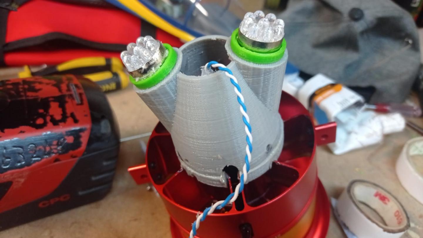

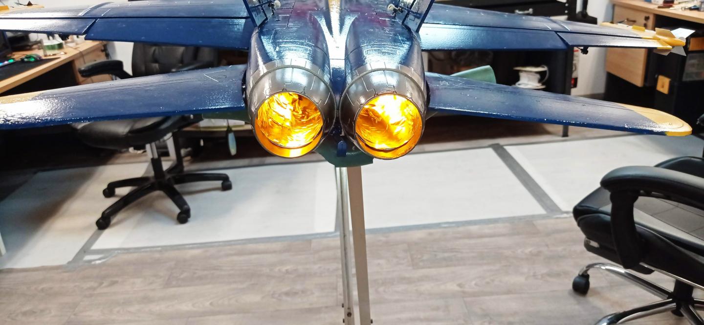

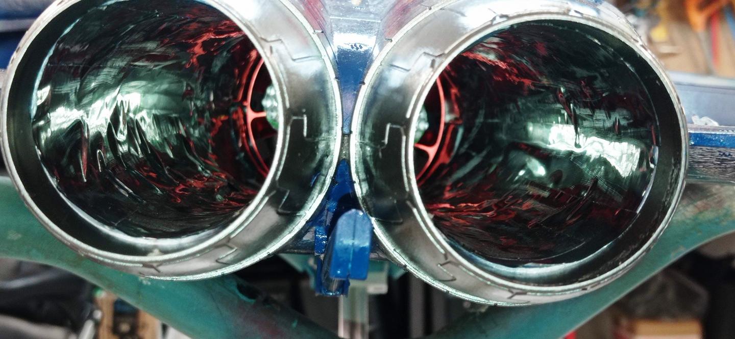

          I have also added a twin center burners on my Blue angel FA-18 Looks sweet! Also modded the canopy to put all wiring under the ply board and pushed all the way back so i can push my 8s 5000 mah Nanotec all the way back to get the correct cg.I Also installed a JP 90mm 1330kv 90mm full alloy edf 8s.
          Also with a 3D mod for the Elevator support Similar to RC Informers ply and metal one. Click image for larger version

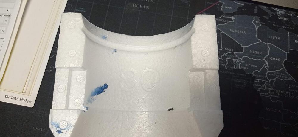

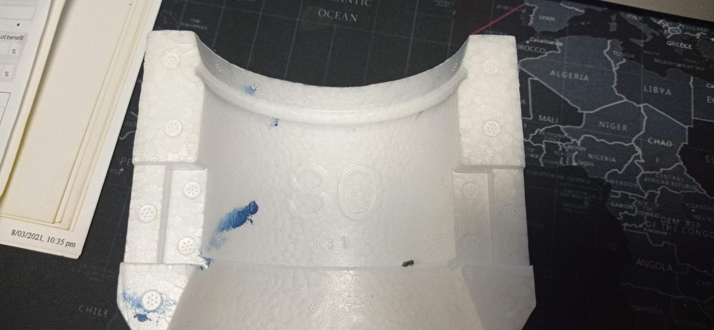

ID:	307045Thanks chaps, anybody know what the funk these are for:
              Hi Mate

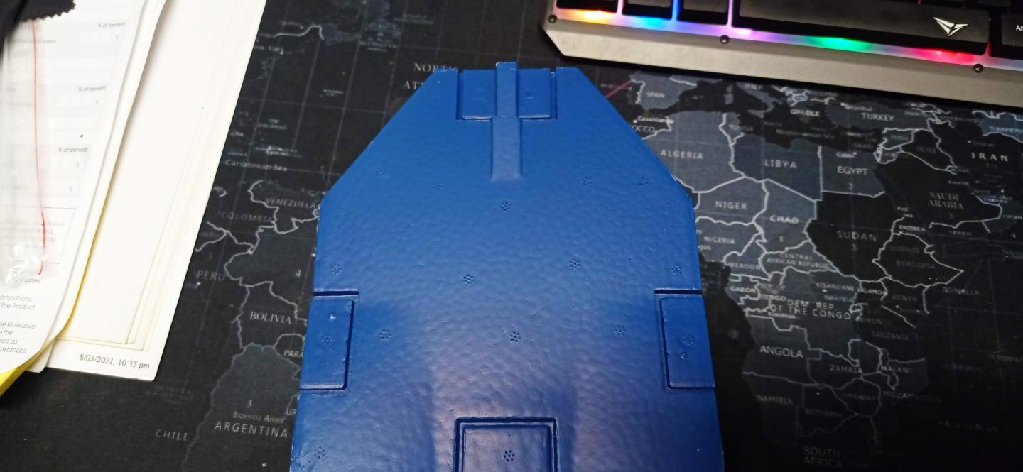

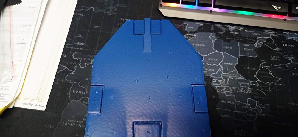

              They are for the 80mm edf conversion if you use it as you also received a spare edf hatch that is for the 80mm edf.

                Why would anyone want to downgrade to an 80 mm EDF in this bird? I never got those in mine (nor did I get a spare hatch), and it was the same base grey version that The43rdHammer also purchased. I went the other way and just upgraded to the 90mm 12 blade inrunner, definitely more thrust than the old outrunner mine originally came with and even more than the newer upgraded "high performance" version with a 90mm 9 blade inrunner. I'd definitely need a catapult to get off our grass if it had an 80 mm in it!
                  Yeh i wondered as well why any won would put in a 80mm edf,As you can see i got the 80mm hatch with the blue angel version unless they did not supply in the grey version Who knows?

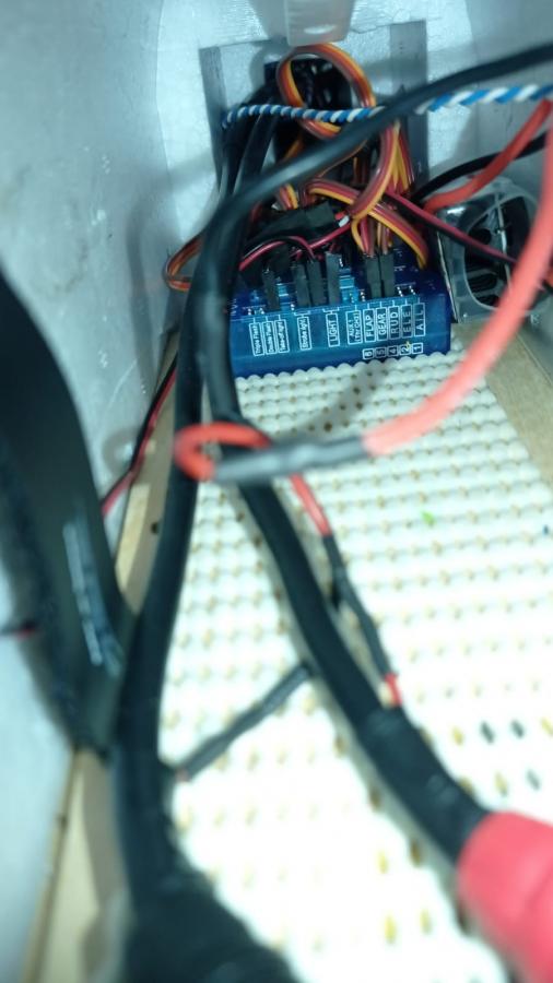

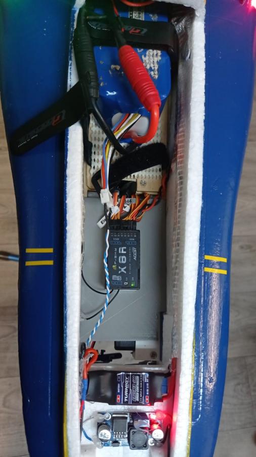

                                    Thanks Hugh Will start at 100mm even though I ended up balancing it with the 8s lipo at 88mm all the way back i think i need to put the control pcb under the ply battery plate to get a bit more space to move the 8s battery back to obtain cg at 100mm.

                                      Had to do the same with my control board, actually stuck it to the fuselage wall so I could get a battery further back. With the 12 blade and the battery all the way back, I was at 100mm, and still flew nose heavy, at least in my opinion. Added an additional 4.5 ounces to the rear so I can now get to 115mm max, or minimum of 102mm using a RT 5500 70C or an HRB 6000 50-100C. Hopefully get it out again this week to see how it flies there.

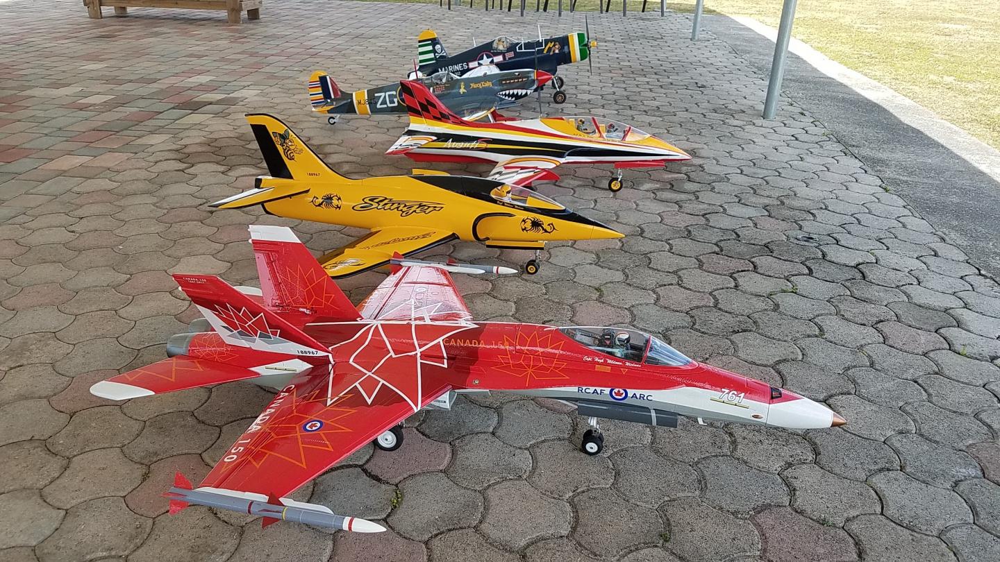

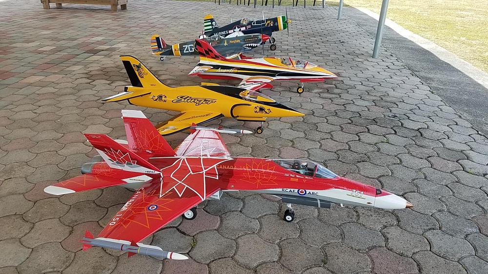

                                          Anyway, got out again today with the F-18 and a few others. It was a bit windy and gusty, 16-23 mph, but at least right down the runway. Had the field pretty much to myself, never more than 2-3 guys there at any one time. Got in 5 flights on the F-18. I'm loving the 12 blade inrunner. I was planning on moving the CG back to 110-114mm as Air G had recommended, but with it so windy, for now left it at 105mm. Hopefully next week it will calm down as I won't get to fly for a while because our club is hosting an IMAC event Thursday thru Sunday.
                                          I'm thinking of getting another F-18, leaving it stock but putting the 12 blade inrunner in and flying the snot out of it. Each time I take up the Canadian, I'm seriously tempting fate as sooner or later I always manage to pull some bone head "mishap". And just learned that starting May 15th, MRC is increasing the price on ALL their planes by 10% to cover increased shipping and other costs. My luck they'll get the Mig back in stock on May 16th!
                                          Click image for larger version  Name:	20210407_104611.jpg Views:	0 Size:	298.6 KB ID:	307821
