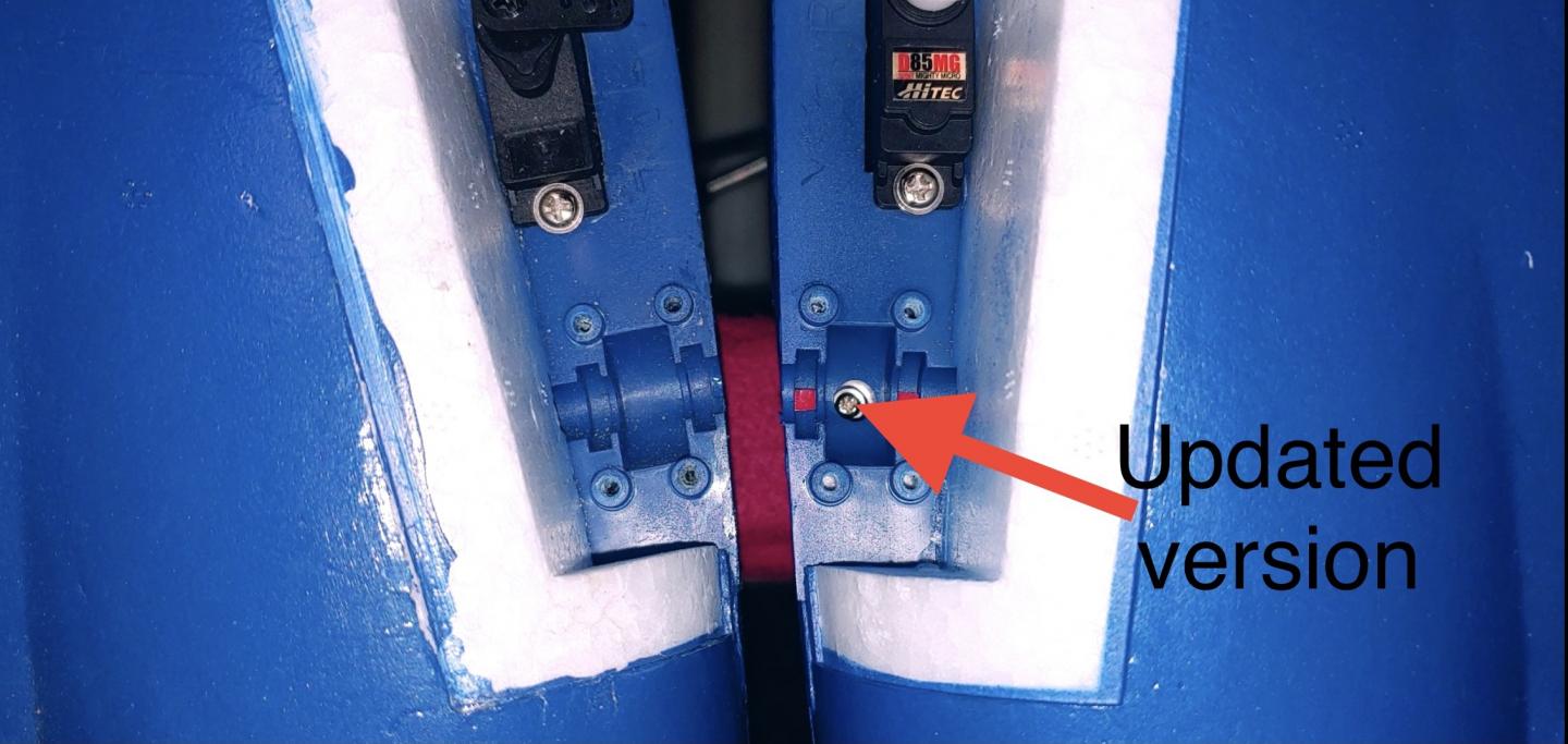

                      Little help MRC....
                      Looking at this bird, but have my own power setup so looking at the ARF Plus. Has the ARF Plus received the upgraded elevator setup same as the PNP HS?

                        Originally posted by tdford6
                        Little help MRC....
                        Yes, an ARF+ is just a PNP without the power system, they come off the same assembly line only the ARF+ skips that step

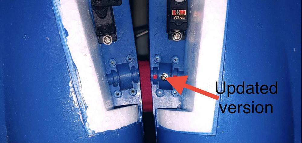

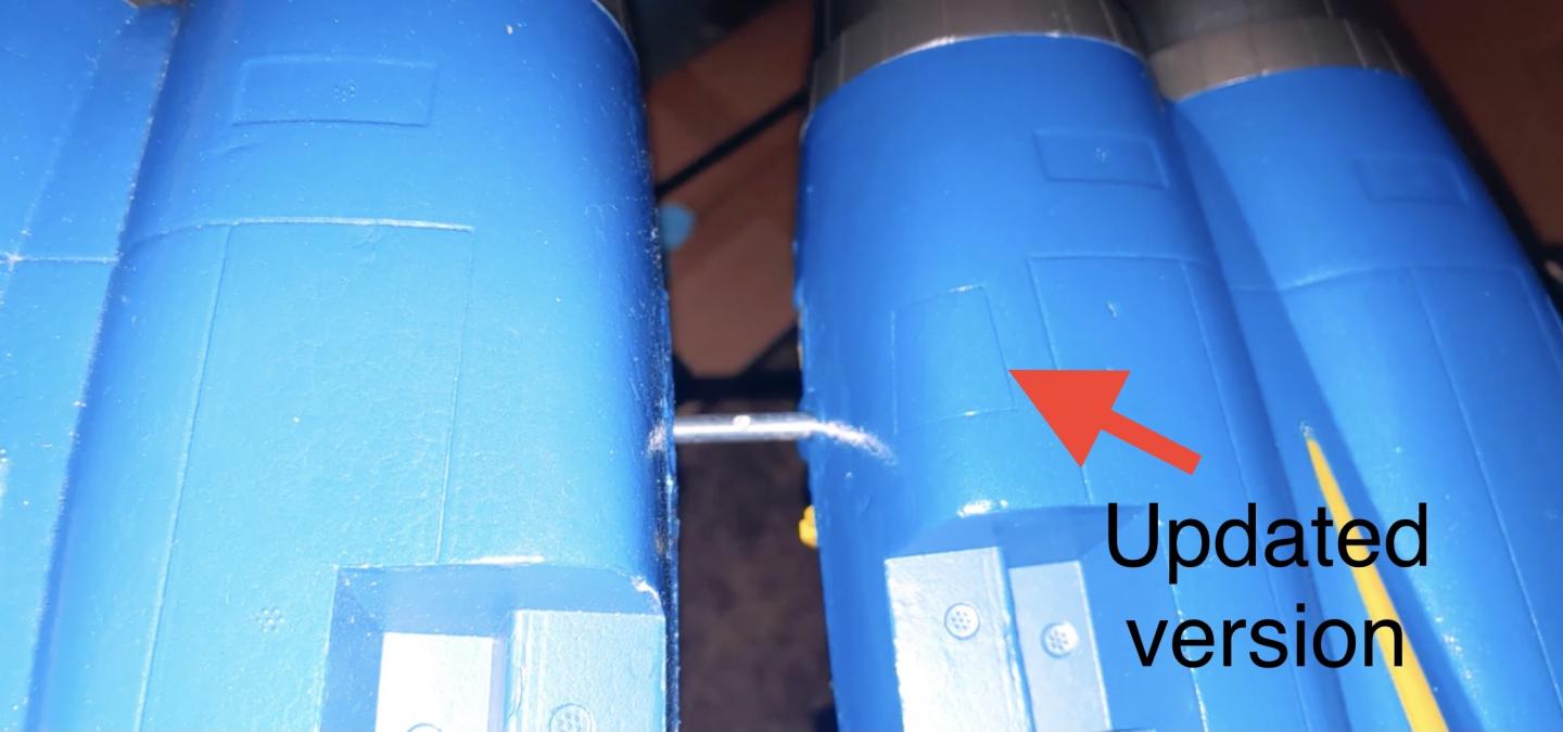

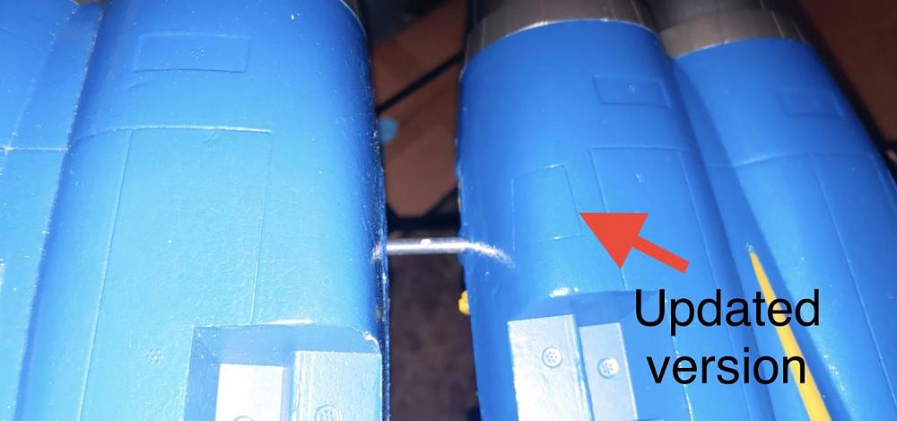

                              Little help MRC....
                              Hi TD. Hope all is well. It appears there are a few ways to tell if you have the updated horizontal stabilator mounts. On the new one, there is a small rectangular shaped piece on the top of the fuse near the mounting area, as well as a hole with a screw in it near the pivot assembly.
                              Here are screen shots I took and placed text onto them from the video made by IntegrityRC on YouTube who did the great comparison of the older and updated version of the Freewing F/A-18C horizontal stabilator mount change. I have also linked his video below.

                                #4895
                                Thanks guys!!! 👍
                                I chatted on MRC earlier but the tech couldn't answer the question. Maybe update the website to note the change. I could only find it on the PNP HS.
