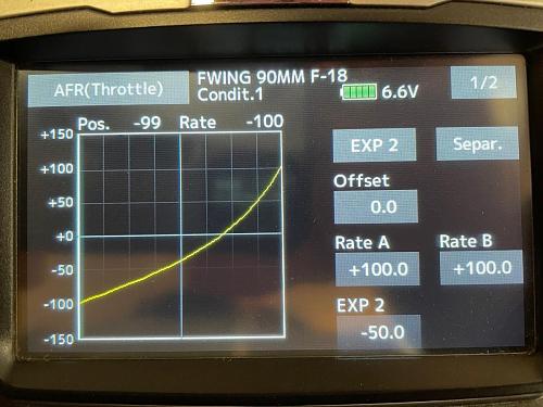

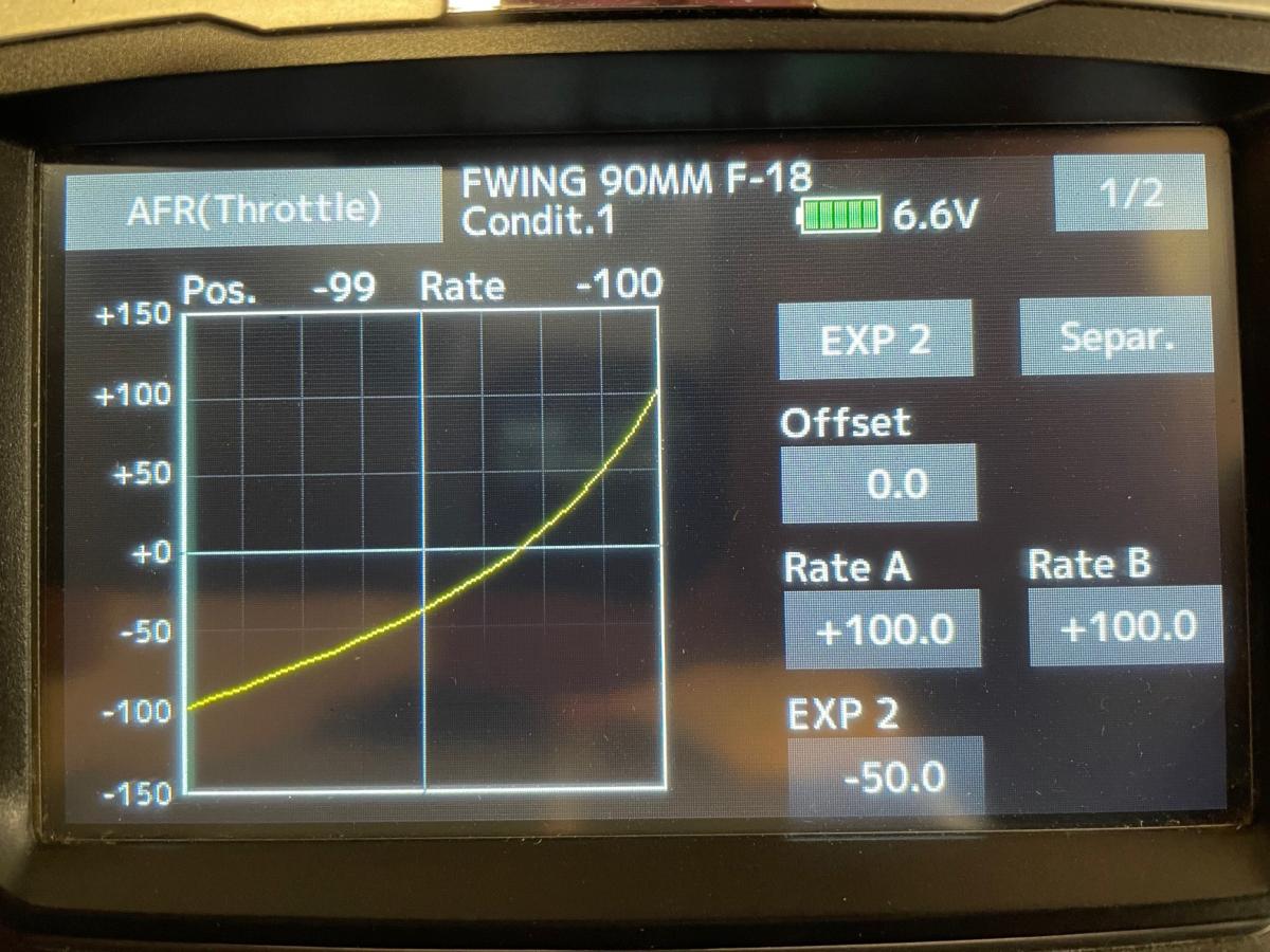

      I think I've actually got to the issues, I downed tools yesterday afternoon and went to the field. Got 3-flights in on the F-18 (5 on the L-39)
      I put a 50 % exponential curve on the throttle (see photo below):
      So, my conclusion is that given the power those motors are putting out, I must have inadvertantly been using much more throttle than I actually needed most of the time.
          After around 3-minutes 30 seconds I landed with 60% left in the battery (I really didn't expect this). So with some mixed flying I reckon I can get over 5-minutes out of her
          I suspect it's something to do with the power / rpm band for that motor/fan setup, a little like a the sweet spot on 2-stroke sports bike if I might use that analogy.
          I'm going to use the same 50% throttle expo on the A-10 and am hoping it will significantly prolongate my flight times on that, in fact, I'm more optimistic that I will see a more dramatic change with the A-10.
          Based on limited testing I would recommend people experiment with this, you can't really do any harm and with an exponential curve you've always got full power at the top of the sticks.

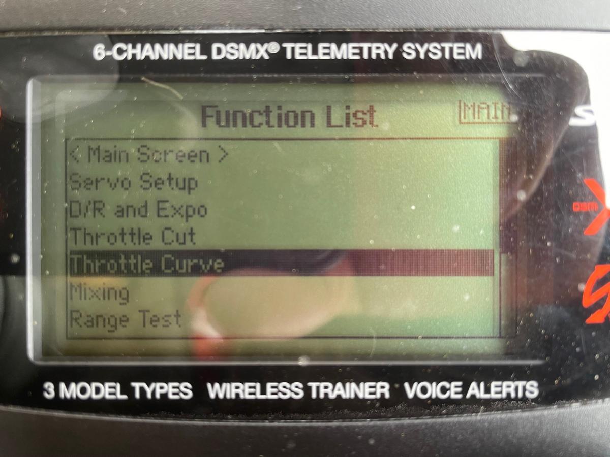

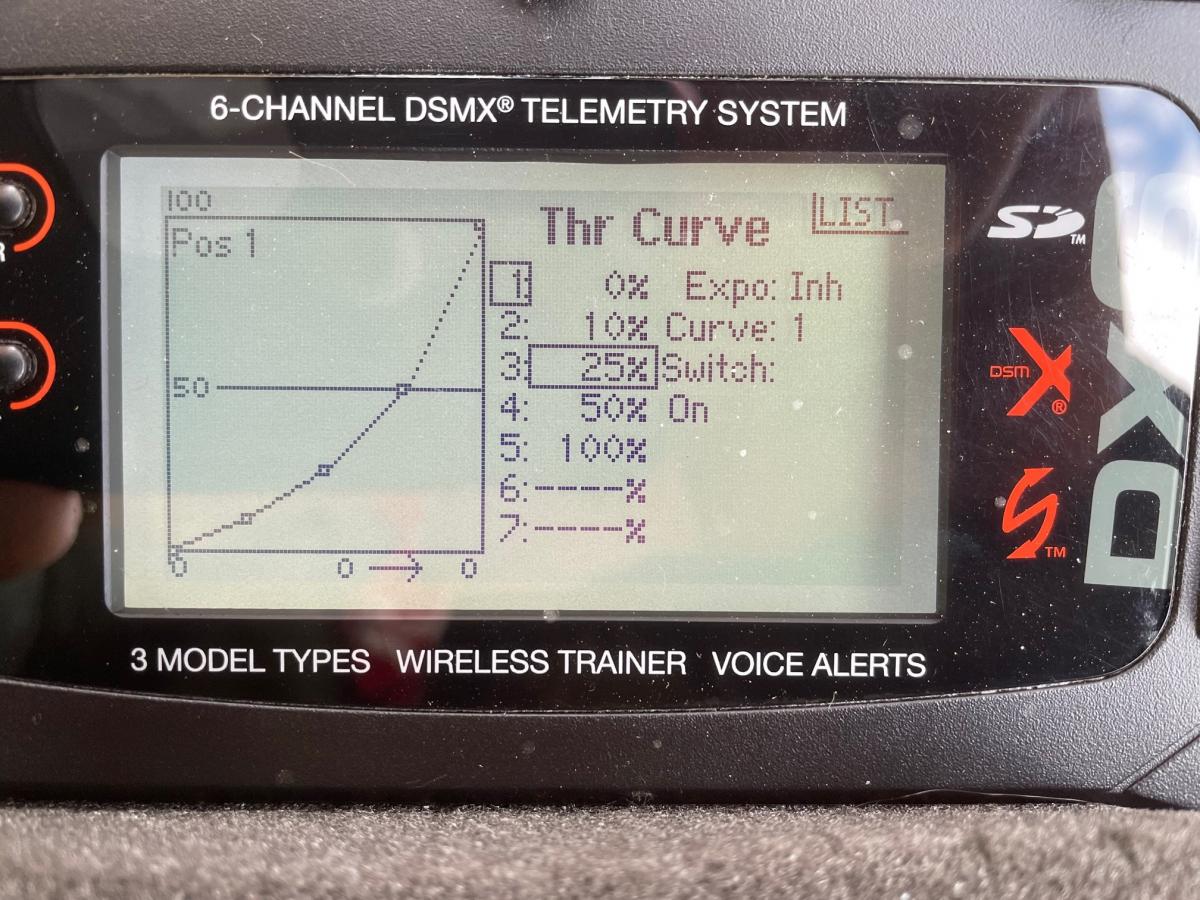

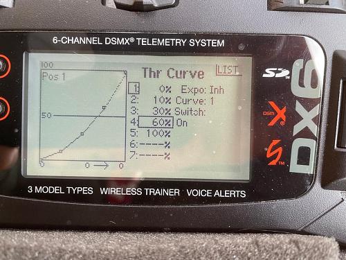

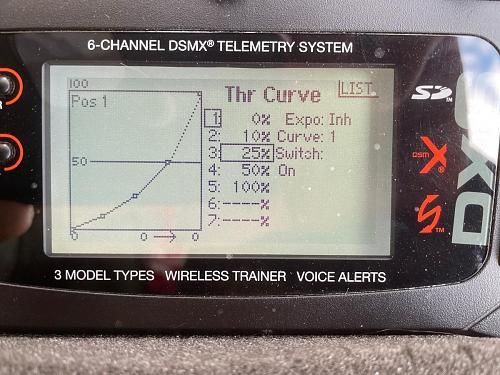

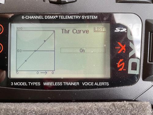

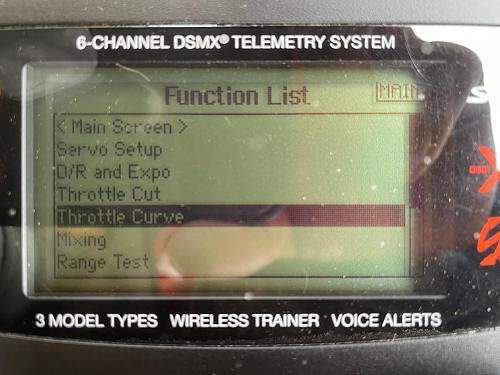

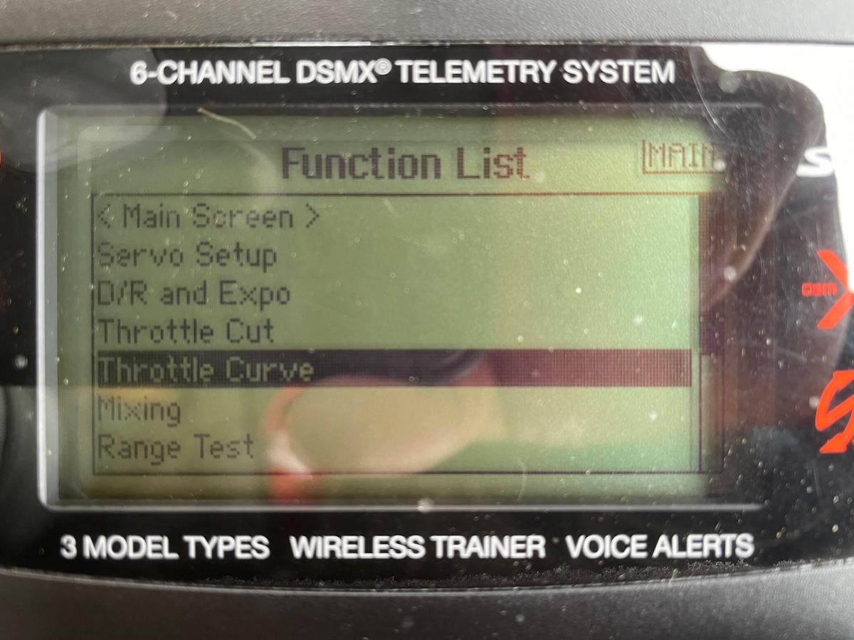

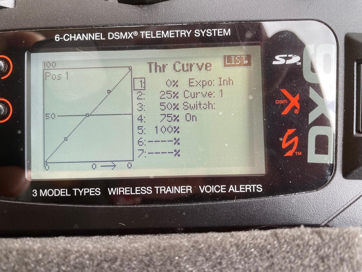

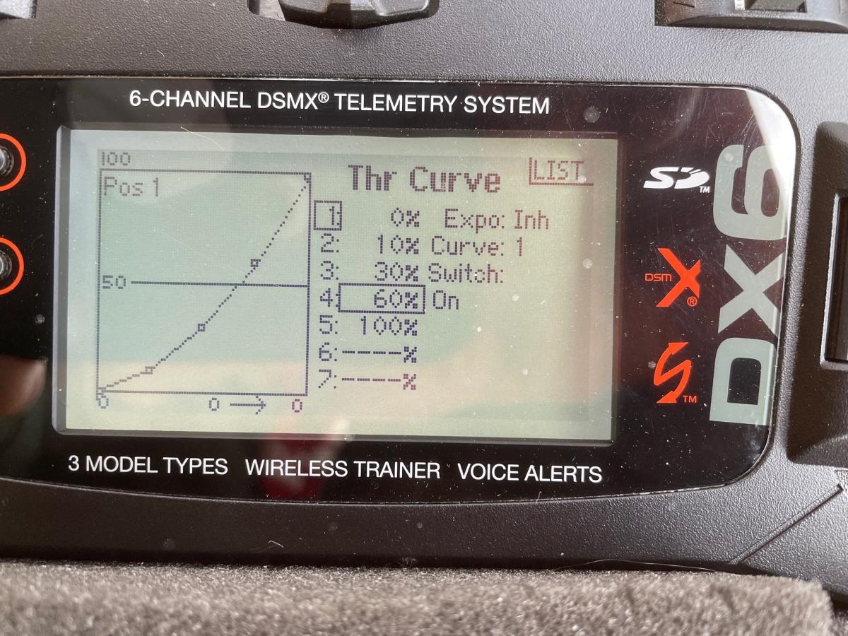

                      • Hi all, so I was messing around with my (old) DX6 and came up with this curve, which I think is similar to the one I have on my Futaba, for Futaba users an EXP2 curve of 50% worked best for me, lower curves reduced the benefit exponentially (pun intended):

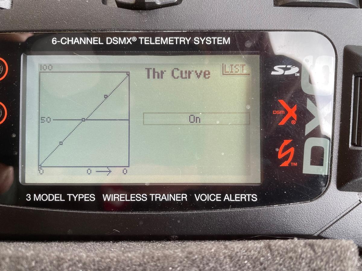

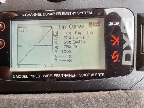

                        I think I'd maybe try something around 30% throttle @ 50% stick to begin with:

                        Andy
                        • The43rdHammer Andy, you hit the nail on the head, just checked my DX9, same thing, looks pretty simple to set up. Thanks for your investigations, Mr. Holmes!
                          Just not sure if I'm ready to give it a try and maybe Aros has an idea of trying it out on a "disposable" aircraft (hmmm, now which one is going to be the guinea pig?) Only concerned that I'm so used to throttle placement with my fingers (my visual judgement of actual airspeed kinda sucks in windy conditions), especially on landing approach and landing that I'll be too slow at the lower end of the throttle curve that I'll end up with a wing stall, and the F-18 is not a fun airframe to wing stall at low altitudes. Obviously it worked great for you on battery management but doubt I have the same skills. Interested to hear how it works on your A-10, but since I'm already getting 5 minutes on that and 4 minutes on the F-18, will probably just leave those as is. I used to be able to get an additional indication of EDF "speed" with the older fans from their whining noise, but since I've converted all my 90 mm to the 12 blade inrunner, it's not quite as noticeable.
                            🤣 absolutely, nobody should do anything they feel uncomfortable doing, just following up on my previous email(s).
                            I suspect this is more relevant for those of us out there with 9-blade inrunner setups (80mm or 90mm).
                            Things were twitching that shouldn't have twitched when I tried it, but then again I felt like I had nothing to lose at the time and had at least had some experience with it on other fixed wing aircraft.
                            I did try it on my trusty L-39 beforehand.
                            Andy
