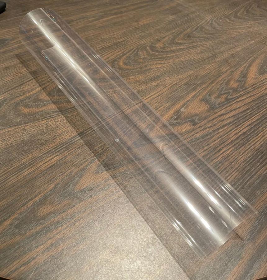

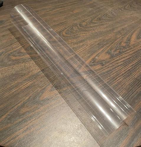

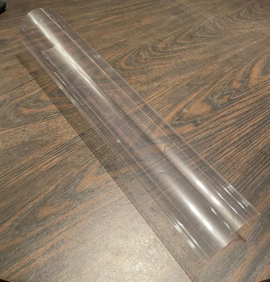

                Put 4 more flights on her today and got some really cool shots!
                I made my lowest knife edge to date... quite excited about that. Pucker factor was high! :o
                And just installed some plastic film inside the nozzles to make the air come out 'straighter', giving a better neutral thrustline.
                So far it seems to have worked perfectly, will post updates on the progress :)

                  I never thought of that , using plastic film, please show picture
                      They're called "thrust tubes".

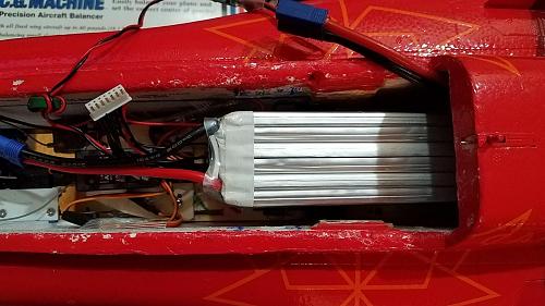

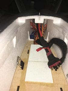

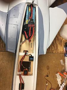

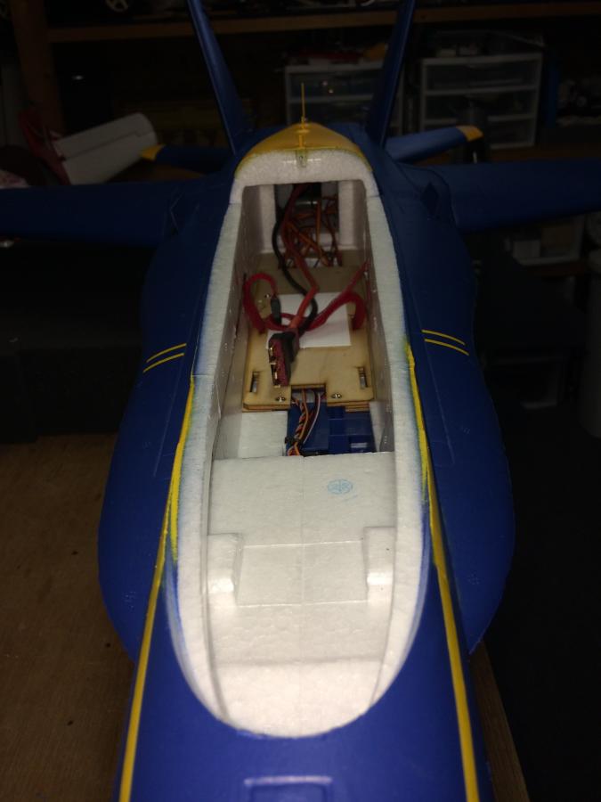

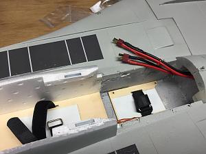

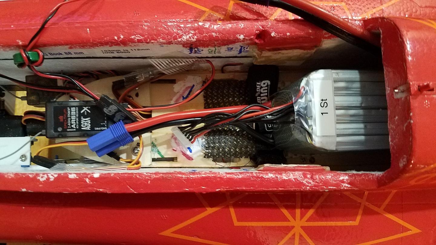

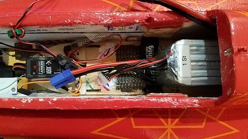

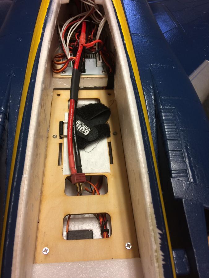

                        While working on getting my 2nd Hornet ready for repainting, I removed the battery tray and the BB from it so I can put the BB further aft, making more room to move the battery back and get to my preferred CG. Then it dawned on me, :exploding_head: there is plenty of room underneath the battery tray for the BB and all the wires. So then I went back to my 1st Hornet and pulled all the wires out and put them along with the BB under the battery tray. My receiver is up front away from the battery and pulled the wires up through the front of the tray. Before, I had a tough time getting my battery far enough back in that one especially with the 3D printed cockpit and full body pilot (all adding an extra 150 gr of weight to the nose) and all the wires were a real rats nest. I was forced to add lead weight in the elevator bay to get a decent CG, but now with cleaning everything up and coving the wires, I have plenty of room to move the battery around. I'll work on the CG tomorrow and no doubt will be able to remove some of that lead in my a...!!
                        So if you need more space to move the battery aft and adjust your CG, just relocate the wires and blue box. You may not need to do this with the stock cockpit, but it's an option that works well, at least IMO. The best part is covering up the mess of wires, including the wires for the afterburners.

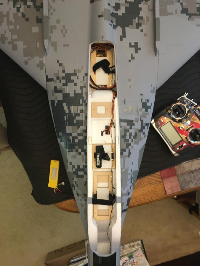

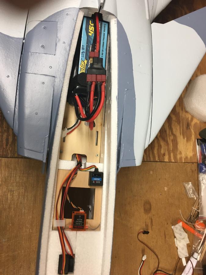

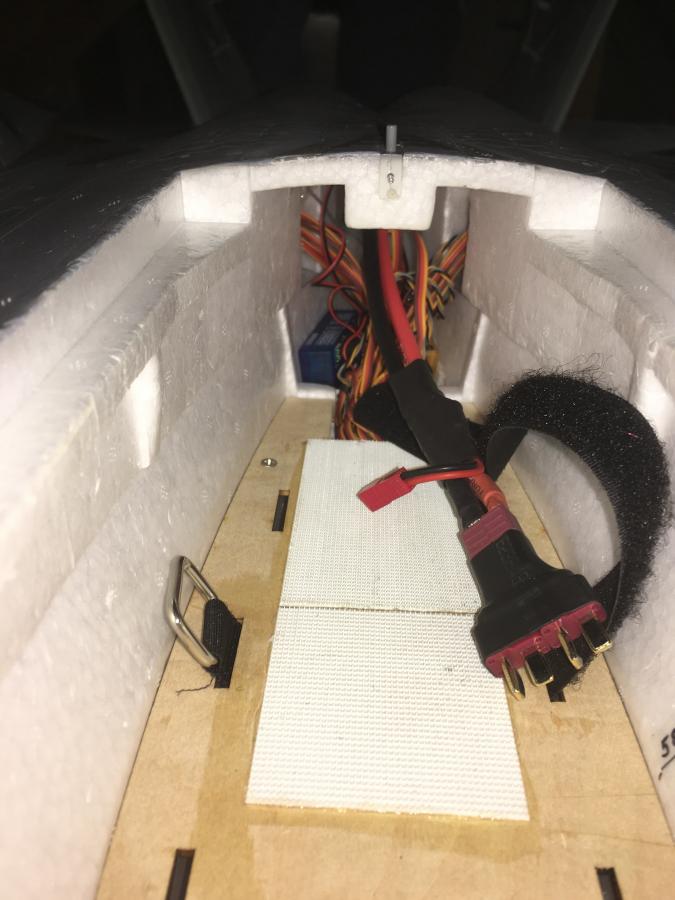

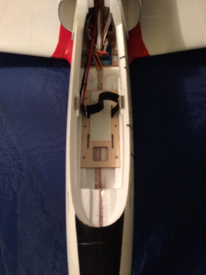

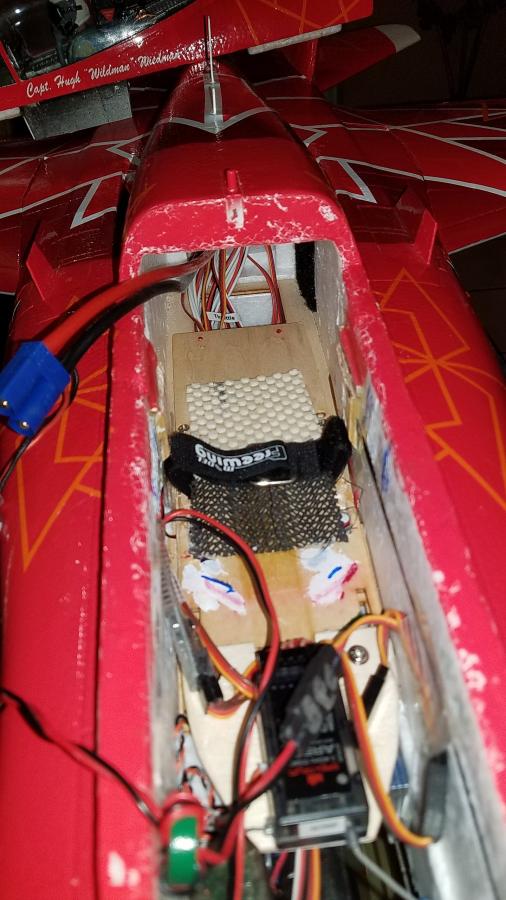

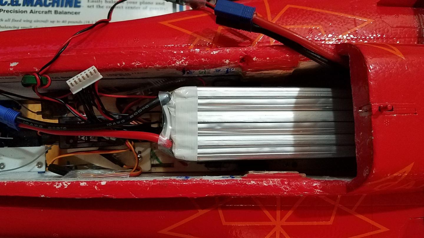

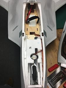

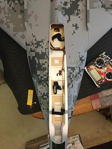

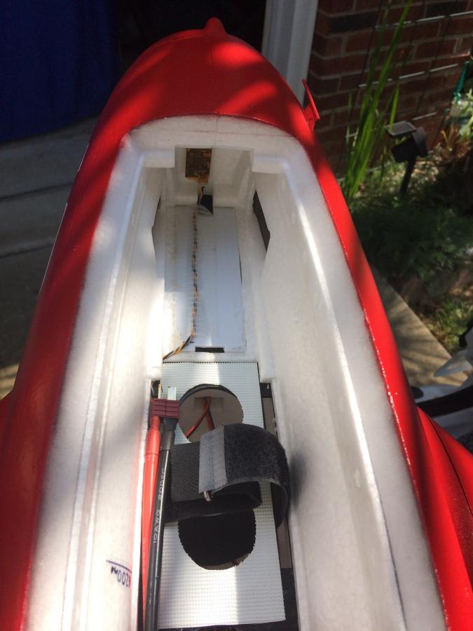

                          It's a great place to put your receiver, light module and other things too. Most planes have room under the floorboards. I also clean up the wiring and close off holes and openings in the foam Here's mine.

                            Evan D now those are some "Clean Machines". Your Mig wiring is impeccable, hopefully I can get close to that with mine, thanks for posting photos, just wish you would have done it a lot sooner to show me the way! Without these expert solutions, at least in my case, even a "Blind Squirrel Occasionally Finds a Nut"!

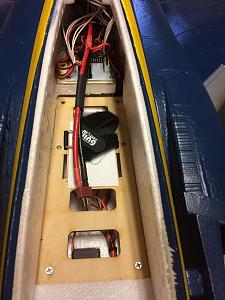

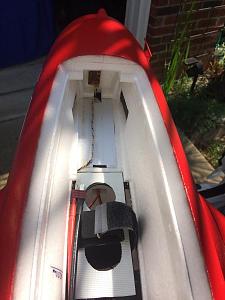

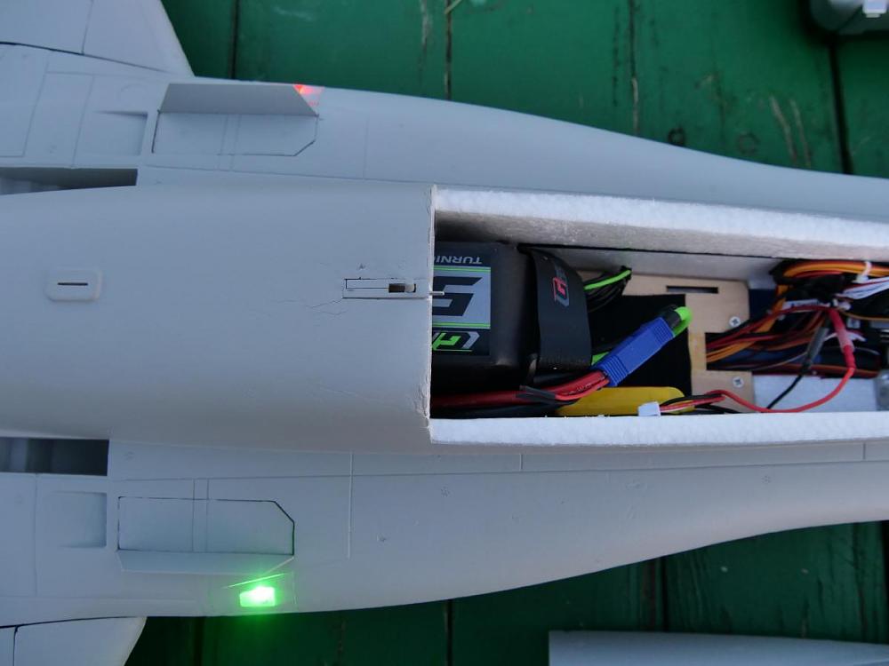

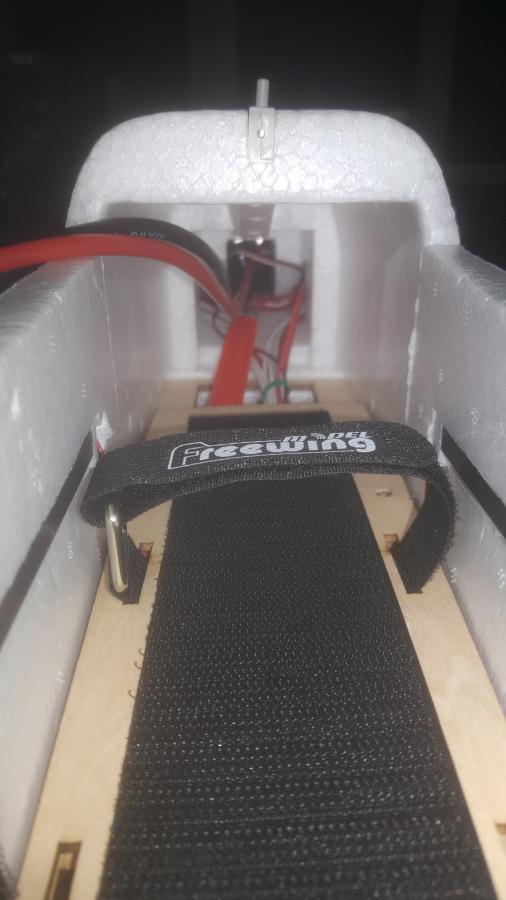

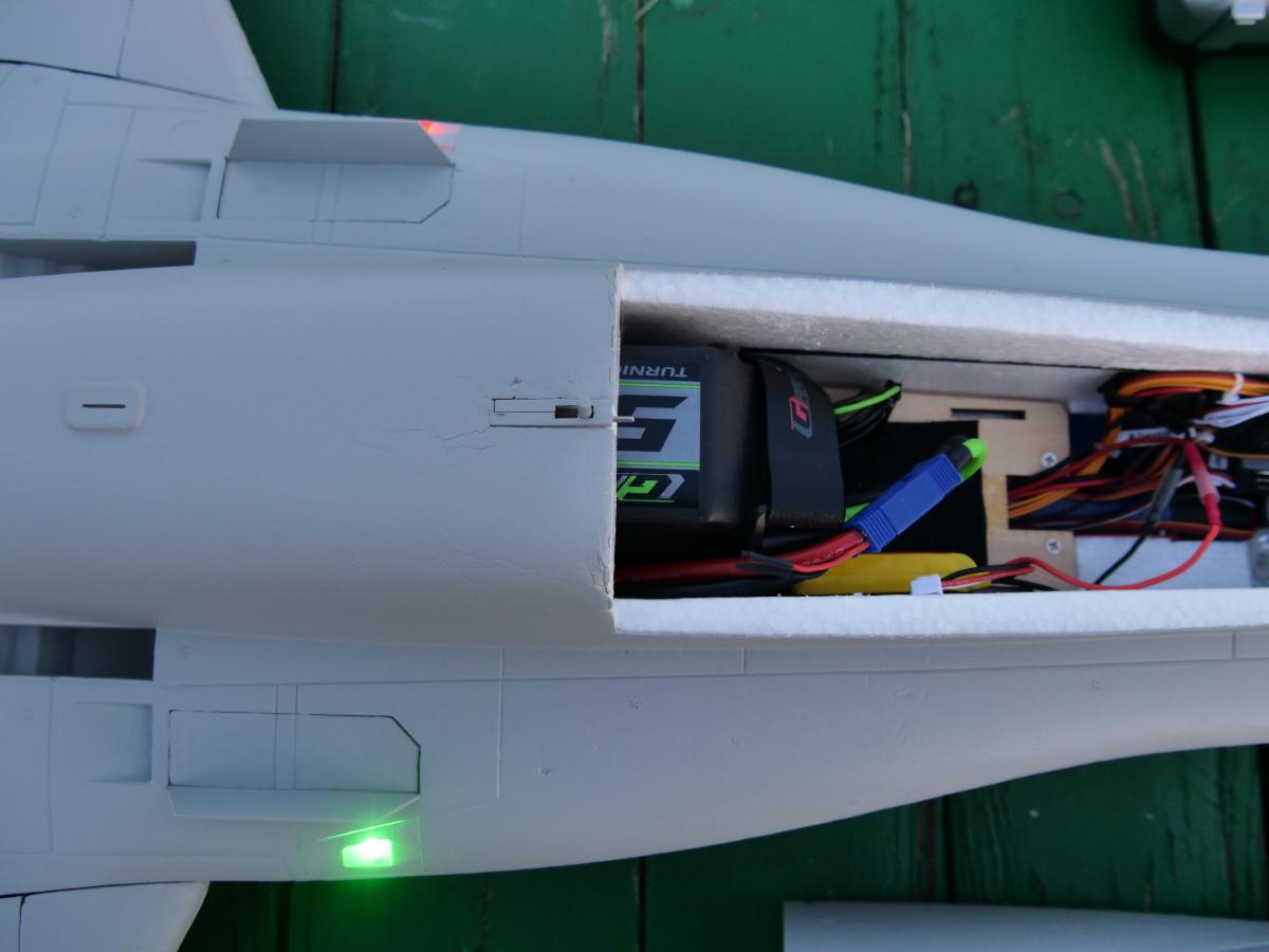

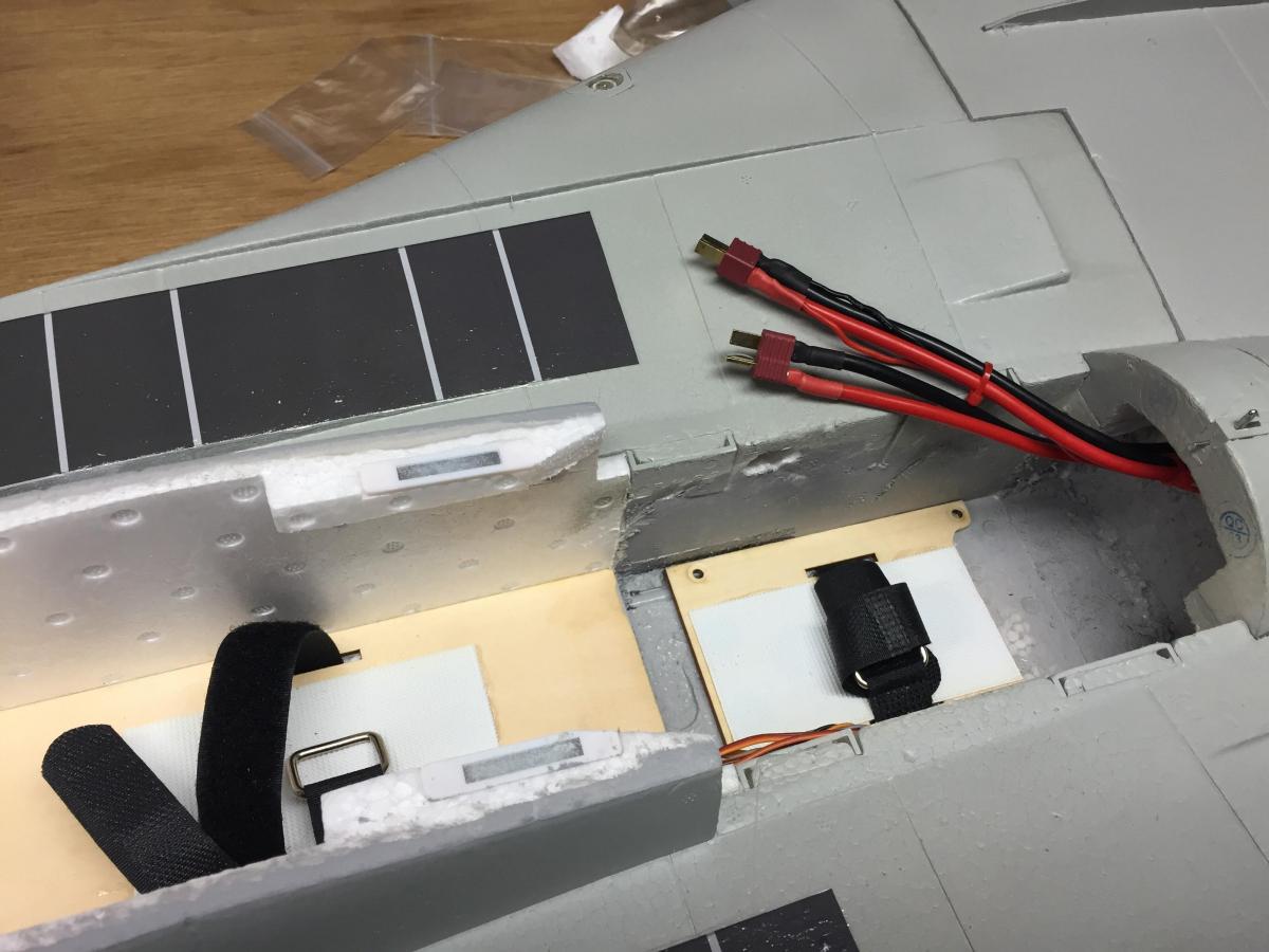

                              I talked about this earlier too... thoroughly recommended to bury BB under tray to have clean battery compartment access. :)
                              My battery packs go fully 'under the roof' when installed on the jet :p
ID:	313383Click image for larger version
                              I have battery even further aft now than what is shown in the picture... but gives an idea :)

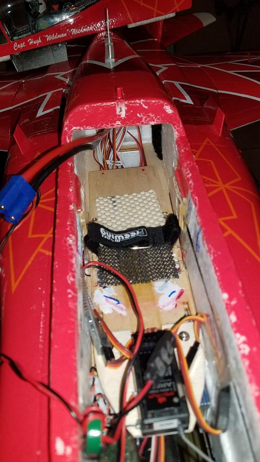

                                        Got out flying today and put the Mig and 2nd Hornet painting on hold. The F-18 Canadian had been flying great with about 30 flights on it with the new 12 blade inrunner, but all of a sudden it developed the dreaded flap issue others have posted. This is the 2nd time out in a row that the left flap (I think), won't go down in flight, yet on the ground and even under pressure it works fine! Reduced the delay to 2 seconds and to 0, yet in flight it's dead! Man, it sure flies squirrely with only one flap in the landing position (drastic roll left-so assume it's the left flap not going down). Virtually uncontrollable until it gets raised. Next plan is to bypass the BB completely. I'd change the servo, but even under heavy pressure on the bench, it works fine, but if bypassing the BB doesn't solve it, guess I'll try a new servo!

                                          #4980
                                          Wow this flap issue is a real thing. I've had it happen on several of these models. Very intermittent. Looks like I should swap out the flap servos as well. Glad you were able to bring her down in one piece Hugh Wiedman!
