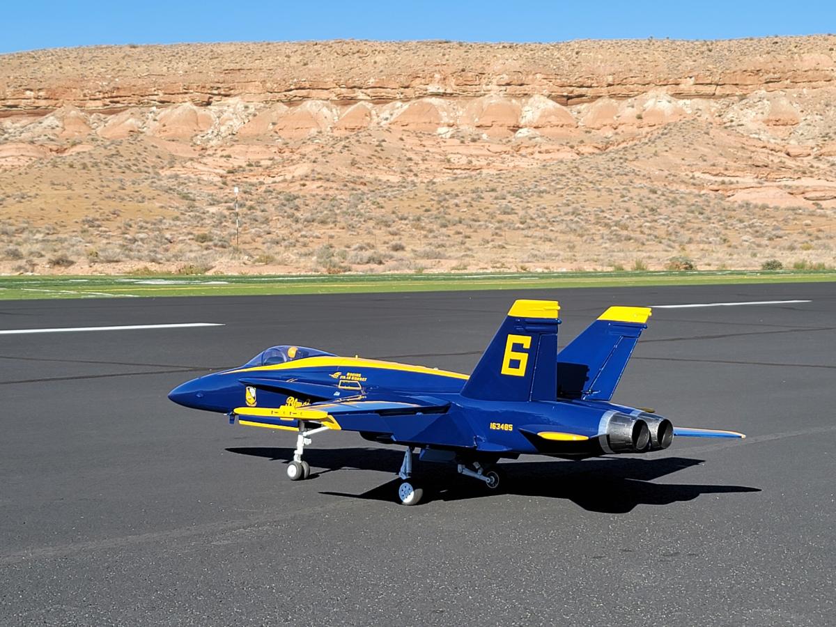

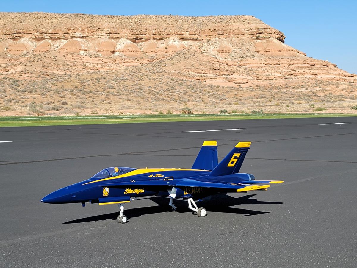

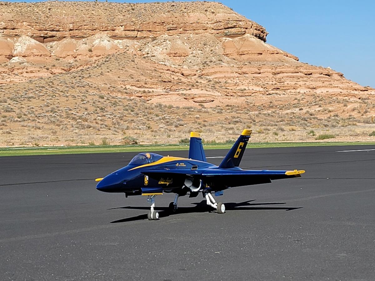

              Put 4 flights on the new gear and paint and i LOVE IT!!! took some tweaking to get the gear going up in air but once i sorted that..it flew awesome!!

                Congrats! Wow Corsair nut I cannot get over how sweet your BA looks! I would swear it was composite!

                  Composite!! I was looking for the rest of the team to roll up along side in the photo it looks so real! I could swear I saw the pilot give the "Good to Go" Salute!
                    #5149
                    You're right! That first shot you would be hard pressed not thinking it wasn't full scale! Wow thats a beaut! Major BA envy over here!

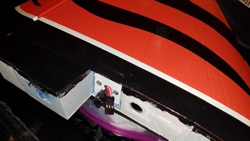

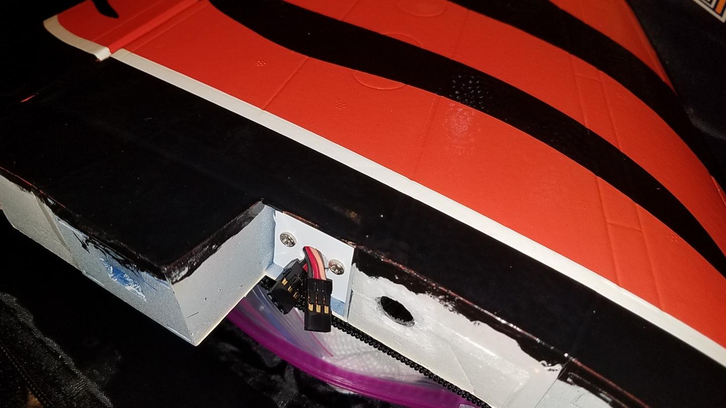

                                  What are the wing-PCB breakdown boards? I have each of my wing ailerons & flaps servos plugging directly into my RX on both of my Hornets, primarily because I experienced an issue with flaps on my first Hornet and couldn't get both to work in the air (worked fine on the ground) even with taking flap deployment to 0. I just removed the existing board on each wing and plug the wing servos directly into leads that go to the RX. Not as quick and easy as the stock setup, but have not had a problem since bypassing that main control board. By the way, I've had issues with several FW/FL planes with intermittent flap deployment (B-24/Avanti/F-18) that all have the circuit control board (as opposed to the actual blue box). Have yet to have a problem with any with the actual Blue Boxes. Just a thought.

                                    Airguardian if there's a board out there that fits into the Hornet wing for the aileron and flaps, I'm all ears. Just didn't need the extra wires of a ribbon cable and needed to bypass the circuit board. Fortunately, there are no wing lights that need to go through it to reduce voltage on. I have a tendency to do things kind of "half a..sed" so anything that works better than what I've got I'm interested. This is my current "Rube Goldberg" (a distinctly American 60's/70's term that many of you may not get) set-up:

                                      I mean the small little green PCBs that come on the wing side which have a ribbon cable input on one end and servo connectors on the other.
                                      I think you can supposedly use those on the opposite side of the ribbon cable to put out individual servo leads again, so they don't get mixed up in the BB. Would have the benefit of still being able to connect the wing using a single connector which is convenient.
