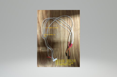

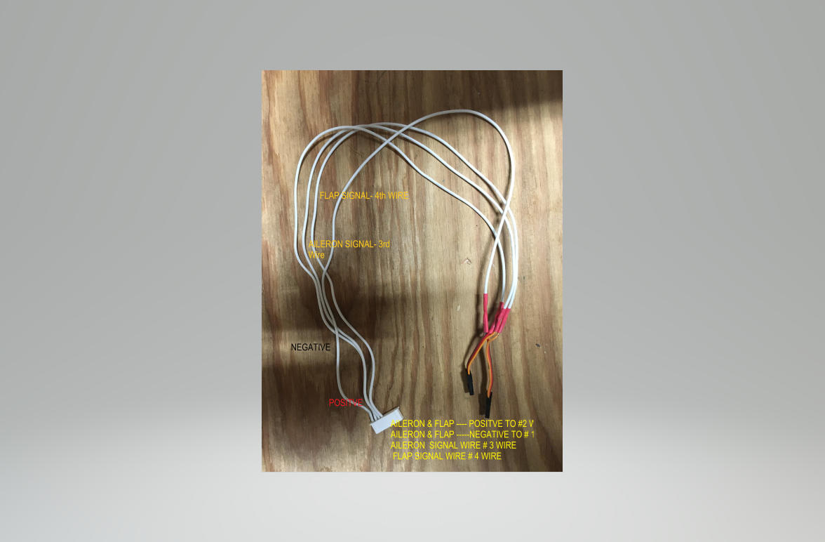

    Seems to be alot of questions concerning the BB ( Blue Box) on the Freewing Jets. Most seem to revolve around the F-18. Not willing to take any chances on when and if it fails I went straight to the receiver for all control surfaces. Attached is the wiring I did for the main wings (Ailerons & Flaps ) The Elevator and Rudder I just used Y-Connectors. Click image for larger version
Name:	BlueBox By-Pass.jpg

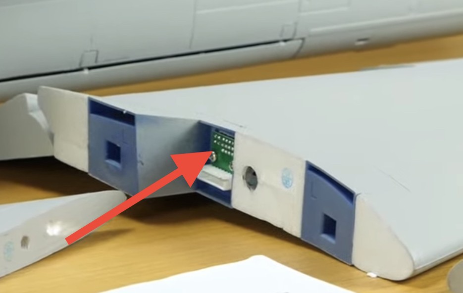

                      Help! I just got the new Freewing F-18C today, the grey one painted up with the VFA-146 decals. I have it partly together, but discovered when I hooked up the flaps and ailerons to my Spektrum receiver, some weird things happened:
                      1) The Left Flap and the Right Aileron move together when the Flap Switch (AUX 1) is moved.
                      2) The Right Flap and the Left Aileron move together when the Aileron stick is moved on the transmitter.
                      I traced the leads to the Blue Box, and the leads seem to be plugged in correctly, as they do on my Spektrum Receiver, too.
                      Has anyone had an issue like this on their F-18s before?
                      Thanks for any help on this,
                      Davegee

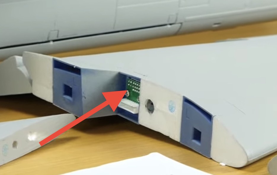

                        On the wing connector electronic boards (can be removed via the screws to inspect), have you confirmed that the correct servo leads are plugged into the proper slots on each wing board?
                        Pictured below and with the arrow pointing to it is the electronic board that can be found on each wing. Once removing the screws, you can then gently pull out the board to reveal the Servo plugs that are attached to it. Look at each of those Servo slots to confirm they are plugged in properly.

                          Thanks, T Cat. I had not checked those yet. I’ll do that first this morning. If they are correct, I’ll changeout my receiver with one from another plane just to be sure nothing is wrong with it. I did test every channel earlier, but I think it had been involved in a crash some time ago as there was a small crack in the plastic housing that I fixed with a drop of CA.
                          Appreciate the tip, hopefully that is the fix!

                                  Thanks, T-Cat. You were exactly right! the Left wing was plugged in properly, but the right wing had the aileron and flap positions reversed for their plugs. Once I made the change, all flap and aileron movement is now normal. This was a brand new in box kit, so I think the mistake was just done at the factory. Fortunately, it was an easy fix.

                                          You’re welcome . I’m glad it was something quick and simple to fix. With the factories and assembly done by people, there is always a chance of something like that occurring. On each aircraft I get with quick connect plugs, I unscrew the board and check all the connections to confirm they are correct and that all Servo leads are seated properly. It always makes me feel better and I feel it’s part of my duty as a pilot to make sure it’s ready for flight, among the other typical things all of us pilots inspect before flying. It’s worth the little time it takes .
