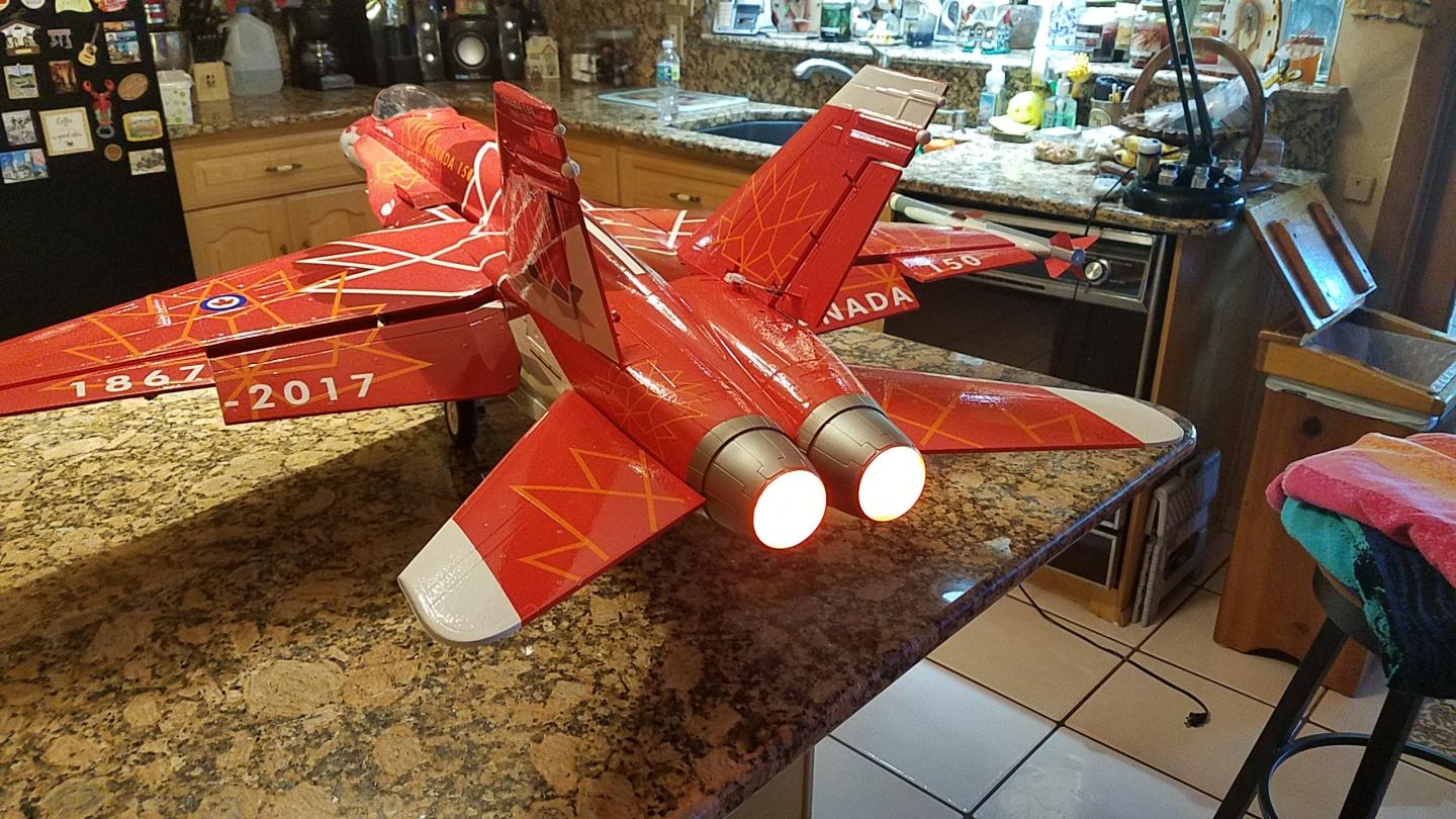

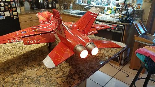

    While waiting for better weather/winds to maiden my new Freewing F-18C, I decided to improve the stock cockpit a bit. That grey interior didn't do anything for me. I pulled the canopy off and added a few details. I repainted the pilot to some photos I saw of the VFA-146 Blue Diamonds pilots back in the day and added some squadron patches to his helmet and shoulder. Added a paper instrument panel, some canopy handles and rear view mirrors, fabricated a rudimentary HUD, and repainted most of the grey interior black. I plan to use this cockpit pretty much for the maiden and several flights afterwards, and eventually get another cockpit and use Elbee's excellent stl files to make up a more scale and detailed cockpit.
ID:	334115Click image for larger version
    Thanks, Aros. As I mentioned, my plan is to eventually get the stl parts made up courtesy of the hard design work of Elbee, and make a second cockpit that will be a very accurate representation of the Hornet. For now, with upcoming initial flights whenever the wind and weather improve someday, I'll use the stock cockpit. I just had to make a few improvements on it!

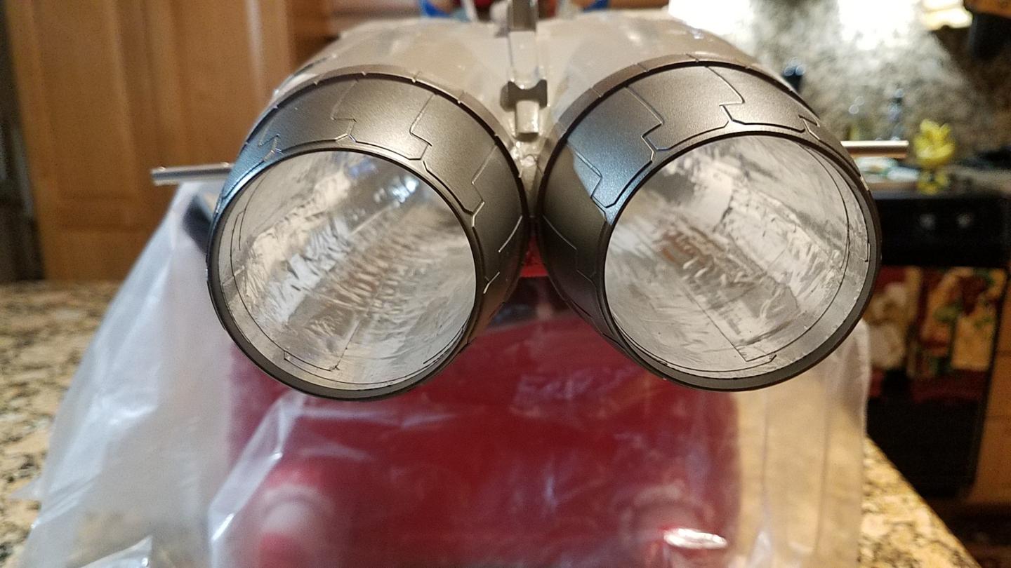

                      The one thing I think can be better is the exhaust nozzles if you install an AB (certainly worth it-have one in ALL my EDF's except A10). Rich painted them white, not bad, but take the extra time to put aluminum A/C duct tape instead. Makes it Soooo much better than even the white.
                      Click image for larger version  Name:	20200426_183556.jpg Views:	0 Size:	135.8 KB ID:	335395Click image for larger version  Name:	20200427_173439.jpg Views:	0 Size:	231.0 KB ID:	335396

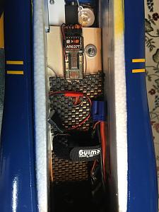

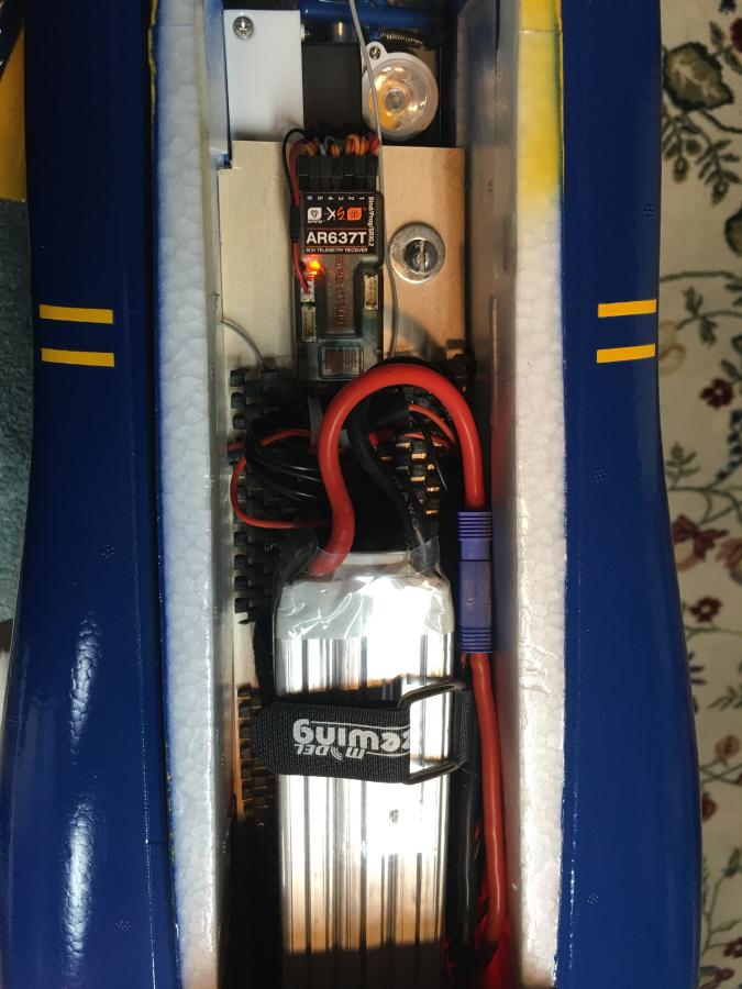

                            Falcon195---- Yes I have done the RCInformer battery tray update on both my F18 Blues. I also fly off grass and although we get it as smooth as possible it still has its areas that will give a front nose gear a work out. I figured anything that will help her on the ground is worth doing. I made my own tray and put about 5 coats of poly on it to help stiffen it up some more. Also used a machine screw and nut to re-enforce the front gear mount. If you rip out that front mount it's a bitch to replace since its in the foam..... Just my thoughts...
Name:	Battery tray w battery 1-23-22.JPG
ID:	335418​Click image for larger version

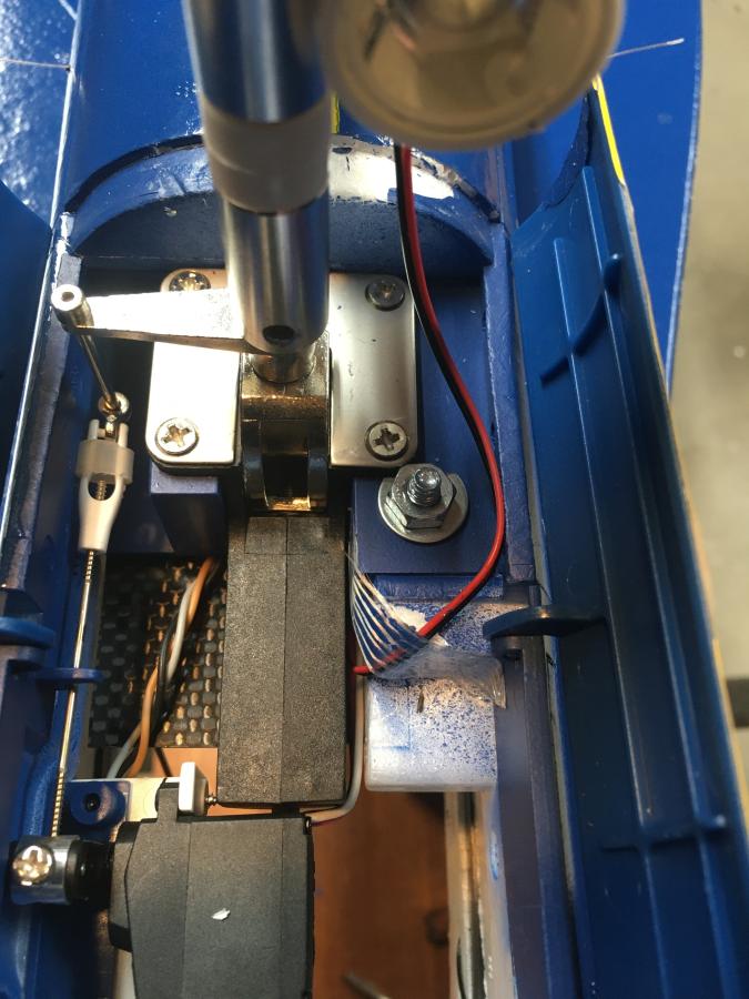

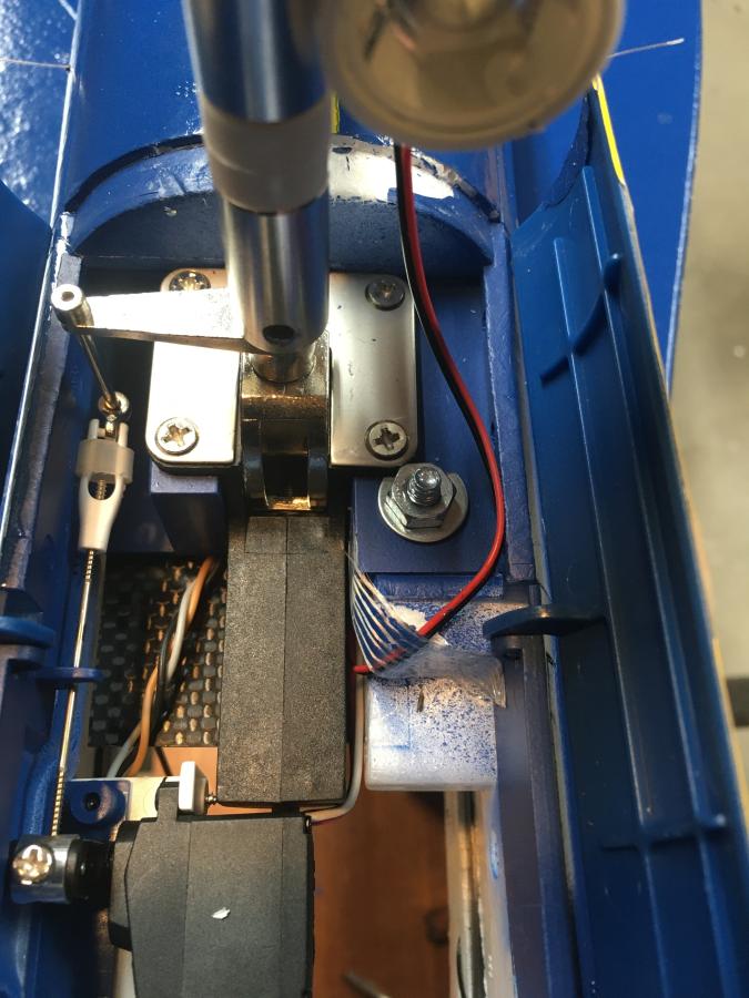

                              What I understand is Freewing has made some kind of improvement on the way the elevator servos mount. I wonder if they are using something similar to RCinformer's modifications to the elevator servos mounts. Can anybody onfirm this?

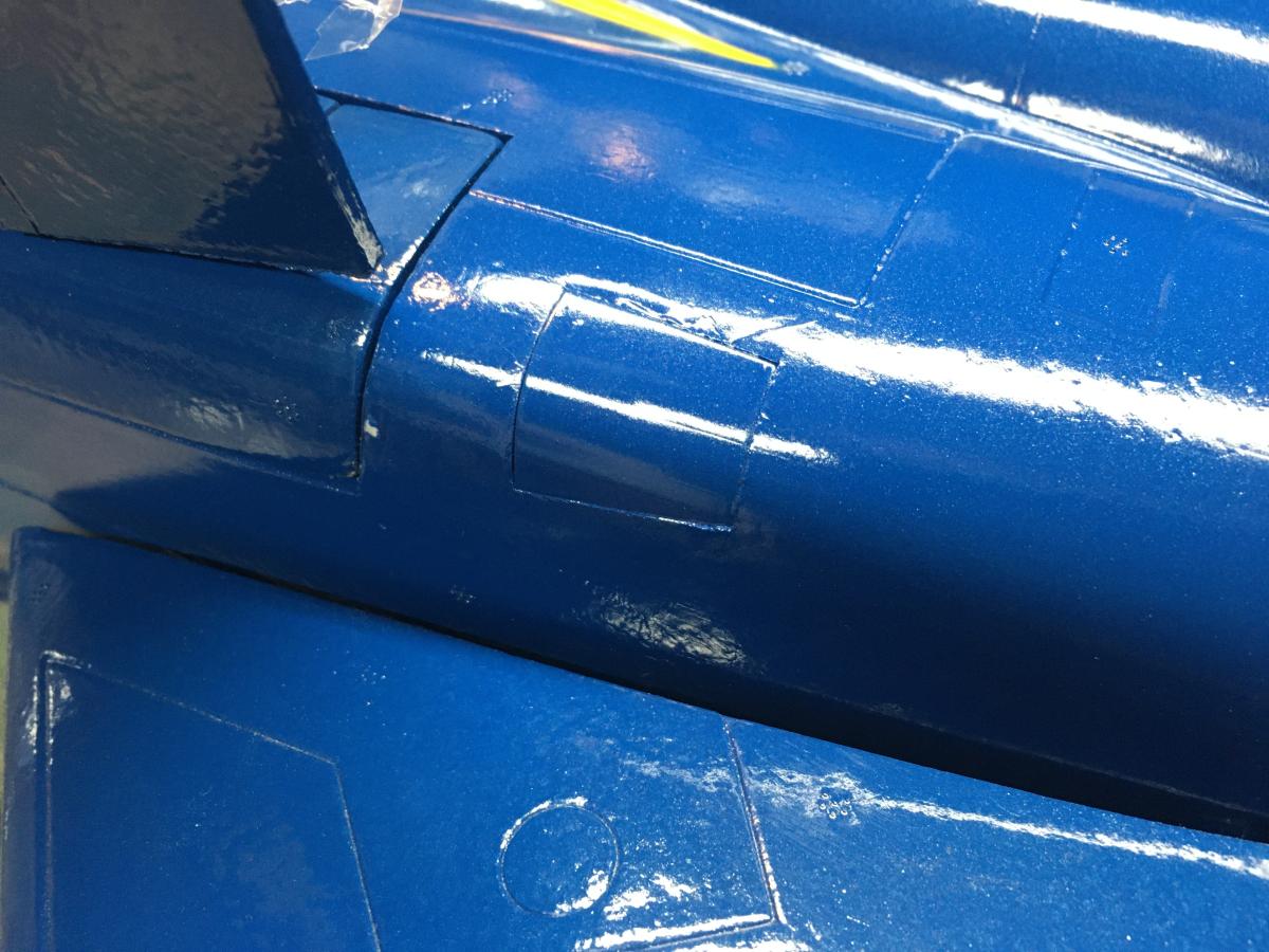

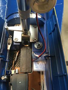

                              Falcon195... Version 2 has small access panels in the rear fuse behind the rudders. I have both versions and one has the panel and one does not. Click image for larger version
Name:	V2 Elevator update support close up 1-23-22.JPG

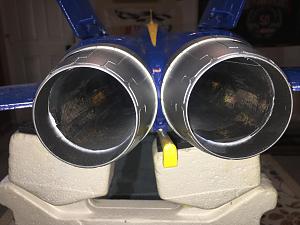

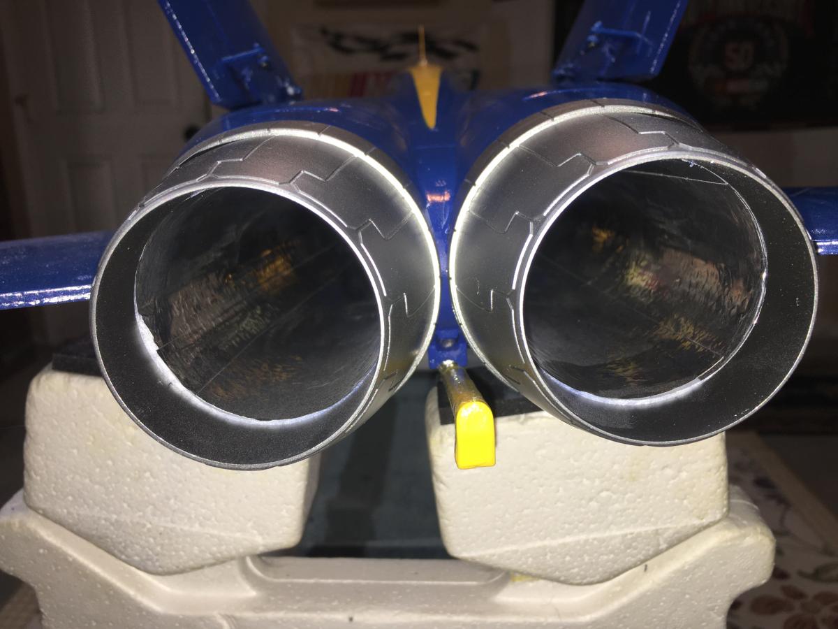

                                ​​As with Hugh, I also trimmed out my exhaust tubes with the chrome vent tape. It takes some doing but well worth it to get the full effect of the afterburners. Best to do with the motor out and take you time , that stuff is sticky. Make sure you extend the tape past the motor housing, it will help it from peeling back.
Name:	afterburn 1-23-22.JPG
                                Click image for larger version  Name:	foil burners 1-23-22.JPG Views:	0 Size:	105.5 KB ID:	335424​​

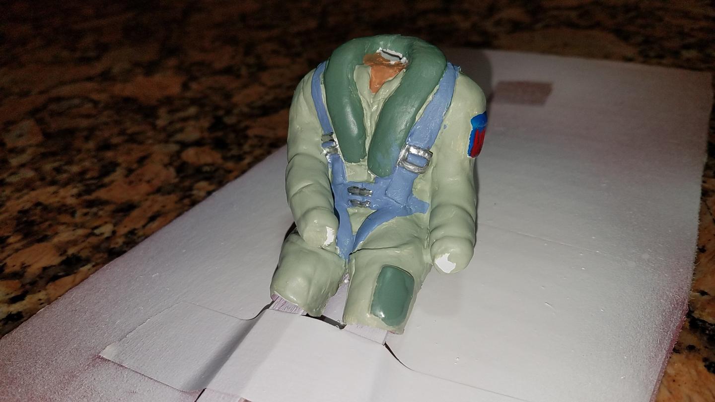

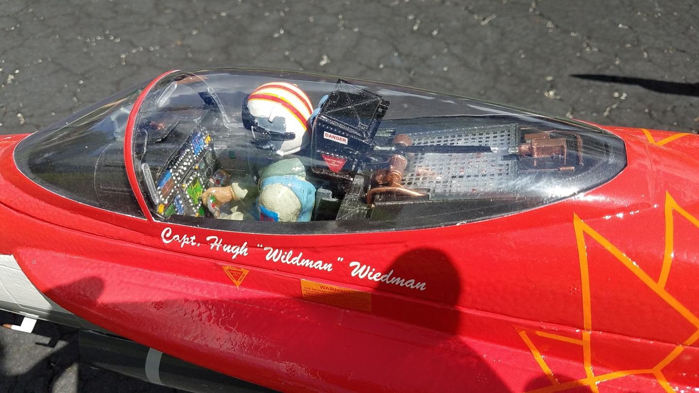

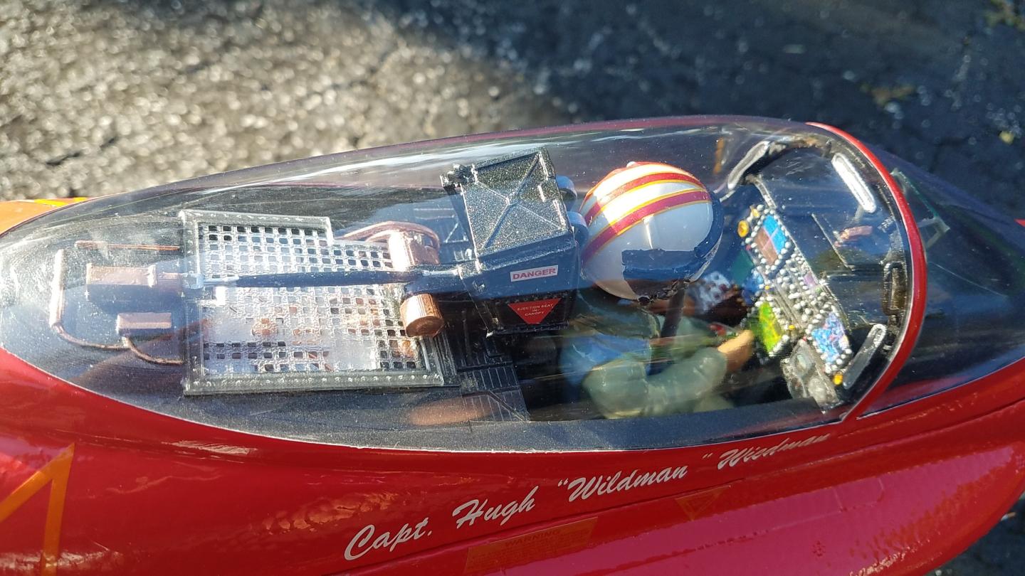

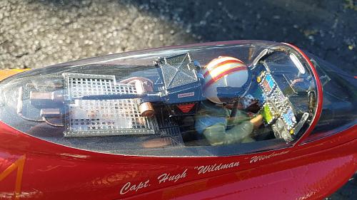

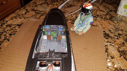

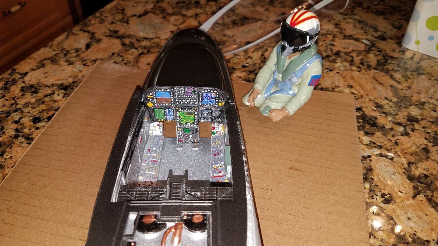

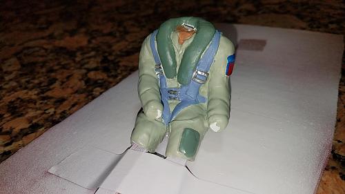

                                        Hey Jay, there is another option for the pilot if you are using the fabulous 3D cockpit Elbee designed. Obviously his 3D printed pilot is the "gold standard", but if you want to go a quick and lazy route (my middle name), I put the Jet Hangar Hobby 1/10 scale full body pilot in and just trimmed his legs a bit and shaved some fat off his rear so his head didn't reach the top of the canopy. His knees then go right up against the holes where his legs would go through so it doesn't exactly look like a shark got him last time he ditched into the ocean. :face_with_symbols_o He's a bit larger than scale but I like to have "Clint Walker" type pilots who seriously abuse steroids to guide my aircraft. Just a little more intimidating when going after other foreign bogies with "girly men" in them.

                                          Elbee commented
                                          Editing a comment
                                          Definitely the common-sense pilot option, my friend. Again, beautiful cockpit mod, Hugh. Best, LB
