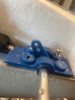

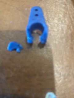

              I recently acquired this model from a friend, it was new and still in the box.
              I have been having some trouble with the control horns for the elevator/stabilator. I cracked one of them installing the control rod, and noticed the second one had a nick in the end. I applied a little bit of pressure, and it cracked completley.
              I order replacements from motionrc, which unfortunately only come in a complete kit. With shipping, it is almost $30.
              Both sides went on fine, and I am very careful when screwing in to plastic to not over tighten. They were not damaged when I installed them.
              When cycling the controls, I noticed one of the horns was wobbling, so I took it apart. I found the entire horn had shattered on the bottom, where it screws into the control rod.
              Does anyone know a 3rd parts solution, maybe out of aluminum to replace the freewing control horns for the elevator?
              I have sent an e-mail to motionrc to see if I can just get the control horns. I have a hard time justifying another $30 to get one. If not, I may try and engineer and 3d print one, but I would be a little bit nervous about that.
              Sorry for the blurry pic. There were several other smaller pieces too.

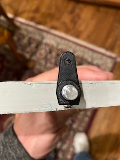

                  The second one ended up failing as well in the same fashion. I heard back from MotionRC and they only sell them with the entire assembly, and do not know of any other similar horns that are available.
                  I modeled and 3D printed it in PETG and it seems to be working well. We will see if I am brave enough to maiden it tomorrow.

                    Slice, you would be wise to not fly it tomorrow or at any time with 3d printed horns. I'm looking out for you here. Horns are not just any kind of plastic and certainly not splinter prone 3d printed. This is your elevator we're talking about. That horn is the most important piece of the puzzle. I, for one, would never risk a high dollar aircraft on that. In fact, I am going to check my stock Freewing horns just because of your incident. Thanks for posting your problem and helping others.

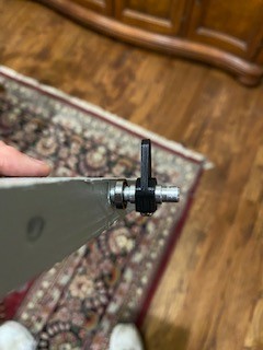

                      I did beef them up a bit from the stock ones, and used all the tricks I know to make them stronger. I've done some destructive testing on them, and they are stronger than the stock ones I have, but I really think I may have received a bad batch.
                      They are printed with PETG, which fails more like ABS than PLA does. PLA will shatter and crack. PETG bends, warps, and stretches when it fails. At this point, I don't know if I would trust getting another set from Freewing either.
                      I would bet $100 they would work fine, but I don't like the idea of flying with them. I really wish I could find some aluminum ones. I may submit the design to get a quote to have a couple milled.

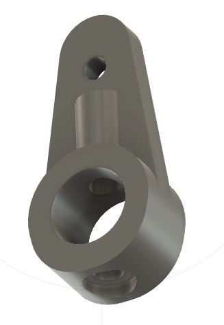

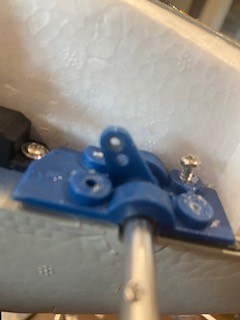

                        I woke up early and started thinking of a better solution for the stabilator horn. What I did turned out well. It is a lot more solid than the stock one. The winds picked up, so I didn't get a chance to fly it today.
                        What I did was utilize a 3mm x 20mm socket head bolt in place of the screw. The bolt carries all the way through the rod and into the other side of the control horn. Because of the way the part is stressed, it was printed horizontal on the bed, which makes for a tricky overhang with support material with PETG.
                        I have very high confidence in the part. It is quite solid.

                                Freewing does make a metal version of this part. It's used in the 90mm F-4 Phantom. Unfortunately, i think you have to buy the whole tail assembly for something like $35 just to get one of them...
                                  Good to know, thanks. I wish you could buy them individually.

                                    This? Not sure the shaft size is the same.
                                    Freewing 90mm EDF F-4 Phantom II Elevator Plastic Part [FJ31211089] Motion RC
