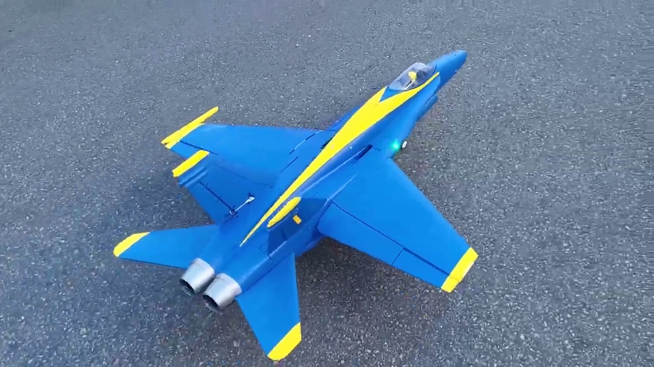

        I finally got to fly my first flight on my Freewing F/A-18C by myself this morning, before the winds pick up. The first two flights were done by a friend of mine in the club. The first flight was a bit scary, I think it was due to my putting on some foam F-16 pylons under the wings that I can only think bent in the slipstream, and caused some real trim issues. The second flight he flew without any ordnance or pylons and it flew much better. Today's flight with me at the controls went pretty well. I'm glad I've been practicing with my A-4 and F-4. That seemed to help, as well as doing a warmup flight with my reliable T-33.
        I added a Spektrum AR637T receiver in the plane after the first flight and that seemed to help some, too. I have a second cockpit using the super cool printed parts from Elbee, but for now use it as a static cockpit until I rearrange the fuselage innards to accommodate the extra space needed and CG changes. Also has a RC Geek simulated A/B lighting system, which looks pretty cool, I think.
        I took a few pics after the flight. Stock build, stock set up and recommended settings by the manual and other Hobby Squawk folks. Did paint up the pilot a bit with helmet insignia used by VFA-146 Blue Diamonds.
        Used a Admiral 5000 50C battery, about 3 1/2 minutes total flight time.

          Great Stuff Dave, congrats on the maiden. You may want to go to an SMC 6200 40C battery to give you another minute or so (have my timer set at 4:20 but always go a bit longer with the in-flight voltage alarm with the voltage telemetry cable the RX comes with). You'll also find that the Admiral 50C is more like a true 25C where the SMC's are right around 39C (and only 100 gr heavier), which will give you a bit more punch and longer flight times.
          BTW, if your getting comfortable with the F-18, you shouldn't worry much about the Mig, just keep away from the 2 issues discussed (but with the new fans and the TV nozzles, only the high speed pass with full flaps would be a problem).

            Thanks, Hugh. I'm going really easy with this plane for now. I have put two of these in the dirt years ago, so I want to try and avoid that in the future! On both those we played with tailerons, full span flaps, etc., and that might have contributed to the problems, not sure. I think for me at least, I have plenty of power even at this altitude, and I'm pretty content with a 3-3 1/2 minute flight profile. But I'll consider the bigger battery in time. If I go with flying the printed parts canopy, I might want a bigger battery, or at least shift mine back to compensate for the weight of the full cockpit.
            I did finally get that "fat ass" pilot like what you have. It took so long to get here, that I had forgotten all about ordering it. In the meantime, I found that smaller, lighter pilot, and I think I'll put "ol' fatass" in storage for another project someday. He would have needed a lot of "persuasion" to fit in that seat!!
            Oh, although this is late, Congrats on getting your Russian jet fighter in AMA magazine. Looks great!
            Cheers
            Dave

              Congrats davegee on the successful maiden! She's a looker for sure!

                Thanks, Aros. I have to admit I had some trepidation about flying this airplane, being that I "killed" two of them several years ago. But it flew well, similar to my A-4 and F-4, and after three flights now, is still unmarked. I consider that a good thing!! I hope to get many flights with it and my other planes this summer.
