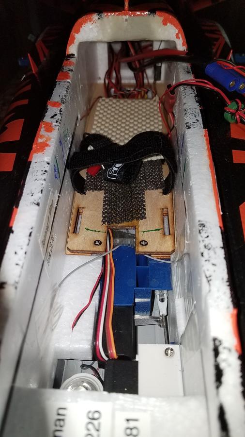

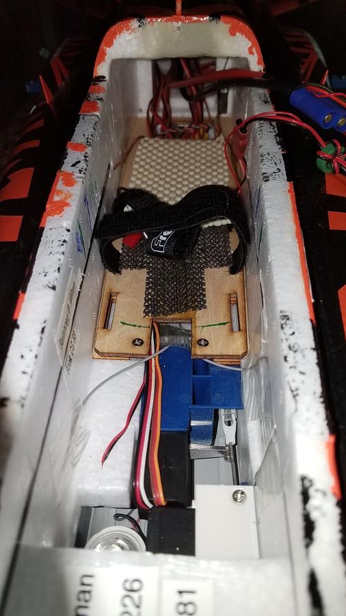

                  3) In both my Hornets, I'm using the AR637T RX with AS3X. Initially located it in the back, then after several (I think it was probably Air Guardian) in this forum suggested I relocate it under the battery tray, I did. It now sits completely UNDER the battery tray as far forward as possible with the 2 antennae coming out and going way up in the nose. All wires (except the power cord and BEC wires) are out of the way under the battery tray so it makes for a clean set-up and I can put the battery anywhere I want to. Also added a remote satellite that goes all the way back in the front fuselage at the foam divider. I now try to do that in all these aircraft. It was a real space saver in the Mig, although with all the extra wires for AB's, TV nozzle wires and 2nd gyro for the TV's, it was a real tight fit to get everything under the back tray, but keeps it real clean.
                  Click image for larger version  Name:	20220329_142151.jpg Views:	0 Size:	68.0 KB ID:	341015
