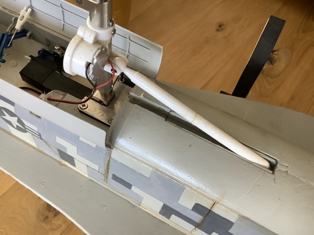

                              • Polyphren
                                • Dec 2020
                                • 37
                                #5175
                                Hi yamr663304, I assume you‘re talking about this plastic strut. Mine broke, too. I fixed it with a thin carbon bar inside and epoxy glue.

                                    Hi Polyphren. Yes, that's the strut I'm talking about. Thanks very much for the input...I like your idea of using a piece of carbon fiber in the channel of that strut.

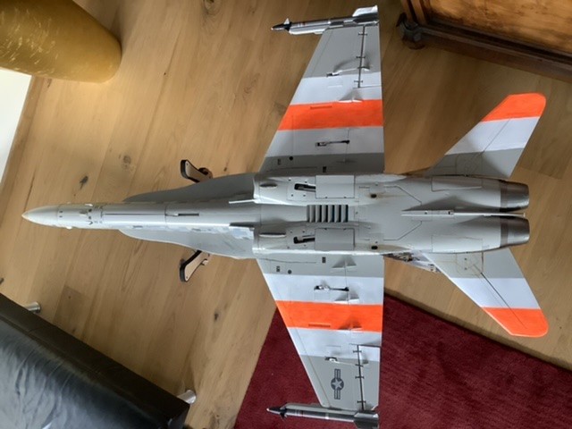

                                    • Polyphren
                                      • Dec 2020
                                      • 37
                                      #5178
                                      The digital camo scheme works impressingly well in a cloudy sky. I nearly lost orientation after an unexpected stall and the following downward spiral. Due to better pose recognition I decided to add white and neon stripes to the back side. I‘m looking forward to the next flight in a cloudy evening sky.

                                      • Airguardian
                                        Post Stall Svengali
                                        • Aug 2020
                                        • 1664
                                        • Catalonia
                                        #5179
                                        That white-orange striped scheme looks really well, I like it! :D
                                        With the Hornet it's not just about the livery, but also the fact it is slightly smaller than similar jets and usually gets away faster, so it's easier to lose sight and orientation than with most. It even has affected me several times, and I am not one to suffer much from orientation problems, even with fully-grey camo birds!
