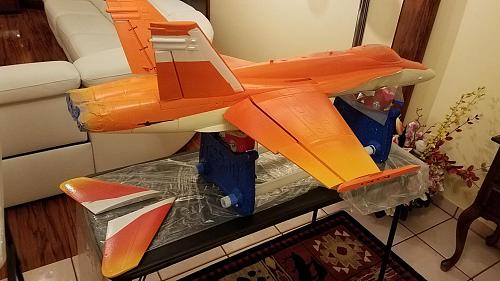

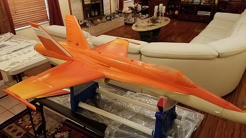

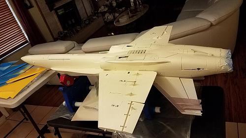

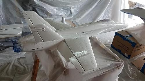

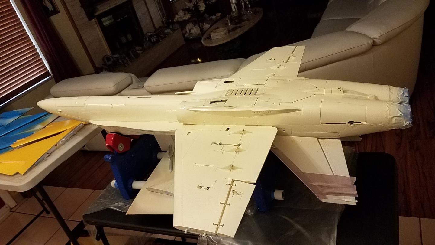

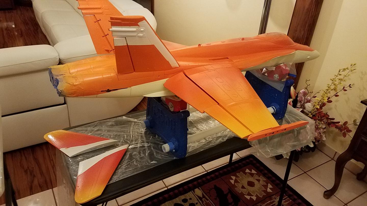

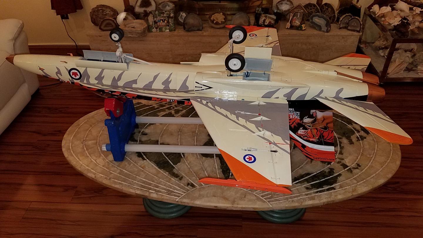

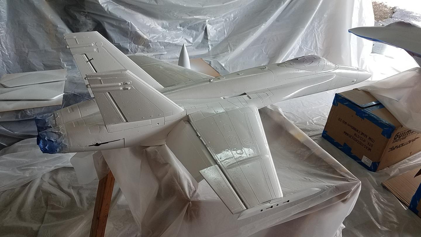

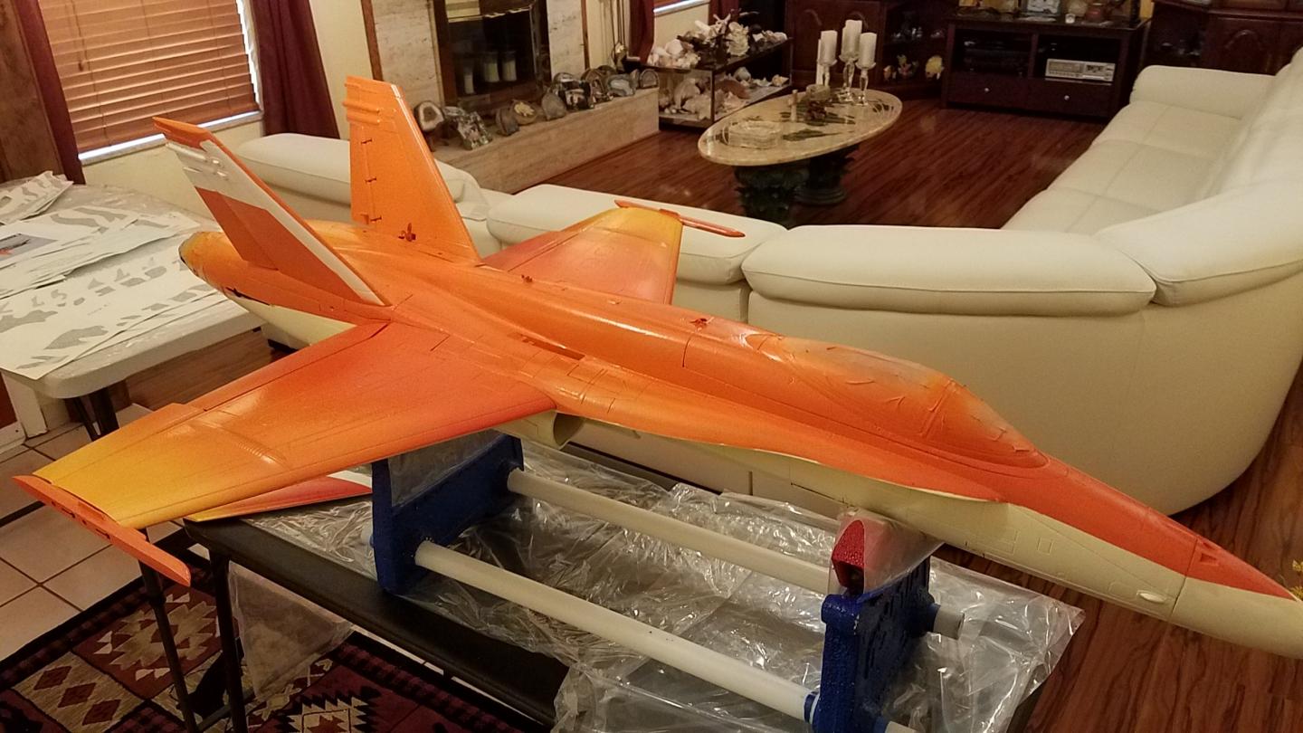

    Speaking of EDF's, a little sneak preview of my nearly completed F-18 number 2. Got it, along with the Mig, the day before the price increase and have been working on the repaints of both for over a month now. Picked a livery that it turned out was even more complicated that my first F-18 I did in the 1867-2017 Canadian scheme. She needed a wing man, so came up with another Canadian version, but one I haven't seen much around. Now I now why; it was a B..... to do! I'll post finished photos in the next couple of days (when/if the rain stops :cloud_rain::cloud_lightning:), but here's some early on ones from several weeks ago. Anyone care to guess what the livery is? (And it's not Linus's "Great Pumpkin" from Charlie Brown). The Mig is about a week out from being released! My garage, kitchen, main foyer and office/hangar has been been littered with aircraft parts in various stages of painting for over a month and finally today most areas have been cleaned up, just in time as my wife had an appointment with a divorce attorney! :hot_face:

      Looking good!
      I want to get my hands on some SMC batts so badly... T.T

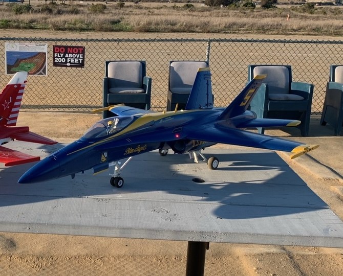

        I'm guessing this.Click image for larger version

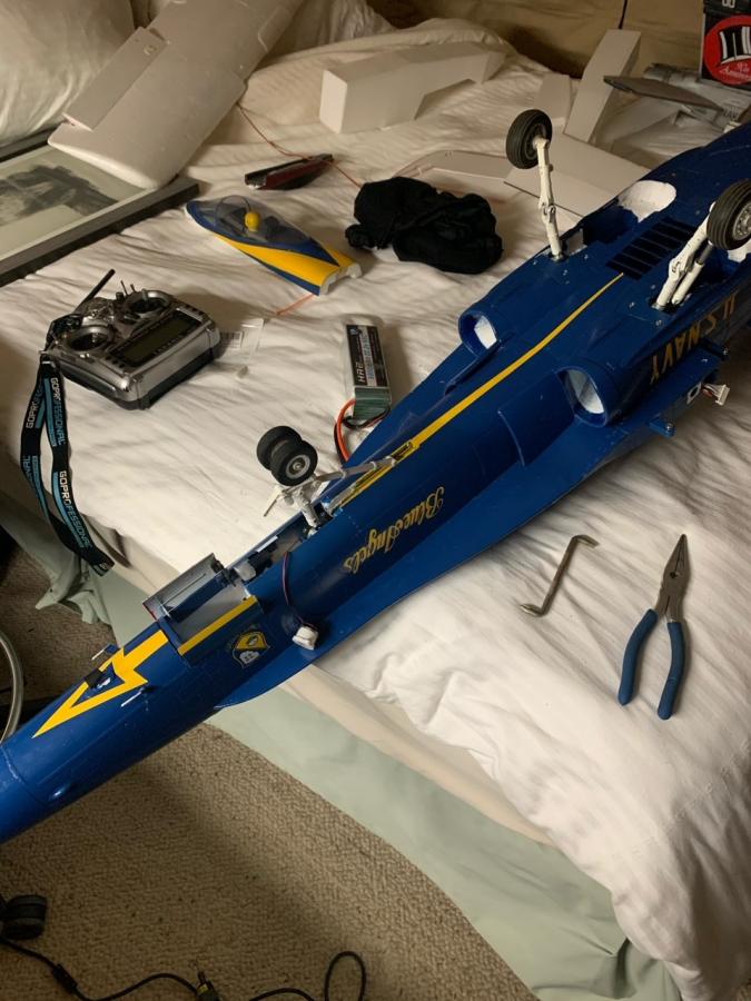

          Hi guys,
          Did anybody try to Exchange the landing gear of the f-18 with the eflite 80mm f-18 because of the scale look?
          Best regards
          dario
          Yes I did the swap along with 'fix'ing the doors. Quite a bit of hacking involved but pleased with how it turned out.

            Hugh, you never fail to amaze. Your fleet is definitely taking on a theme. Looking forward to any and all pictures and info from you, Sir. Thank you for the battery updates as well. Best as always, Steve
              #5006
              Hugh Wiedman Please leave the key to your workshop under the doormat in the back. I'll swing by and.... "borrow"... that orange Hornet as soon as you're finished with it, please and thank you. :call_me:

                You win the lottery, unfortunately the funds have already been withdrawn by my CO!
                Finishing it today but still raining outside and need to get some decent pictures. Alpha, you can "borrow" anything I've got!
                  #5008
                  Oh momma!! Hugh Wiedman you continue to outdo yourself. I can't wait to see the finished results!

                    That looks great, now that's what Freewing should have worked on before it was released, that was one of the reasons I sold both of mine, that ugly gear....

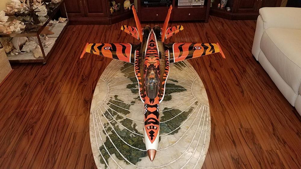

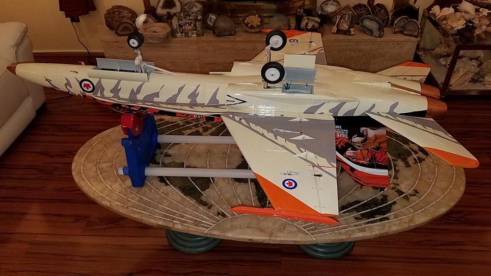

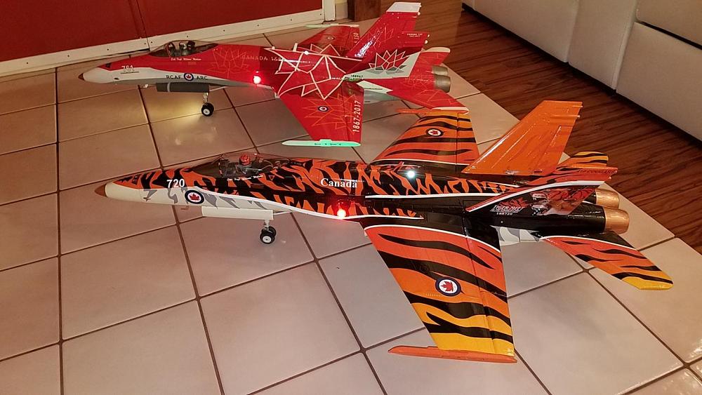

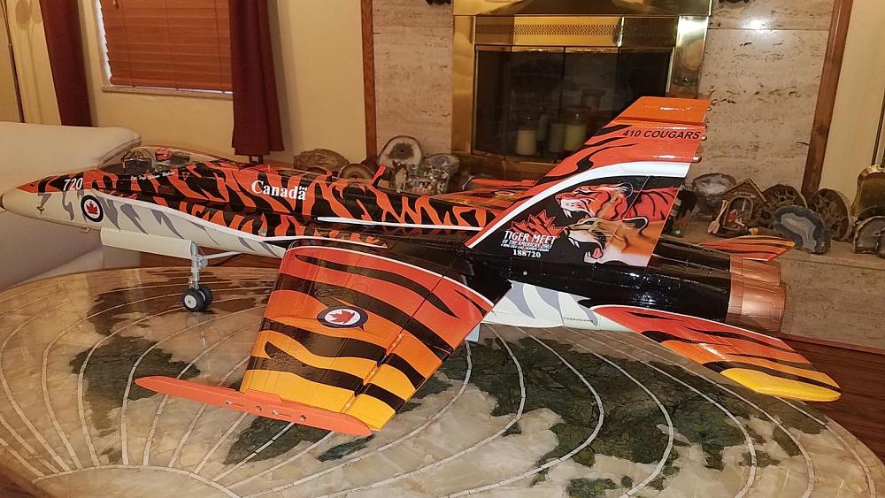

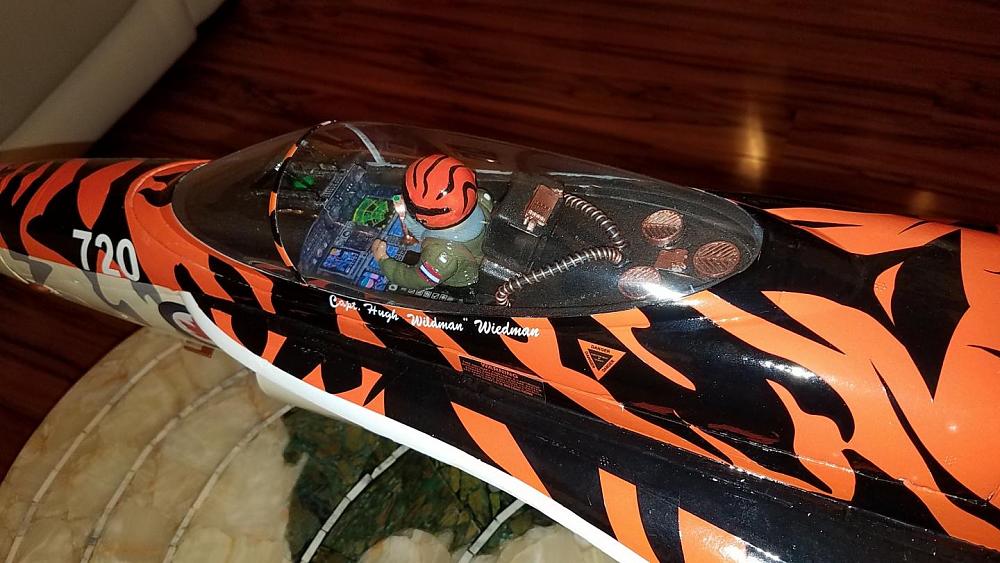

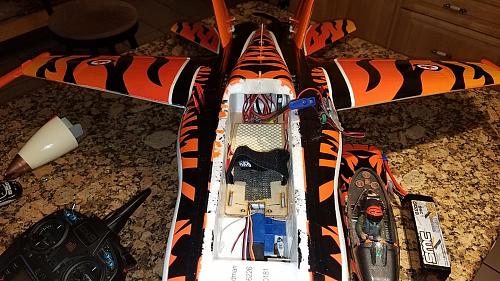

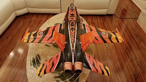

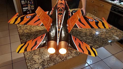

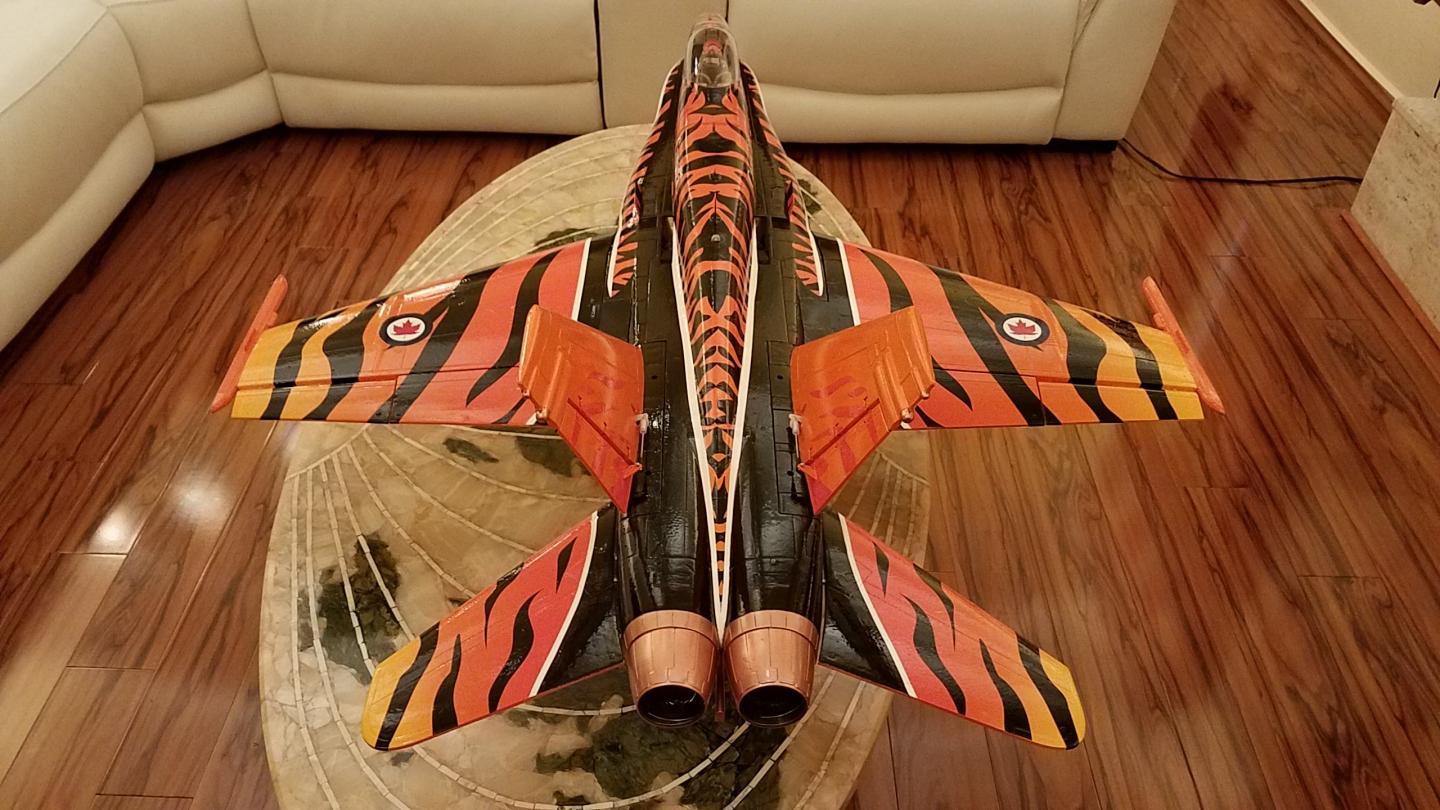

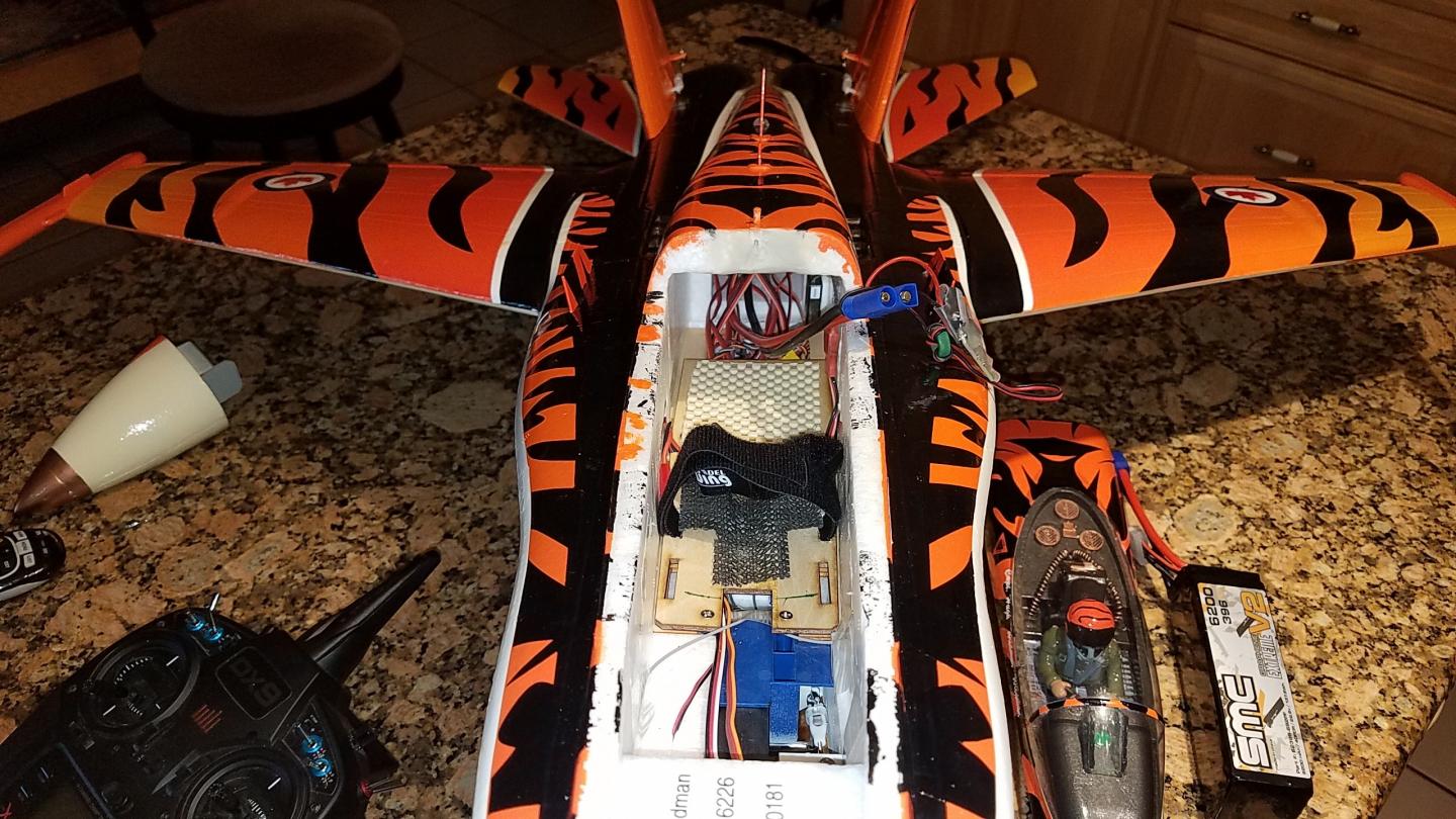

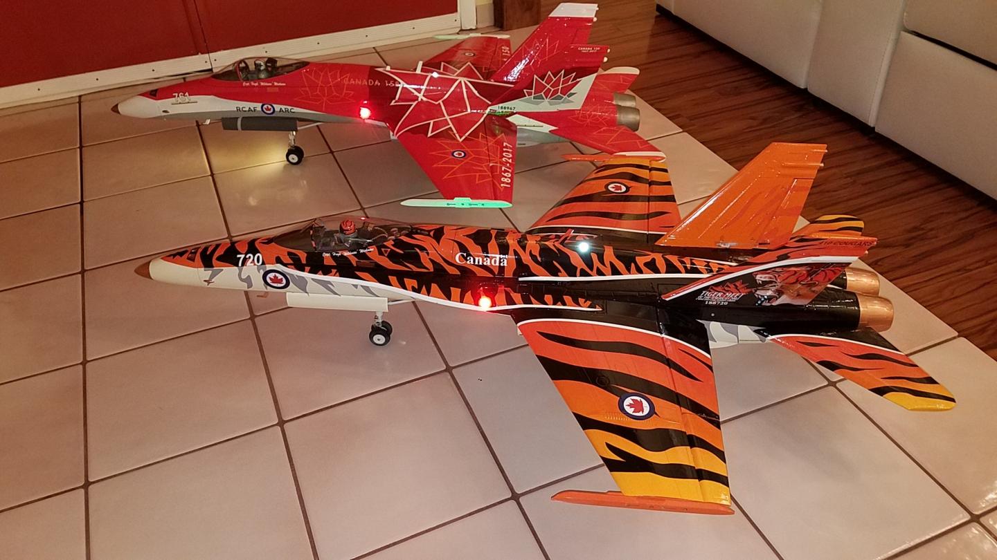

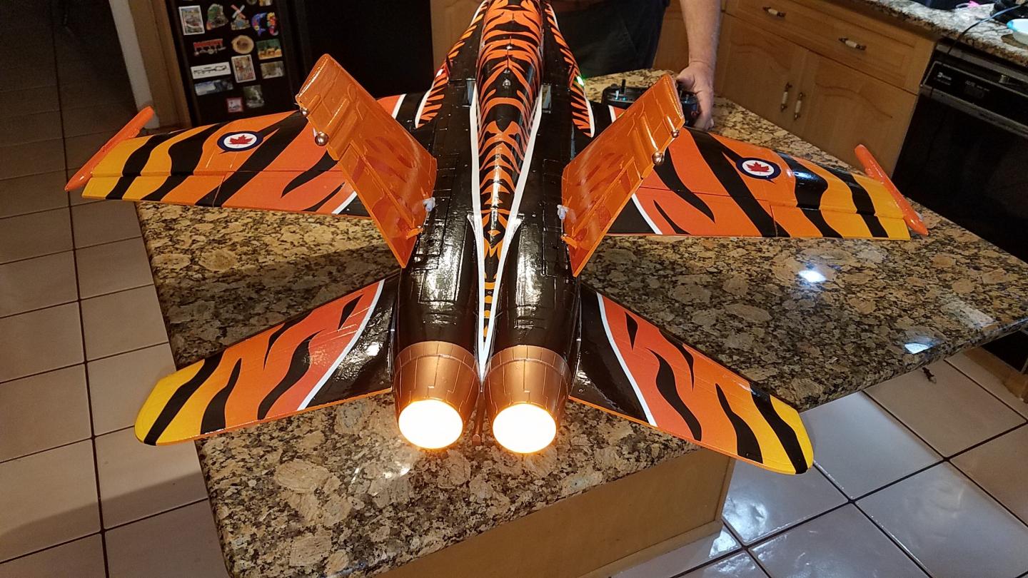

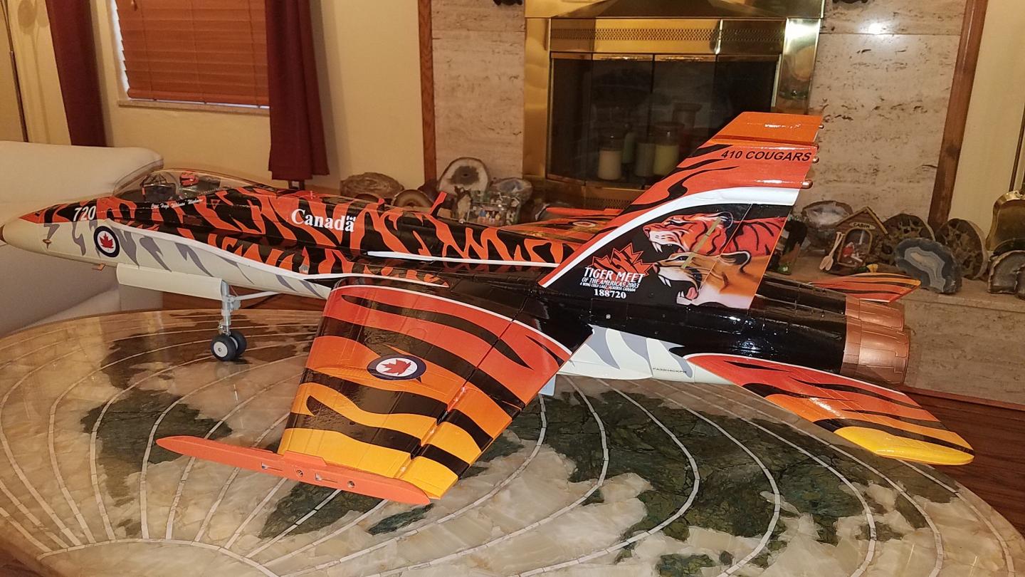

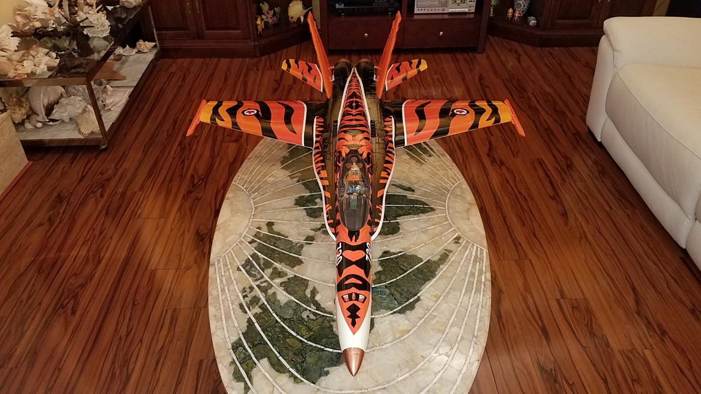

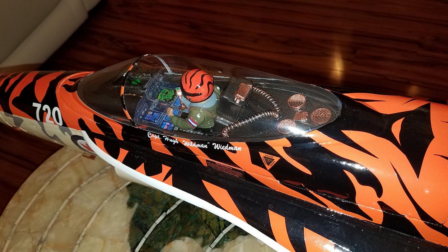

                      The wait is over, cloudy and rainy outside so had to take some indoor photos, definitely not filmed in it's "natural environment". My first Hornet now has a Canadian cousin and they both can speak Canuck-ese with each other, EH? Alpha, she's yours to fly anytime you want.
                      My initial idea was to get a 2nd Hornet, just to fly the snot out of it and use the other Canadian as a show plane, which only has about 35 flights. Then I stumbled across this livery and thought, that should be easy. Turned out to be the most difficult repaint I've ever done (not that I've done a lot). Had to get the different orange shading using nothing but different Rustoleum spray paints (hey, no air brush for me, OLD school). It was a challenge but finally figured it out. Then went to work on the white stripes, black stripes and the rest. Turned out Callie's graphics not up to her usual excellence and most were either too large, too small and not enough (ended up using 2 sheets and a lot of hand painting and Callie had to resize the vertical stabilizer graphics). I'm guessing I'm the first one trying to use her graphics, but ended up doing most on my own. Seems there are a lot of really smart people out there who avoided this one, and one really dumb guy! :dizzy_face: The other Canadian graphics were spot on, so really can't fault her. Ended up doing my own version of a 2D cockpit as the 3D cockpit I did on the first was fabulous (thanks to Elbee ), just kind of a bear and added an extra 4 1/2 ounces to the nose (making balancing at 110mm tough). This one only weighed in for an extra 1 1/4 ounces (and no, the pilot does not play for the Cincinnati Bengals on Sunday). Did a few upgrades as well:
                      • 12 Blade Inrunner :muscle:
                      • "Revised" 2D cockpit and new pilot (not the midget it comes with)
                      • Carbon Fiber tube reinforcement on nose gear support bar
                      • All electronics and wires "below" deck (making for a nice clean battery bay area-thanks to many who showed pictures of theirs and suggested putting everything under the battery tray)
                      • Bypassed BB and wired Ailerons/Flaps/Elevators directly into the AR637T with gyro and satellite (had flap trouble with the first and doing the same, including changing a "chattering" elevator servo)
                      • RC Geek Twin After Burners and nozzles lined with aluminum foil A/C tape
                      • 4 coats of Clear Gloss exterior water based Spar Urethane on everything
                      Next up is the maiden, but now I'm just :poop: my pants thinking of it flying off into the Everglades to join the Panthers out there! Maybe Brinka will do me the favor of his 5000+ F-18 flights and maiden this as well, why not, he maidened my other Canadian. Or I'll take a trip to Spain and get the Post Stall Svengali Airguardian to maiden it. But then the jet would refuse to fly for me, kind of like dating Victoria Secret Models all your life and then having to date one of the current crop of women (are they from the local women's prison or maybe they're actually men). Anyway, got my application in to VS to be one of their new thong models and I'm thinking I got a pretty good shot!
                      Now I can turn my attention to setting up the electronics/upgrades on the Mig and the good news is the repaint is also complete for that, wow, what a busy month, thankfully the weather sucked for most of it and kept me from flying instead!
                      Click image for larger version  Name:	20210701_175333.jpg Views:	0 Size:	148.1 KB ID:	317357Click image for larger version  Name:	20210701_170552.jpg Views:	0 Size:	215.9 KB ID:	317358Click image for larger version  Name:	20210701_181636.jpg Views:	0 Size:	182.3 KB ID:	317359Click image for larger version  Name:	20210701_181208.jpg Views:	0 Size:	173.5 KB ID:	317360Click image for larger version  Name:	20210701_181429.jpg Views:	0 Size:	196.4 KB ID:	317361Click image for larger version  Name:	20210701_172356.jpg Views:	0 Size:	214.6 KB ID:	317362Click image for larger version  Name:	20210701_181243.jpg Views:	0 Size:	154.9 KB ID:	317378Click image for larger version  Name:	20210701_181932.jpg Views:	0 Size:	157.7 KB ID:	317363

                        Excellent work!
                        • SanExup
                          • 912
                          • Western Wy.
                          #5012
                          Yeah Hugh, what Evan said, Excellent work!
                            • 4873
                            #5013
                            Hugh, Very nicely done, just outstanding. Bravo Zulu, Sir.Best, LB
                              #5014
                              Simply outstanding Hugh Wiedman !!! WOW!
                                          Now, that's an amazing paintjob you made right there, great stuff Hugh!
                                          HAHAHAHAHAHAHAHAHAHAHA!
                                          Post Stall Svengali, now that put a smile on my face... from now on it will be right under my avatar, see what you did!
