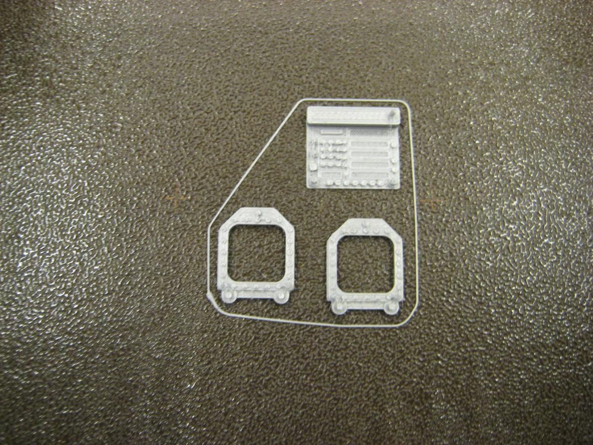

      Just so you know I'm not slacking off this weekend, I have been building component parts for the 3DP Cockpit. Fun, though slow goin'. Best, LB

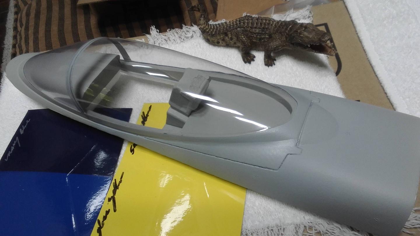

        VeryNice... And it's going in a Jet with a Clear Canopy so it can actually be seen !!! Bonus !! I've got plans for raising this Canopy along the New Line I've got going here. A Seat and Pilot are also in the works. I may be molding up a Canopy for this one also. ExcitingStuff

            Yes LB, the CenterlineStation will need a Tank on this one. Proper WingTip Missile Rails and Wing Pylons all around are also a must. If you can get that Cockpit Stuff done, along with an operating 'Canopy', a Feller can grind out a pretty decent model with this one. SpeedBrake is also on the list. My Seat/Pilot guy is slowly working on those details too. Cheers !!

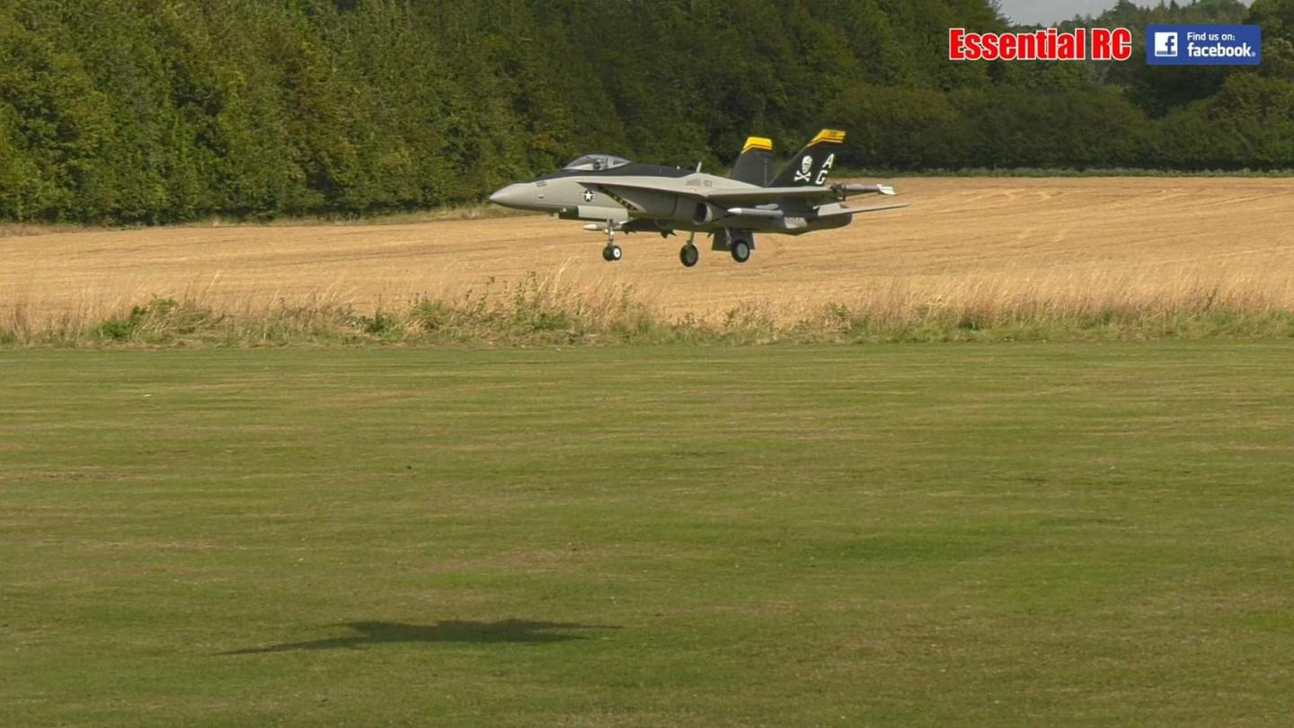

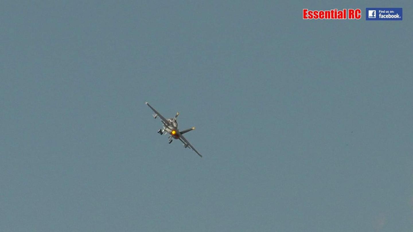

                            Couple of stills from today. Video coming soon. Remembered to connect up my rc geek centre burner today. Looks fantastic. Although the angle of this particular shot makes it look like I've had a flame out on engine no.2 lol. Guess that could be an argument to have the dual light burner but I like the more orange natural flame colour of the rc geek one and seeing it flicker into life. And I guess because of the angle of the ducting you would still only see one side at a time anyway depending on angle. Think the orange light is more visible than the yellow light of the light burner too. But I'm happy with both. Got the light burner in my Avanti and the centre burner in this.
