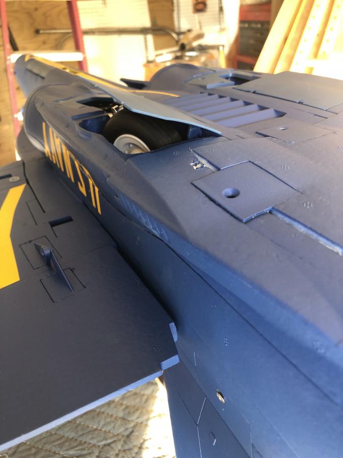

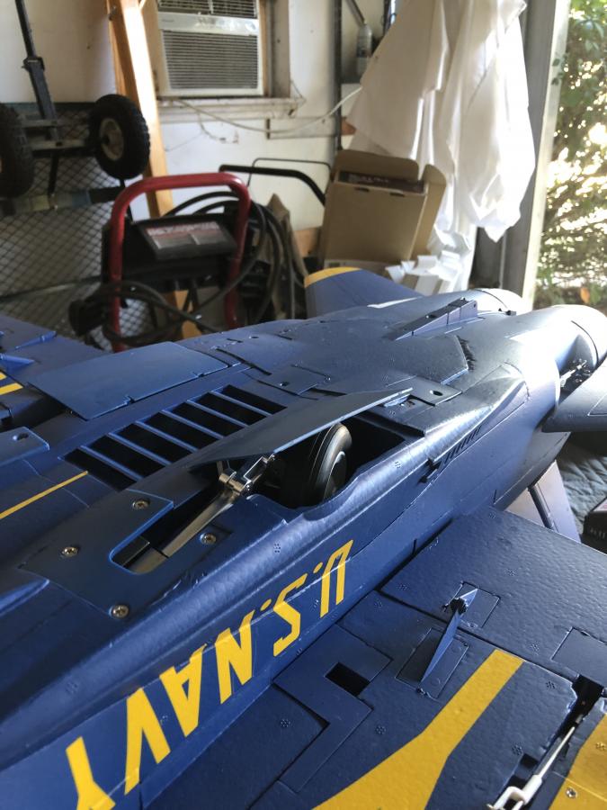

                      Tried to finish mine up today for a sunday maiden. All is fine except one main gear won't completely close. The door is open about 30%. Verified that the door is not preventing the retract from closing. I have cycled it several times as well as loosened the strut and changed pivot angle both ways, but still no change. Is there a procedure to reclock/calibrate the retract end points? I believe another retract unit will be needed to fix this issue and am considering flying with (original gear) in the down and locked position until I can obtain parts necessary to fix this.
